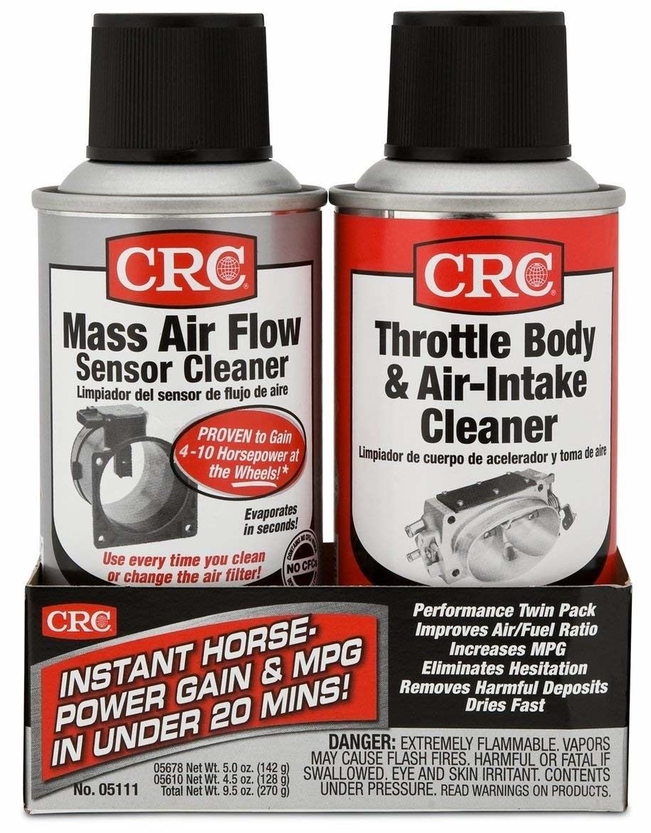

SubeeTed Posted November 21, 2018 Author Share Posted November 21, 2018 Just bought this CRC kit off of Feebay. I'll clean re-oil K&N , then run car a bit and clean MAF and then Throttle body . Link to comment Share on other sites More sharing options...
GeneralDisorder Posted November 21, 2018 Share Posted November 21, 2018 (edited) Just use brake cleaner. It's cheaper. Same thing basically. AND GET RID OF THE STUPID K&N! Worst idea ever on a MAF car. MAF sensors are much too expensive to be damaging then with cheeeeesy K&N filter oil. They don't even filter that well. Especially when they have relatively little oil in them to "save" the sensors. Completely stupid. The synthetic paper element panel filters from like Cosworth, and others are what you want. They cost about the same and you can blow them out and reuse them for like 100k miles easily. Unfortunately Amsoil discontinued their dry panel filters due to poor sales. GD Edited November 21, 2018 by GeneralDisorder Link to comment Share on other sites More sharing options...
