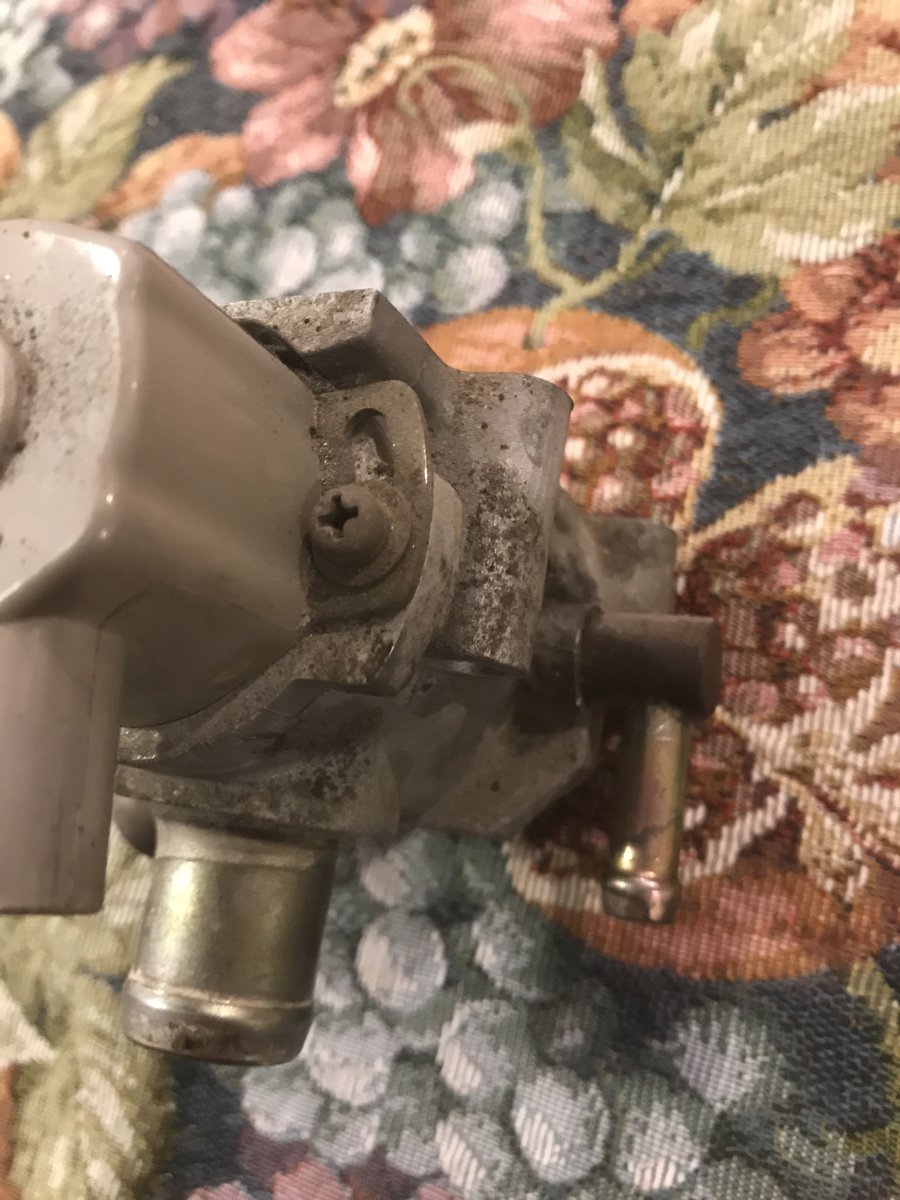

Here is an update on the car. Since last Thursday there have been only intermittent problems with the car. I did spray MAF cleaner on the sensor but it already looked clean. Also since then the CEL has been off, but it was never on for the MAF sensor.  It did come on from time to time for the Idle Air Control Valve. We bought a used Idle Air Control on eBay for $80 and I just installed it now. I took the car for a test drive and did not notice any problems.
The old Idle Air Control Valve was part 22650 AA033 and the Subaru dealer told the updated part number is 22650 AA034 so I got that one.
It looks like top part can be turned to make adjustments. Does anyone know anything about that? There are two little screws one can loosen like on the Throttle Position Sensor. I’ve attached a picture.
Remove and clean the throttle body. Idle issues are more often a result of the idle control being driven to its limits by a throttle body that is inconsistent, dirty, and isn't contributing consistent airflow at idle. Causing the computer to send max idle pulse widths, etc and it is unable to compensate for changing idle loads when it's already at it's limit.

I did clean the Throttle body a few months ago, but did not remove it.
You didn't mention that you had gotten the idle control valve sensor code!  Of course when you get that code, it's a no brainer to replace it.  I had that failure on a 97 where it would hesitate and nearly stall in traffic. Yes, the adjustment is critical.  It doesn't require the use of the "subaru select monitor" but it did require sticking pins through the wires of the sensor so that the voltage could be measured.  Use the search engine to find the procedure.
And cleaning the throttle body in place isn't totally effective as SSI implied.  Maybe it would work and maybe not. You can't be sure. But if you got the code, then fix the ICV sensor.
Thanks! I’ll see about finding the instructions on adjusting the Idle Air Control Valve. My daughter reported last night the car hasn’t misbehaved since I replaced the Idle Air Control Valve. The car runs normally. What happens by not checking to see if the voltage is correct? Maybe just not get optimum performance from the engine?
