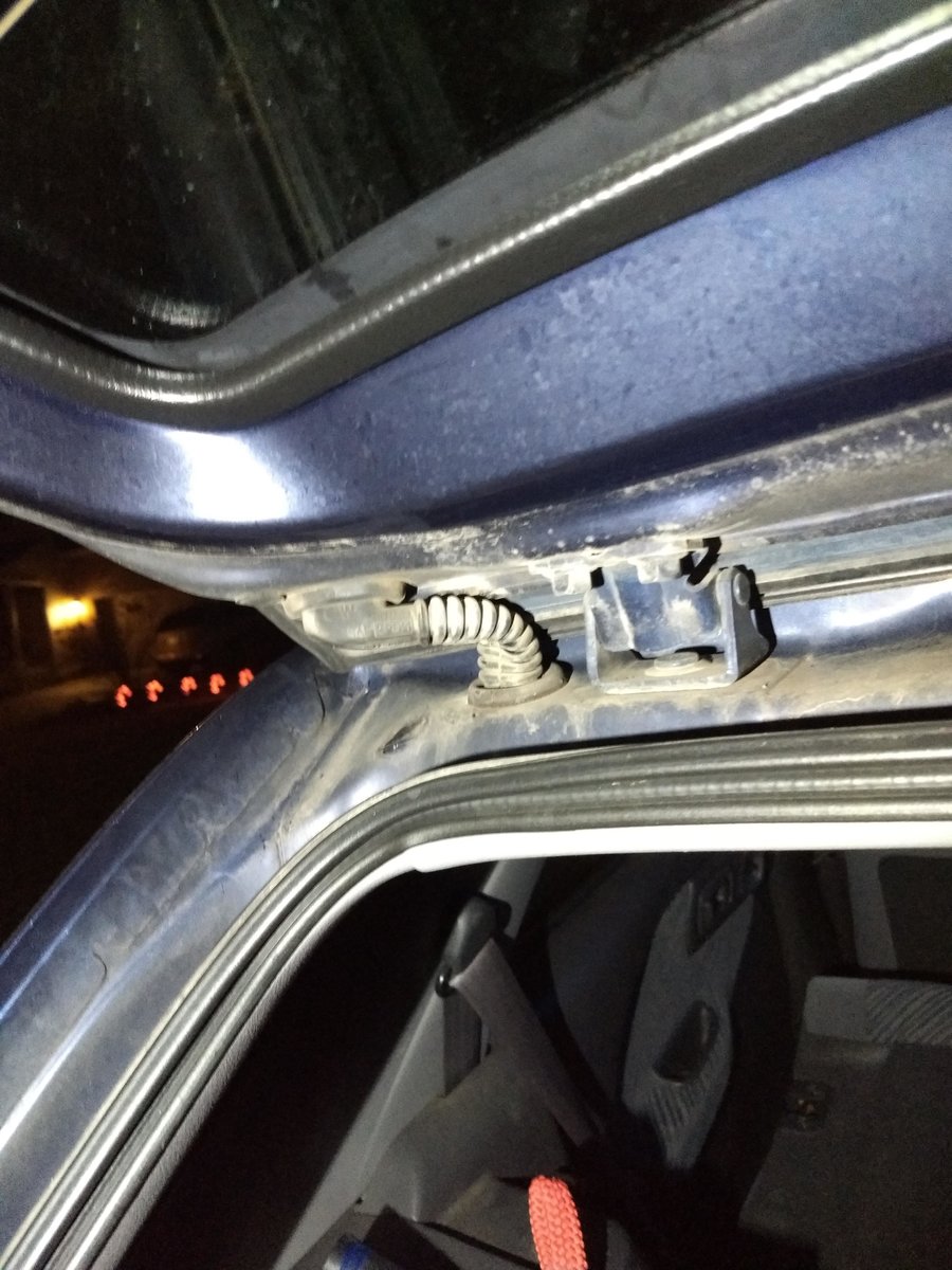

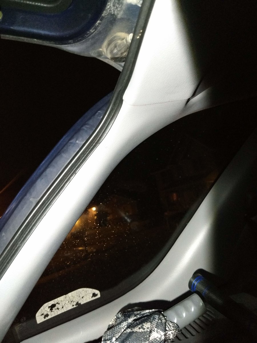

navyhoosier Posted December 21, 2018 Share Posted December 21, 2018 So, I put in some fluid and it apparently pumped, but was leaking somewhere up at the top of the rear opening. I would assume I start taking off trim to get into all of this? Any tips? Am I right that it goes from the reservoir up to the flexible connector and then down to the bracket that holds the rear wiper? It appears my leak is just before it gets to the flexible connector Link to comment Share on other sites More sharing options...

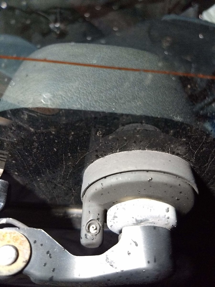

navyhoosier Posted December 21, 2018 Author Share Posted December 21, 2018 This shows the area there was dripping. Am I correct that the other picture is of the spray nozzle? Thanks in advance for any tips on how to sort through this and find the leak NH Link to comment Share on other sites More sharing options...
lmdew Posted December 21, 2018 Share Posted December 21, 2018 Yes, it runs up the Drivers side of the rear body side of the hatch, then towards the flex hose you see. Best thing you can do is get it into a warm space before you pull the plastic. If the interior is up above 70F and you give the interior plastic time to warm up it will be less likely to break off the clip tabs. If you have access to a self serve parts yard go pull the panels there first so you know how it all comes apart. Then there is the question is it worth it? You could unplug the rear washer pump connector and disable it and never worry about the leak. Link to comment Share on other sites More sharing options...

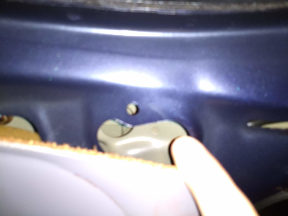

navyhoosier Posted December 31, 2018 Author Share Posted December 31, 2018 So we got the trim off and we have found the body hole that the leak is coming from...and I can't figure out how to get in there or "what next" Link to comment Share on other sites More sharing options...
navyhoosier Posted December 31, 2018 Author Share Posted December 31, 2018 Anyway...I tried to feel up inside the body hole and couldn't feel a hose or anything. Standing by on this end. NH Link to comment Share on other sites More sharing options...
brus brother Posted December 31, 2018 Share Posted December 31, 2018 https://www.subaruoutback.org/forums/111-gen-1-1995-1999/43409-odd-rear-window-washer-problem.html you may find helpful diagrams or suggestions in this link or the other redirect links within Link to comment Share on other sites More sharing options...

lmdew Posted January 23, 2019 Share Posted January 23, 2019 I replaced my 2000 rear hatch with a 97 hatch this last weekend. Both washer tubes were cracked just below the flex connector between the body and the hatch. Easy fix. Get new hose or go to the yard and pull one. Cut an extra foot off the lower end, which you can reach inside the Jack access panel in the rear. It goes to clear plastic hosing there. Take your new longer tube and attach it to the old cracked tube and pull it down through the body. Connect it in the jack access panel. Put the flex boot back in place. Done Link to comment Share on other sites More sharing options...
navyhoosier Posted January 23, 2019 Author Share Posted January 23, 2019 Awesome info. I haven't messed with this any further yet. Was the flex boot hard to take off or any tricks? Did you get generic hose at the autoparts Thanks NH Link to comment Share on other sites More sharing options...
lmdew Posted January 23, 2019 Share Posted January 23, 2019 The boot comes off easily it's just on there like a rubber grommet. I little lip of the boot is on both sides of the sheet metal of the car body. Just push it in a little and pull. I used hose off the junk yard car. I only found about 2" hardened trimming it back and it seemed like new. If you use the old hose to pull it through you will not have to remove any interior plastic trim. Sweet. Link to comment Share on other sites More sharing options...
navyhoosier Posted January 23, 2019 Author Share Posted January 23, 2019 Hey..thanks!! I've already taken off some of the interior trim because I was rooting around in there trying to figure out what the heck was going on. How did you go about making the connector at the spray nozzle. I'm assuming you have to take off the interior trim panel and you'll see it. So far I've taken off interior trim hoping to get "eyes on" the leak, only to figure out the hose was inside the frame. Thanks..hope to be able to root around in there again soon. NH Link to comment Share on other sites More sharing options...
lmdew Posted January 23, 2019 Share Posted January 23, 2019 There is a connector right at the top of the hatch to the hose that runs to the spray nozzle. I'd start up there. It's the flex boot on the drivers side. Just reaching down in the jack compartment with you hand you should be able to find the washer hose. It goes from clear plastic to black rubber there. If it's off the sprayer you will have to pull the hatch inside panel. Link to comment Share on other sites More sharing options...
