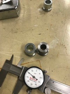

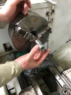

jdmleggy97 Posted January 31, 2019 Author Share Posted January 31, 2019 Rear coilovers are good to go... made new bolt collars on the lathe... Fits like a glove! Link to comment Share on other sites More sharing options...
el_freddo Posted January 31, 2019 Share Posted January 31, 2019 Excuse my ignorance, is that a metal bush replacement for the rubber bush? If so I’ll be keen to know what sort of rear end noises you experience. And have you retained the upper rubber mount on the strut? Cheers Bennie Link to comment Share on other sites More sharing options...
jdmleggy97 Posted February 1, 2019 Author Share Posted February 1, 2019 On 1/31/2019 at 7:12 AM, el_freddo said: Excuse my ignorance, is that a metal bush replacement for the rubber bush? If so I’ll be keen to know what sort of rear end noises you experience. And have you retained the upper rubber mount on the strut? Cheers Bennie Expand The collar is so the bolt sits correctly in the lower strut mount. The newer Gen stuff uses like a 14mm bolt for the lower strut bolt and the L series is a 12MM, so Instead of making a bushing to close the clearance gap in between the collars the coilovers came with and my bolt, I just remade them to suit. The lower still retains the rubber bushing. For the rear top hat/ mount, I could not retain the factory bushing setup and it had to be stripped off. The mounting plate is sitting directly on the coilovers top hat rubber mount. Honestly it fits pretty damn good. Will be checking into solutions if NVH is present when the cars back on its wheels. 1 Link to comment Share on other sites More sharing options...

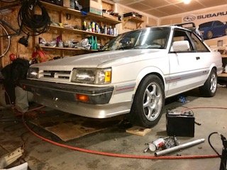

jdmleggy97 Posted February 4, 2019 Author Share Posted February 4, 2019 As of: 3 Feb 19 Car Is fully on suspension, some aesthetic changes have been made. A few final tweaks here and there and locating the right car for the ej swap and paint and I will be all set. I will post future innovations as they are created as well as driving experience. Whos got some RX side skirts!!?? 2 Link to comment Share on other sites More sharing options...
