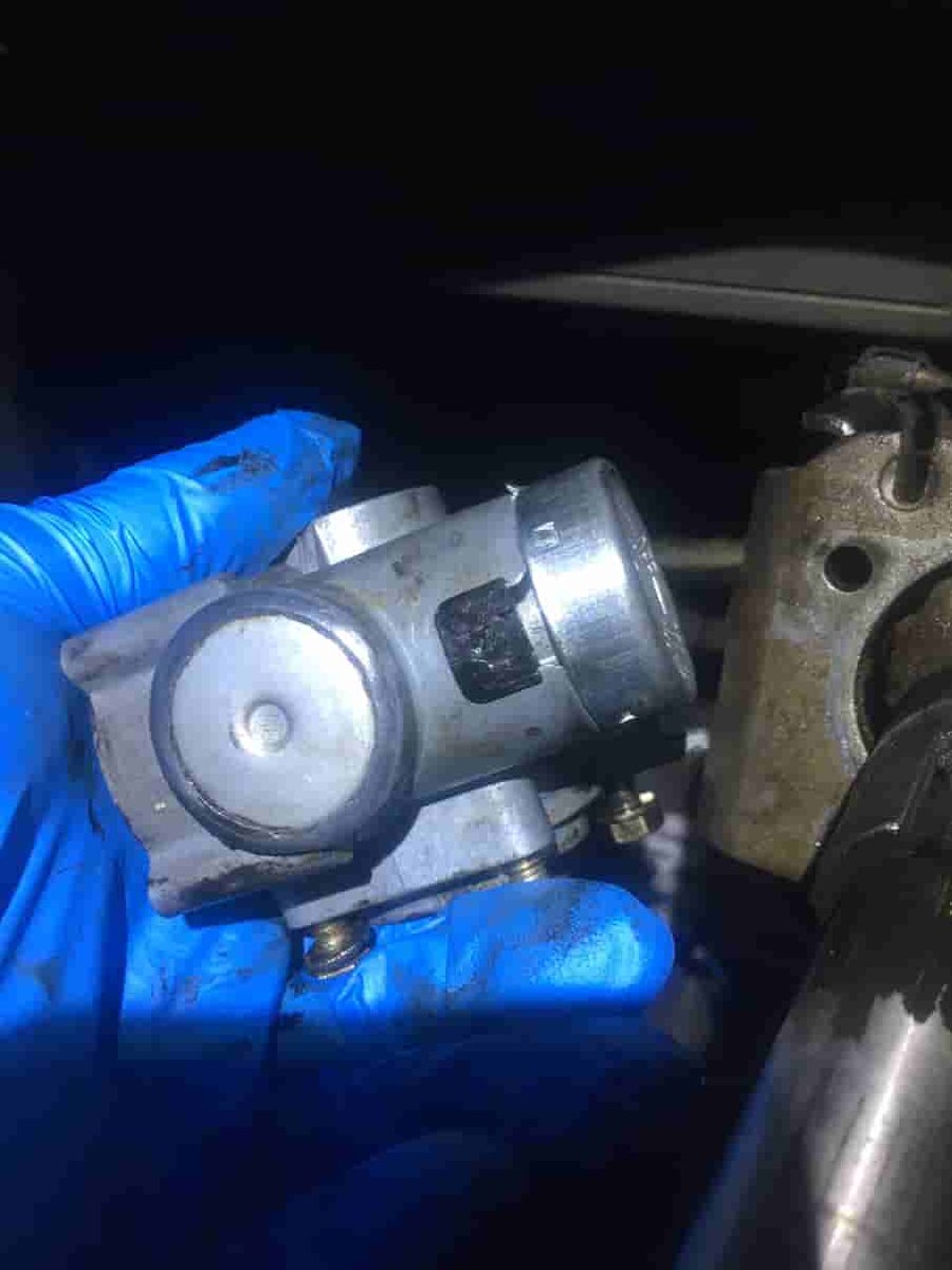

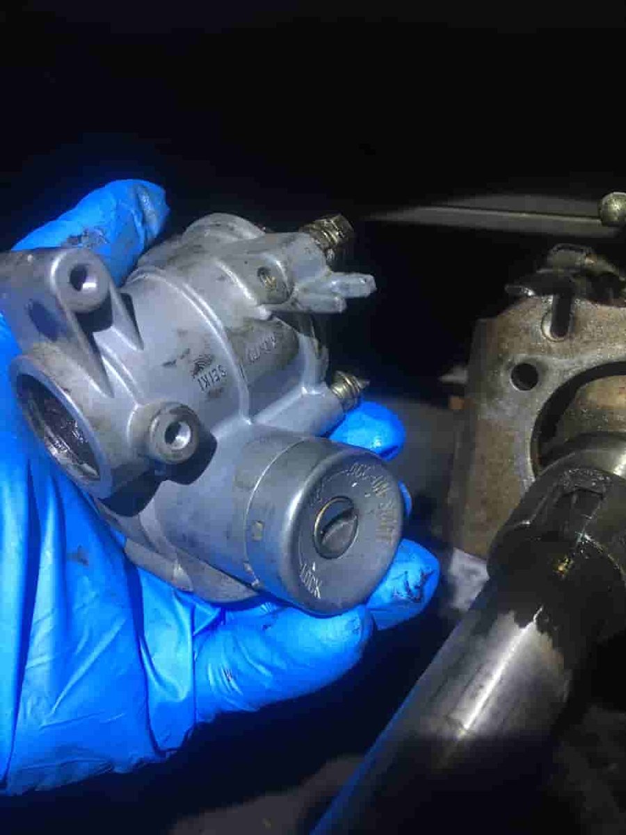

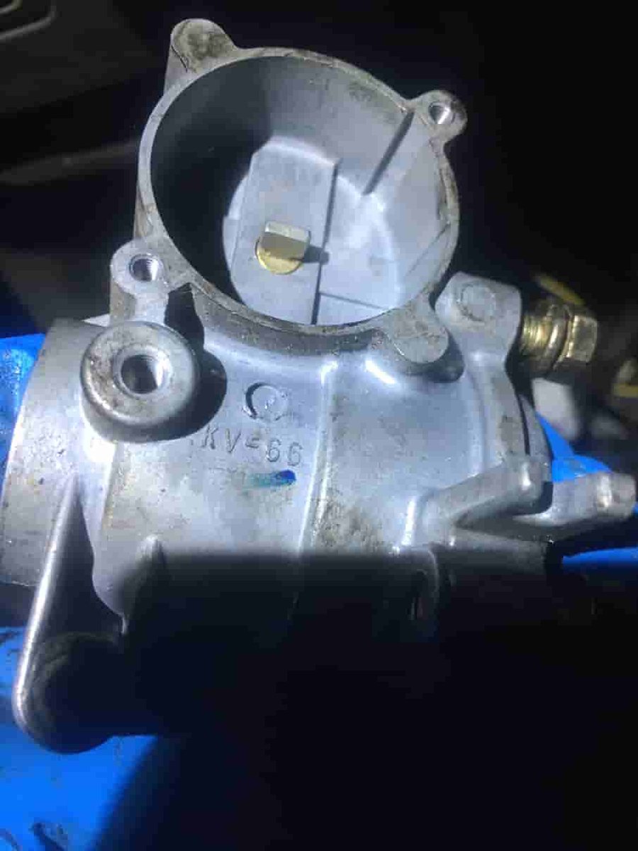

mkoch Posted September 18, 2020 Share Posted September 18, 2020 Heya! Can you rebuild the ignition lock on a 1985 Brat ? I am pretty sure that it is the same mechanism as 1984 gl, and generation 2 s. I have a key which works, but not well. I’d need new keys. I could send the door locks as well. Pictures of the ignition lock. It was quite difficult to remove! Link to comment Share on other sites More sharing options...
