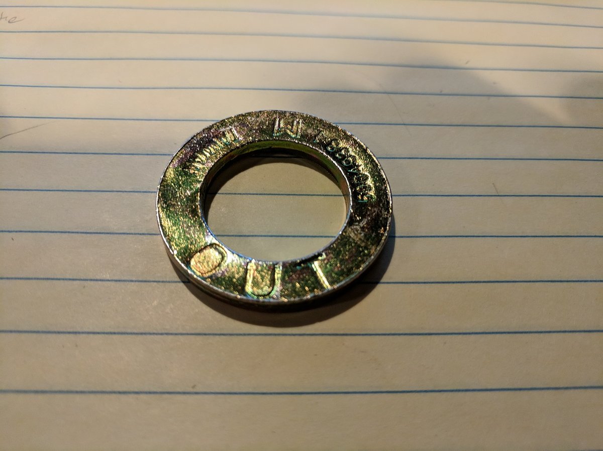

jor2daje Posted January 4, 2019 Share Posted January 4, 2019 (edited) long time reader first post, I've read dozens of posts all saying the concave side of the spring washer should face toward the cone, however just received two dorman spindle nut kits with the washer stamped with "OUT" on the concave side. I plan on installing the "out" side out, but that does seem to fly in face of what I've read here. Thanks for any input. And since it's my first post here's a picture of my bicolor '87 Edited January 4, 2019 by jor2daje 1 Link to comment Share on other sites More sharing options...

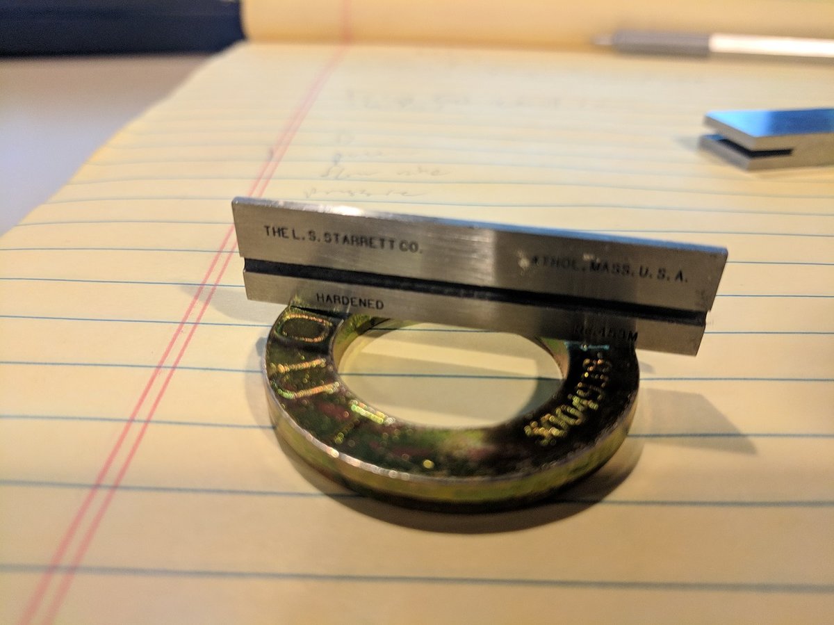

FerGloyale Posted January 5, 2019 Share Posted January 5, 2019 The washers in the pic are incorrectly stamped. The "dome" of the washer should be out. So that when the nut tightens it will be forcing the spring washer down, not compressing intot he already dished side. Just search "spring washer" and read about them in general. They are to be installed whichever direction allows the "spring" to be constant against the pressure of the nut. 1 Link to comment Share on other sites More sharing options...
BEECHBM69 Posted January 5, 2019 Share Posted January 5, 2019 I got a set of those also. They are in fact stamped incorrectly, as mentioned above. Dan 1 Link to comment Share on other sites More sharing options...

czny Posted January 6, 2019 Share Posted January 6, 2019 1 hour ago, jono said: Offshore manufacturing? Where'd you guys buy such rubbish? Those were sold by Dorman under the Motormite label. Notice the outline "M" between TAIWAN & the part number? Not everything Dorman is quality......... Link to comment Share on other sites More sharing options...
