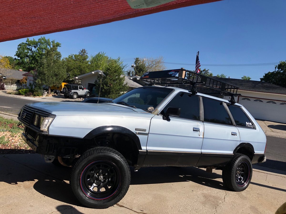

83subaruGLchick Posted May 15, 2019 Author Share Posted May 15, 2019 It’s WORKING!!! I have to iron out some small bugs but overall she’s on the road. Feels so weird driving this thing this high in the air. I get some crazy looks and one guy already yelled at me about how sick it was!!! Pictures to follow Link to comment Share on other sites More sharing options...

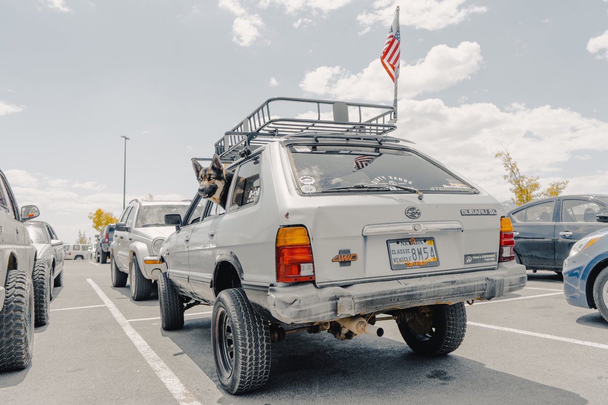

83subaruGLchick Posted May 15, 2019 Author Share Posted May 15, 2019 Pulled her out of the driveway and after the test drive I fully detailed it. She was so dirty from just sitting. Sure does clean up good 2 Link to comment Share on other sites More sharing options...

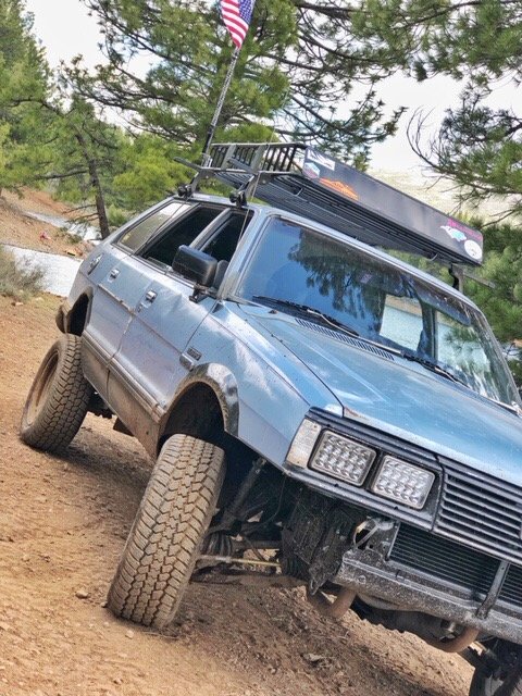

83subaruGLchick Posted May 15, 2019 Author Share Posted May 15, 2019 Didn’t stay clean for long had to fully test it out and take it to one of the lakes where I live. It did great everything seems to be working how it’s supposed to but dang I need to do the engine swap this thing is gutless with the lift even more so than before. Just gotta tough it out and fix the sti first don’t ever own 2 money pits it’s rough lol 2 Link to comment Share on other sites More sharing options...
NV Zeno Posted May 15, 2019 Share Posted May 15, 2019 That's a good lookin wagon! 1 Link to comment Share on other sites More sharing options...

83subaruGLchick Posted May 15, 2019 Author Share Posted May 15, 2019 19 minutes ago, NV Zeno said: That's a good lookin wagon! Thank you I appreciate it Link to comment Share on other sites More sharing options...

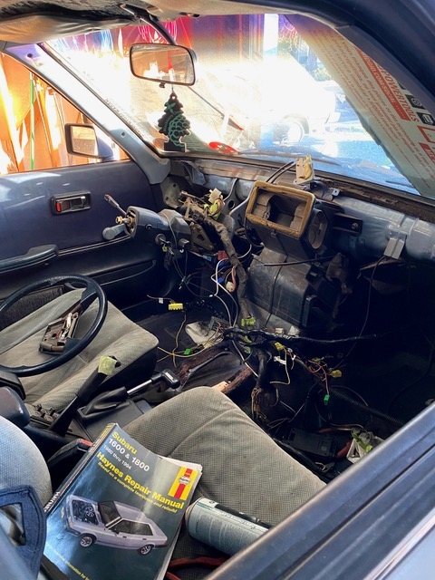

83subaruGLchick Posted May 18, 2019 Author Share Posted May 18, 2019 Link to comment Share on other sites More sharing options...

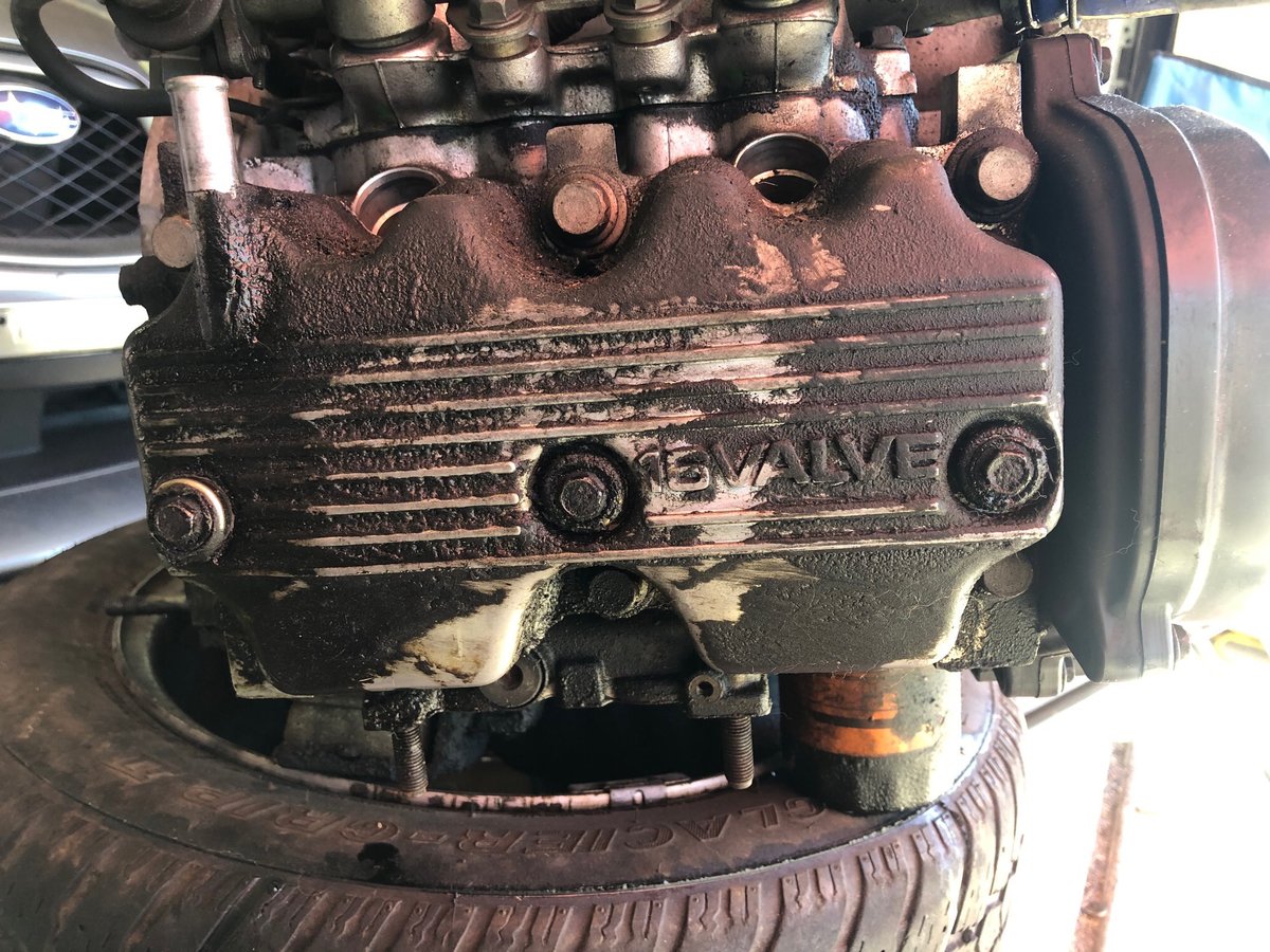

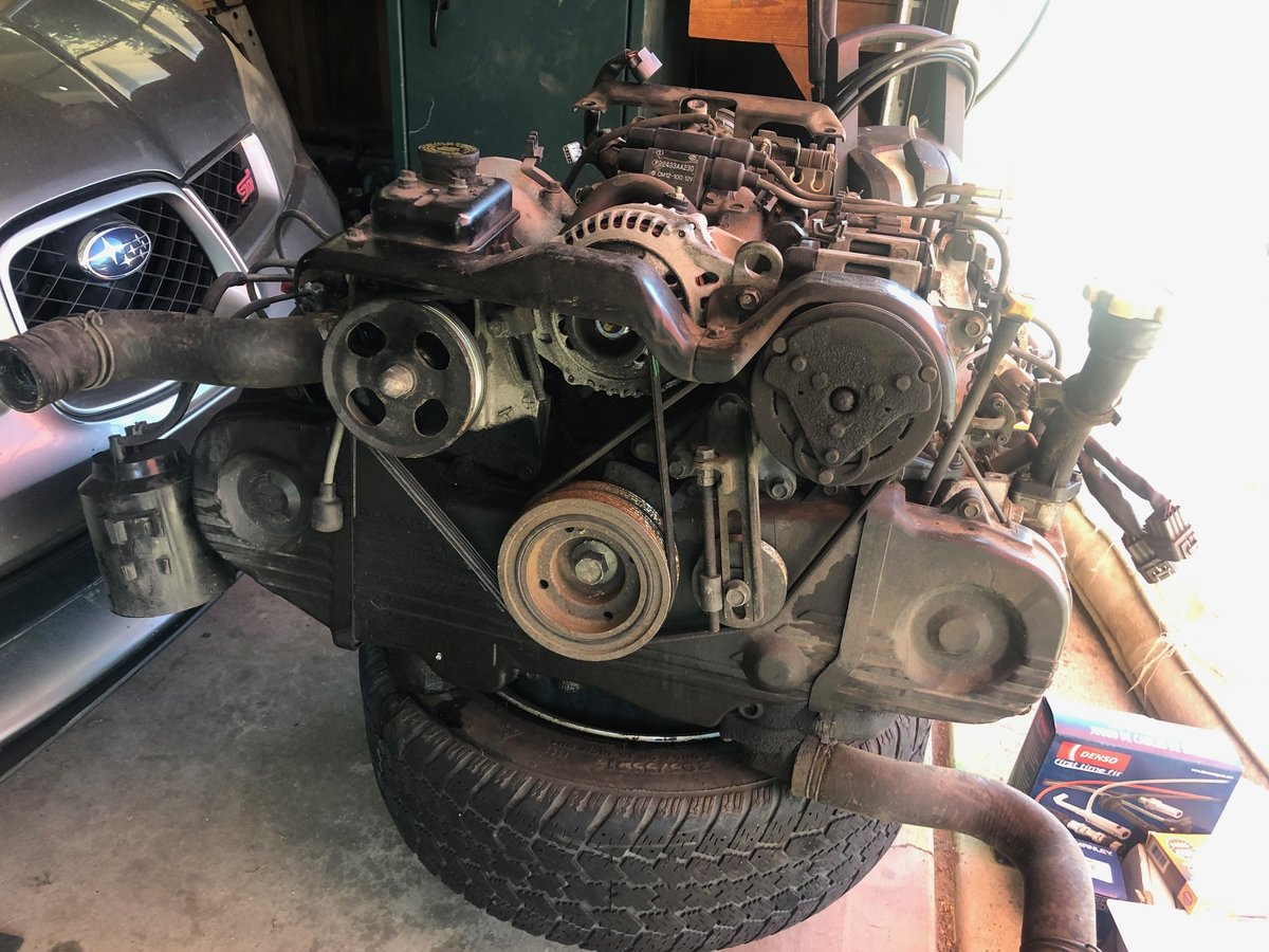

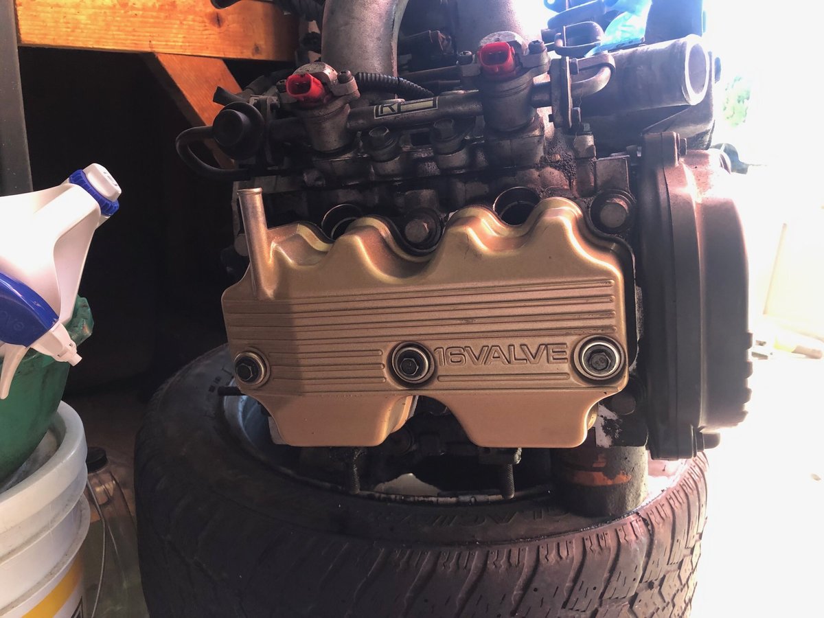

83subaruGLchick Posted June 23, 2019 Author Share Posted June 23, 2019 Started the work on tearing down the donor motor and replacing seals and cleaning it up and it is an engine out of an automatic 1992 Subaru Legacy it’s the EJ222 I always thought if I just take the torque converter off my clutch and all that will just bolt right up. Is this true for these years? Can’t find much info online. Sorry if it’s a dumb questions. Link to comment Share on other sites More sharing options...
alexbuoy Posted June 23, 2019 Share Posted June 23, 2019 4 hours ago, 83subaruGLchick said: Started the work on tearing down the donor motor and replacing seals and cleaning it up and it is an engine out of an automatic 1992 Subaru Legacy it’s the EJ222 I always thought if I just take the torque converter off my clutch and all that will just bolt right up. Is this true for these years? Can’t find much info online. Sorry if it’s a dumb questions. nice!!!! keeping the 4 speed or going 5 speed? Link to comment Share on other sites More sharing options...
el_freddo Posted June 24, 2019 Share Posted June 24, 2019 (edited) Use your MY flywheel. You’ll have to dremel out the mounting holes. OR: have a machine shop fill the current holes and redrill for the EJ crank bolt pattern. I’ve seen it done on the forum before. You’ll also need an adaptor plate. And I hope you got the wiring loom and computer for the engine too. You’ll need that! I know that engine as the EJ22E, could be the same as the EJ222, but I don’t know. What I do know is that it’s an awesome engine and you’ll love it in your beast. Expect gearbox to become a loose gearbag in no time flat... start working on the gearbox replacement now. Cheers Bennie PS: also have a read of this file, it’ll tell you exactly what you need in parts and what you need to do for the conversion http://www.mediafire.com/file/edqqit6xq9tthx6/Numbchux+EJ+to+EA+Swap+Guide.pdf Edited June 24, 2019 by el_freddo Link to comment Share on other sites More sharing options...
83subaruGLchick Posted June 25, 2019 Author Share Posted June 25, 2019 On 6/24/2019 at 4:16 AM, el_freddo said: Use your MY flywheel. You’ll have to dremel out the mounting holes. OR: have a machine shop fill the current holes and redrill for the EJ crank bolt pattern. I’ve seen it done on the forum before. You’ll also need an adaptor plate. And I hope you got the wiring loom and computer for the engine too. You’ll need that! I know that engine as the EJ22E, could be the same as the EJ222, but I don’t know. What I do know is that it’s an awesome engine and you’ll love it in your beast. Expect gearbox to become a loose gearbag in no time flat... start working on the gearbox replacement now. Cheers Bennie PS: also have a read of this file, it’ll tell you exactly what you need in parts and what you need to do for the conversion http://www.mediafire.com/file/edqqit6xq9tthx6/Numbchux+EJ+to+EA+Swap+Guide.pdf I have that guide already, it's been like a bible I have everything I need and I know that is what I have heard, I'm keeping my eyes peeled for a dual range 5 speed trans because I know the 4 speed isn't a permanent solution. I just am wondering I swear all the 5 speed dual ranges I have seen are like a push button vacuum actuated style...do they make the 5 speed dual range thats a lever for 4 hi and lo like the 4 speed? I have the wiring harness and computer sitting in my garage going to send it out to SJR here soon, and the adapter plate is sitting in my garage as well Link to comment Share on other sites More sharing options...
el_freddo Posted June 26, 2019 Share Posted June 26, 2019 There is a dual range 5spd box. They’re most common after mid ‘87 models when it seems the single range was phased out (in Oz they’re super rare and I’ve never seen a series 2 with a single range. It could be different for the US market). Cheers Bennie Link to comment Share on other sites More sharing options...
83subaruGLchick Posted June 30, 2019 Author Share Posted June 30, 2019 Cleaning up the donor motor and doing a tune up. She’s almost ready to pop in just have to order the flywheel. The GL has been my daily these past few weeks and it’s been fun but also really hard on it. That 1.8L is not enough power for that car. I’m hoping the EJ222 makes it a more pleasant daily. Link to comment Share on other sites More sharing options...
