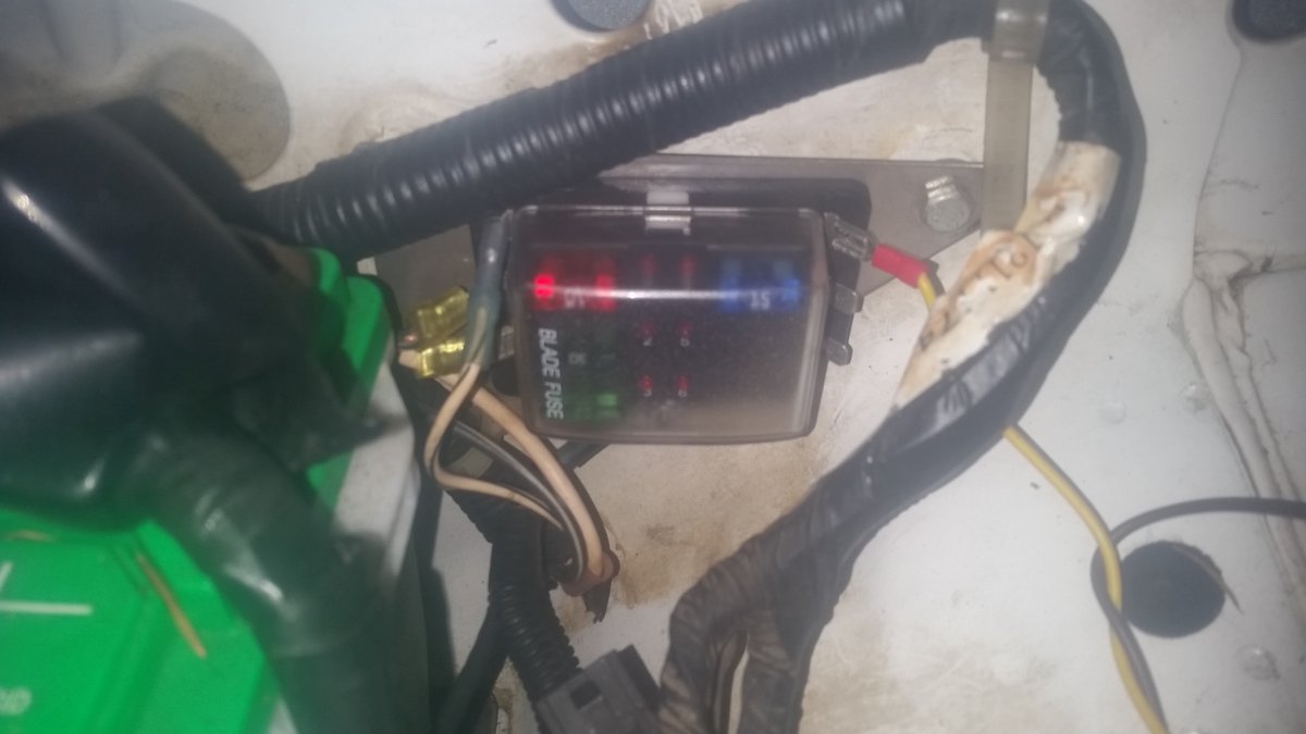

She was getting fuel, no plug wires were loose. (Couldn't verify spark with just myself) After a new more hopeful tried to start to no avail I let her sit for a few minutes and like magic she started right up and ran like nothing was ever wrong. This happened again about 5 minutes later. And several other times, while accelerating, decelerating and even just holding steady at 2k rpm then would just back to life. However on the last time she blew the fuse for the regulator. (When I got it, replaced the fuseable links for a fuse block)

Tell us how why what your "fuse block" is that you replaced the FL's with?
I've cleaned up all that I've seen as far as grounds go, as far my my "fuse block" here's that:
