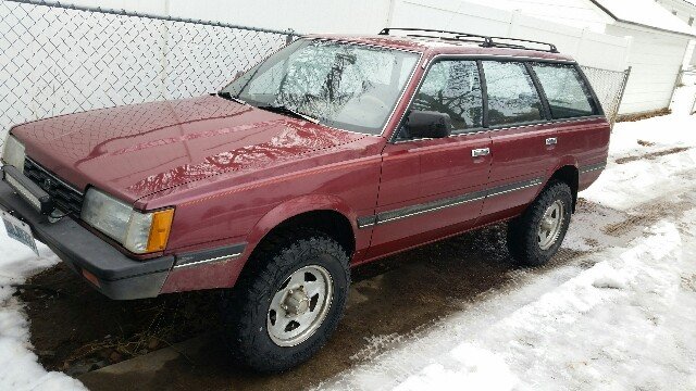

Zeekyal Posted January 26, 2019 Share Posted January 26, 2019 I got this 86 gl wagon for a hunting offroad rig with a 5 speed dual range and 208k miles for just $600 bone stock and running and driving just fine Over the past 4 months I've done tune up and other basic repairs and some upgrades first was 6 lug conversion to get some bigger tires to fish the hunting season then did weber 32/36 and just this past week did my own 2 inch lift with subframe drop and got some brand new 27 8.50 14 achilles desert xmt thing is a beast now love this thing Would post pics but not sure how to get pics on phone to only 2MB Link to comment Share on other sites More sharing options...

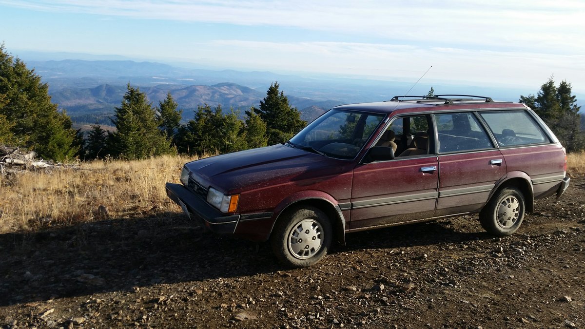

Zeekyal Posted January 29, 2019 Author Share Posted January 29, 2019 The first weekend I bought it up at the top of the mountain I go hunting to now with 6 lug 2" lift and some 27" mt tires 2 Link to comment Share on other sites More sharing options...
