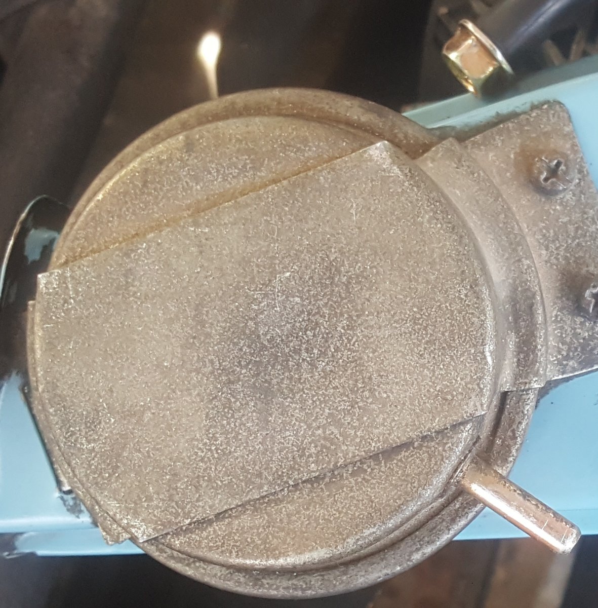

Thanks a lot, your technique worked like a champ I think I was flooding it. I just put in a new air cleaner assy, the hose which I think should connect with the intake flap has a bolt on it, see attached.
