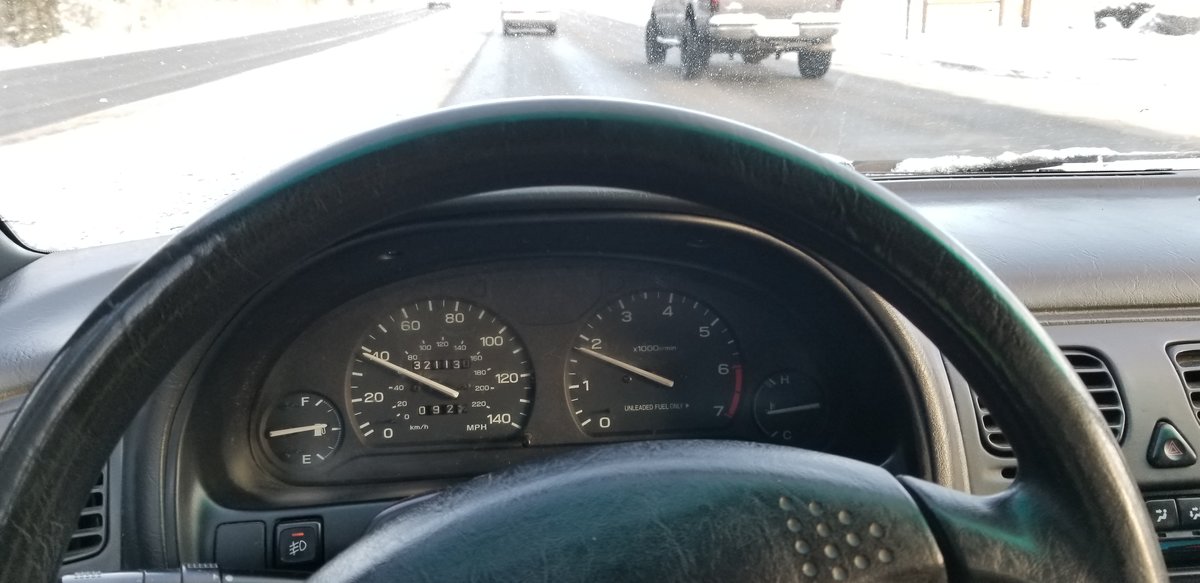

ChemicalSoldier Posted February 5, 2019 Author Share Posted February 5, 2019 Driving it to work currently. Put it up on ramps to burp the coolant system this morning. Temperature gauge keeps going from hot to normal. Back and forth, back and forth. Heat comes on and off Lower Radiator hose is cold Link to comment Share on other sites More sharing options...
db***** Posted February 5, 2019 Share Posted February 5, 2019 On 2/5/2019 at 5:15 PM, ChemicalSoldier said: Driving it to work currently. Put it up on ramps to burp the coolant system this morning. Temperature gauge keeps going from hot to normal. Back and forth, back and forth. Heat comes on and off Lower Radiator hose is cold Expand So you're not getting any coolant to the bottom hose. Thermostat might not be opening or your radiator cap might not be building up enough pressure before opening. I know I've already said this haha, but If you don't have an oem radiator cap and thermostat, get those before anything else. They're cheaper than most other fixes. Link to comment Share on other sites More sharing options...
