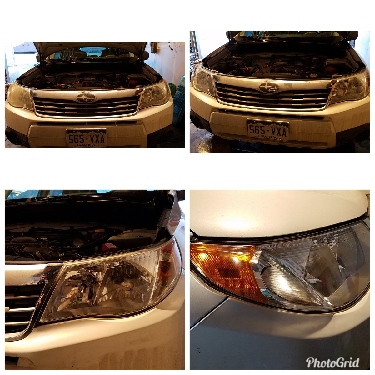

crazyman03 Posted March 9, 2019 Share Posted March 9, 2019 I just did my wife's Headlights with the Maguires Pictured below, the top two show them just polished (1k then 3k sand then polish) the bottom shows with the "sealant" Its not terribly difficult to do, really. Just wet sand <---> with each sand pad/disk evenly. then wash and dry. then apply the polish. The drill bit is for the polishing part - same method. slow and steady then wipe, clean and dry. The sealant (make sure you have gloves on!) just wipes on evenly by wiping across the lens. Took maybe 10 min each light? edit: they give you more than plenty that you can keep the kit for other vehicles. I plan on doing her tail lights as well as the taillights on my car, too. edit: Had to finish it off with a full wash "Abby" Cleans up so nicely! -Justin 1 Link to comment Share on other sites More sharing options...
