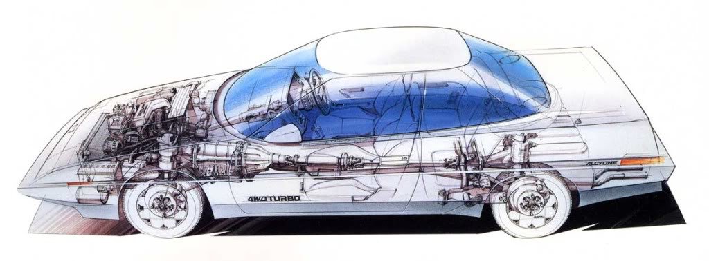

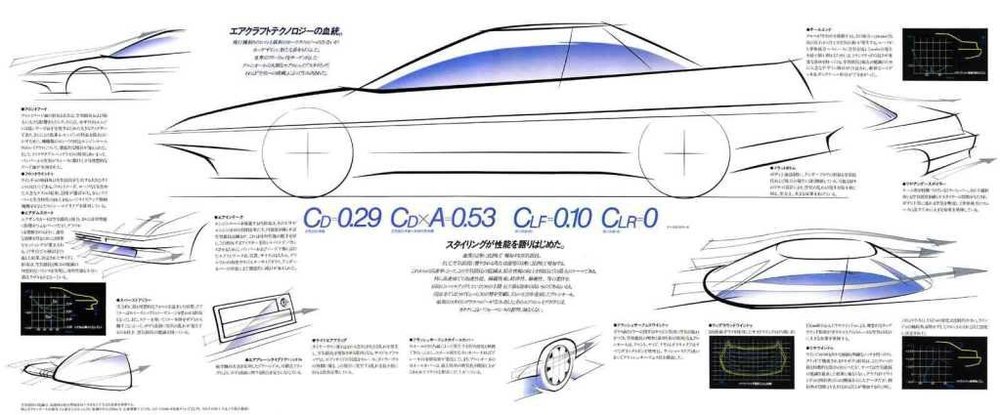

sparkyboy Posted February 19, 2019 Share Posted February 19, 2019 @Giles You try this guy yet? Haha! https://www.ultimatesubaru.org/forum/topic/168553-stash-of-1st-2nd-and-3rd-gen-old-school-parts/ Those engineering drawings are the sh!t huh? I am going to vistaprint a large one, hopefully comes out good, photos do! 1 Link to comment Share on other sites More sharing options...
