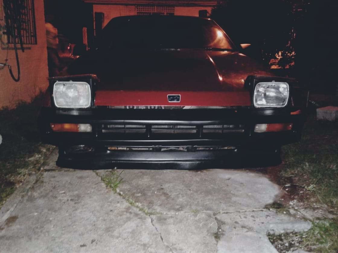

Karmasrenegade97 Posted July 9, 2019 Share Posted July 9, 2019 Hey guys, Working on my first xt6......the car still has the original air suspension....but lord knows where the compressor is and idk what else is missing....its my first time dealing with air suspensions and i need urgent help .......what is the cheapest way to get my ride comfortably enough to drive? Do i swap to coil overs? Do i fit a new air system? Or can i fit other regular struts? Someone please help!!! Link to comment Share on other sites More sharing options...

DaveT Posted July 9, 2019 Share Posted July 9, 2019 Oh, my... Maybe try hooking up a regular compressor, just to air it up, and see if it works at all. The struts / shocks etc are rare as can be, from what I've read. Most people seem to end up installing conventional ones. Even those might be getting hard to find. 1 Link to comment Share on other sites More sharing options...
Karmasrenegade97 Posted July 10, 2019 Share Posted July 10, 2019 On 7/9/2019 at 11:35 PM, DaveT said: Oh, my... Maybe try hooking up a regular compressor, just to air it up, and see if it works at all. The struts / shocks etc are rare as can be, from what I've read. Most people seem to end up installing conventional ones. Even those might be getting hard to find. Expand If i were to look at conventional one...where do i begin to look? like to keep as many options available you know.....have problems finding a radiator too, seems to me everything about this car is rare. Link to comment Share on other sites More sharing options...
DaveT Posted July 10, 2019 Share Posted July 10, 2019 Yes, XTs are rare. Even the "regular cars" of that time frame, which were related - the EA82 powered cars - a lot of parts are going No Longer Available. Both OEM and aftermarket. I don't know enough about XTs to be certain of which parts are interchangeable with the EA82 models I know well, although many are. 1 Link to comment Share on other sites More sharing options...
el_freddo Posted July 10, 2019 Share Posted July 10, 2019 Suspension parts are interchanageble. If your XT is 4wd/AWD, you’ll want the rear struts from a 4wd L series sedan or wagon. Front struts are a direct swap over, as are the rear swing arms and “K” frame, and the front control arms and radius rods. The engine crossmember is turbo specific, but the NA unit can be swapped in and modified for the turbo up pipe. Cheers Bennie 1 1 Link to comment Share on other sites More sharing options...
el_freddo Posted July 10, 2019 Share Posted July 10, 2019 I should add that the rear end is different for 2wd vs 4wd too. The swnig arms have different setups for the bearings - 2wd has a fixed stub axle, 4wd has a rotating stub axle. The K frame has a tab for the rear diff’s front mount with 4wd, the 2wd frame does not This mount can be welded in place and swing arms are interchangeable Cheers Bennie 1 Link to comment Share on other sites More sharing options...
Karmasrenegade97 Posted July 11, 2019 Share Posted July 11, 2019 Ok very informative thanks for all the info.....going to take a look at those after I've fully diagnosed if the air struts/shocks are still in working condition (hopefully they are) and then I'll see where I can go from there!!! Thanks again guys!!! Link to comment Share on other sites More sharing options...
el_freddo Posted July 12, 2019 Share Posted July 12, 2019 As for the air compressor, you might find one in an early legacy that has air suspension, even if it has coil springs - many ppl don’t remove the compressor. And I believe it’s the same unit between the L and the Legacy, maybe with a different mounting plate. It’s in the same location too - front left guard Thinking about it, your air system probably has leaks that lead to the air compressor burning out due to being overworked/worked too long too often. Cheers Bennie 1 Link to comment Share on other sites More sharing options...
