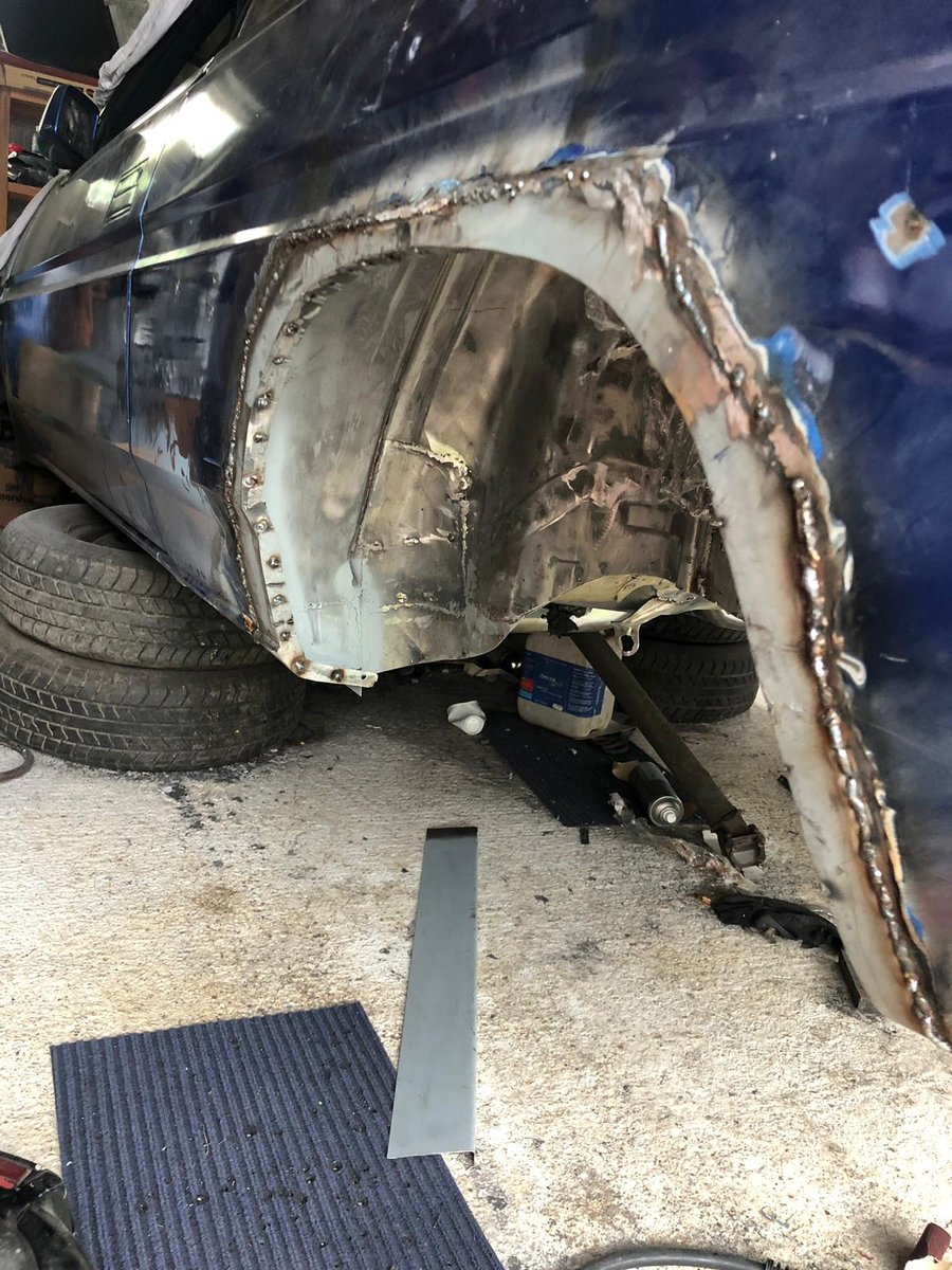

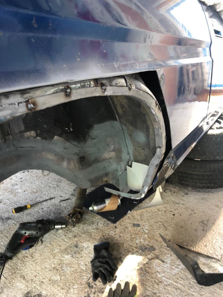

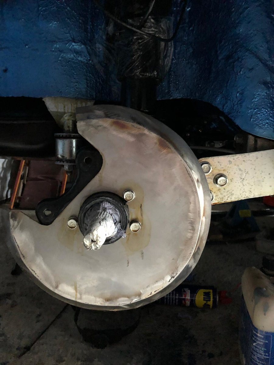

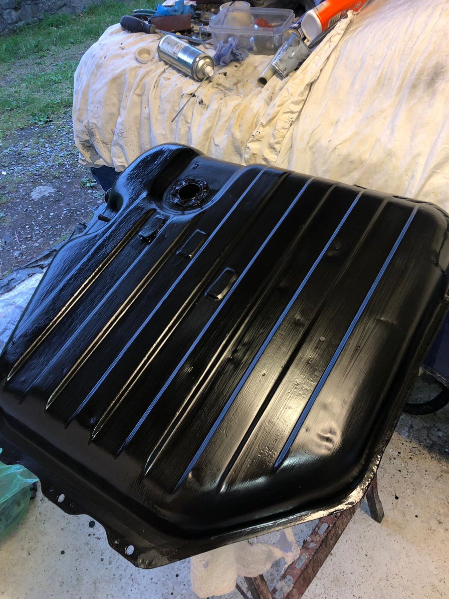

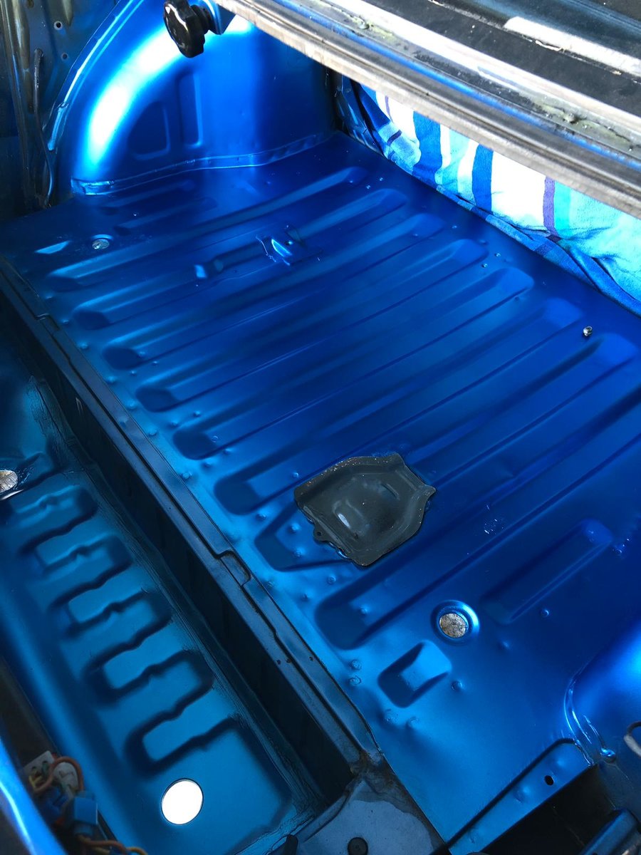

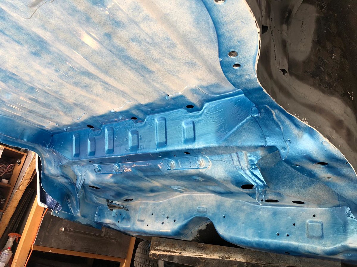

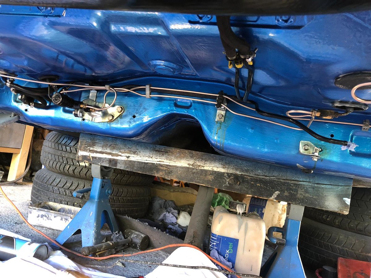

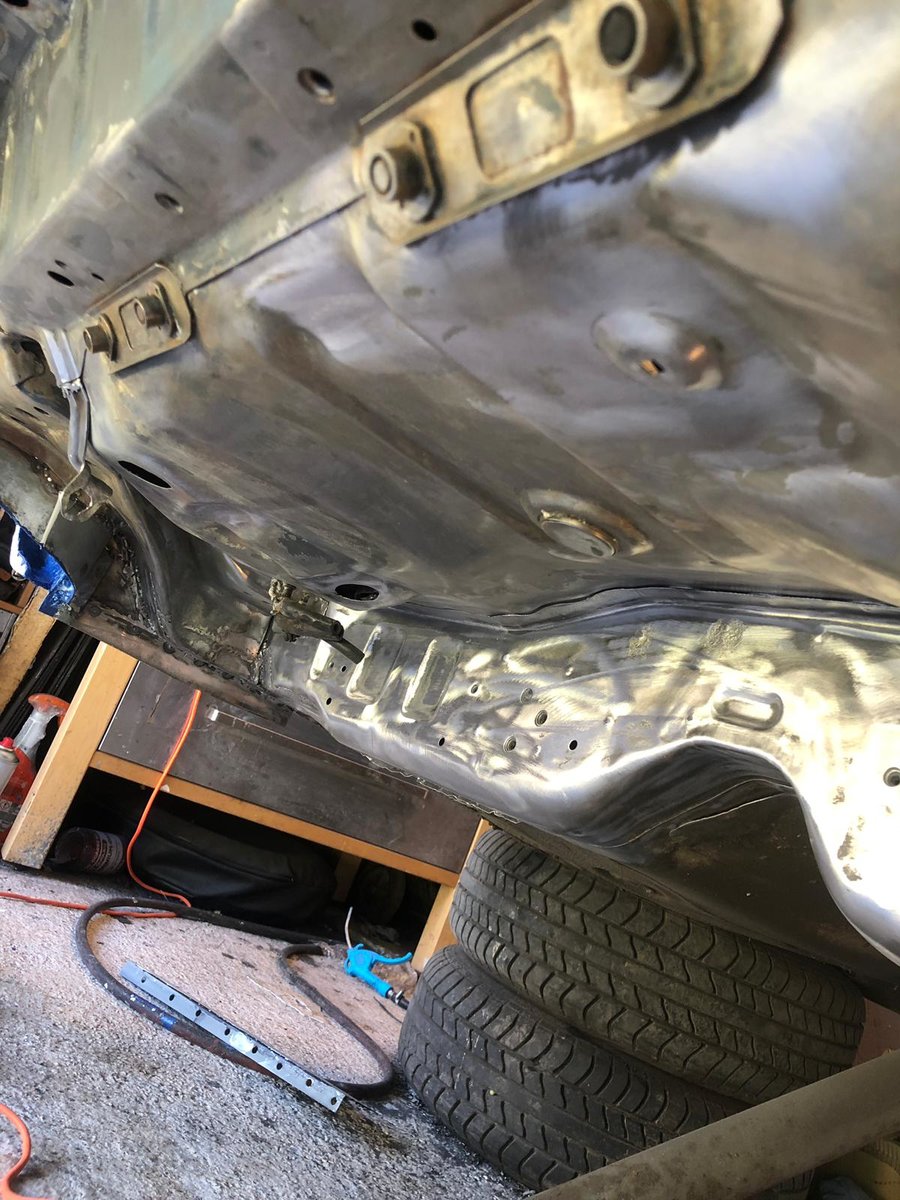

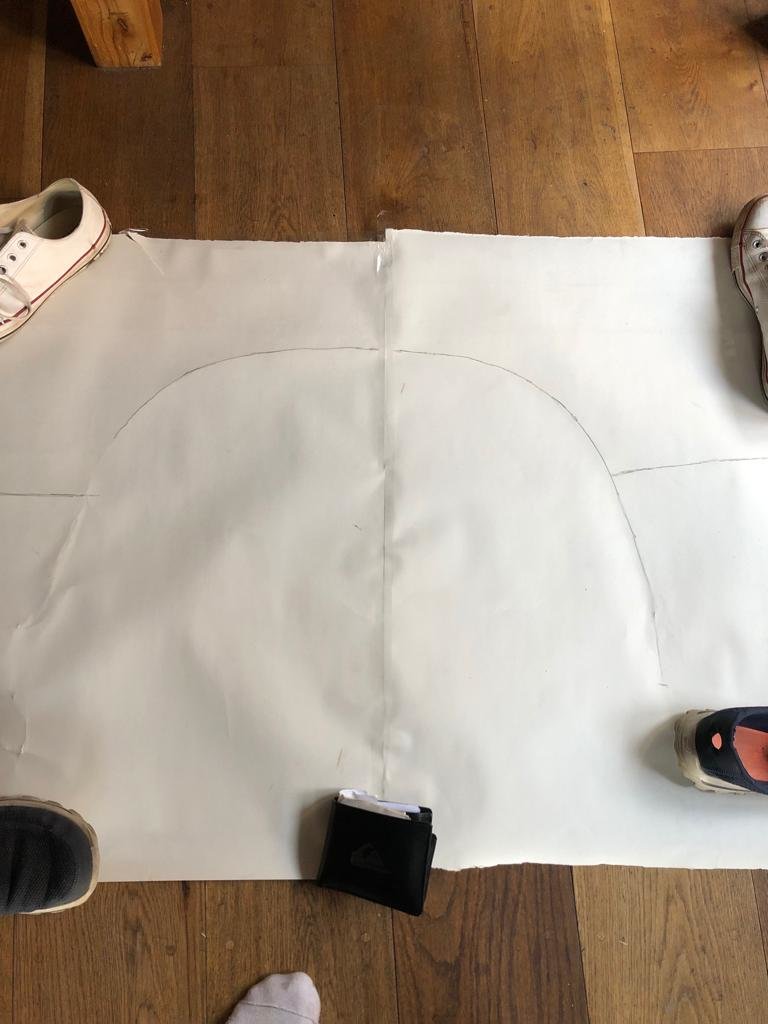

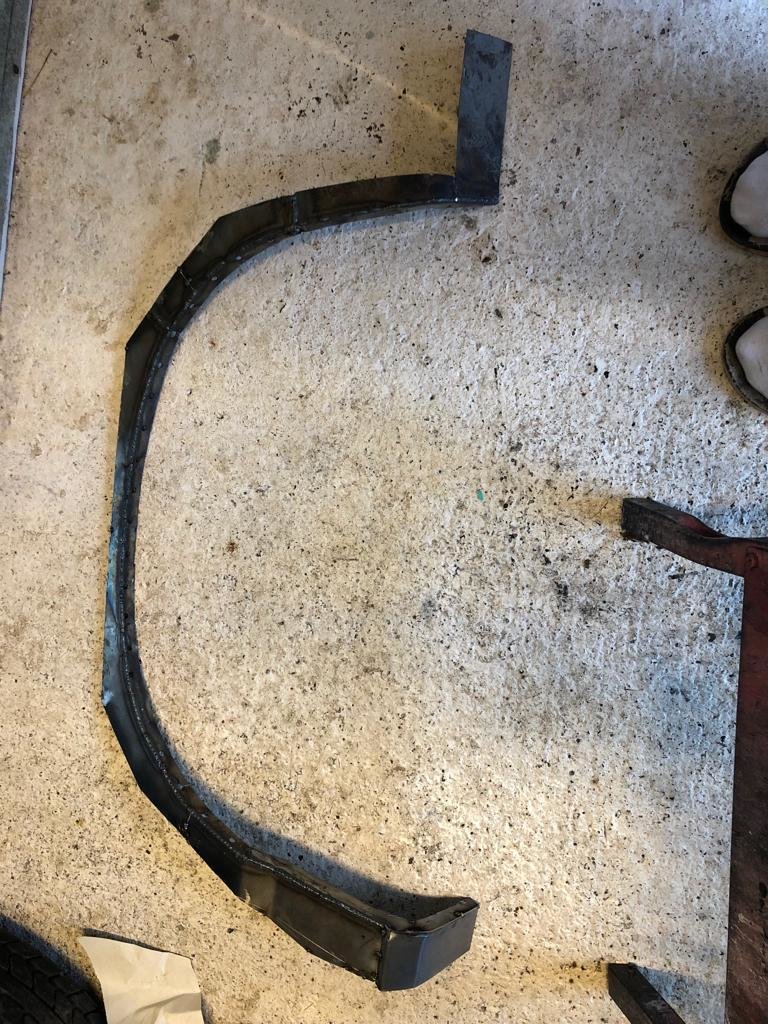

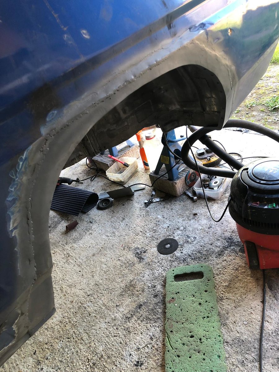

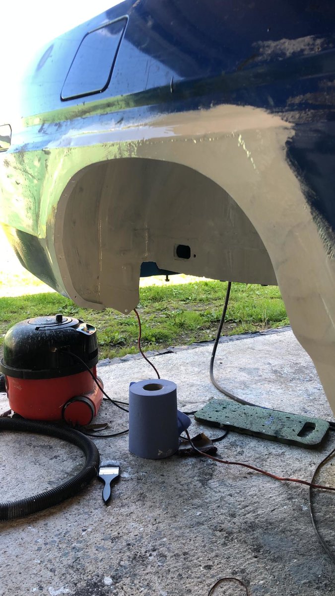

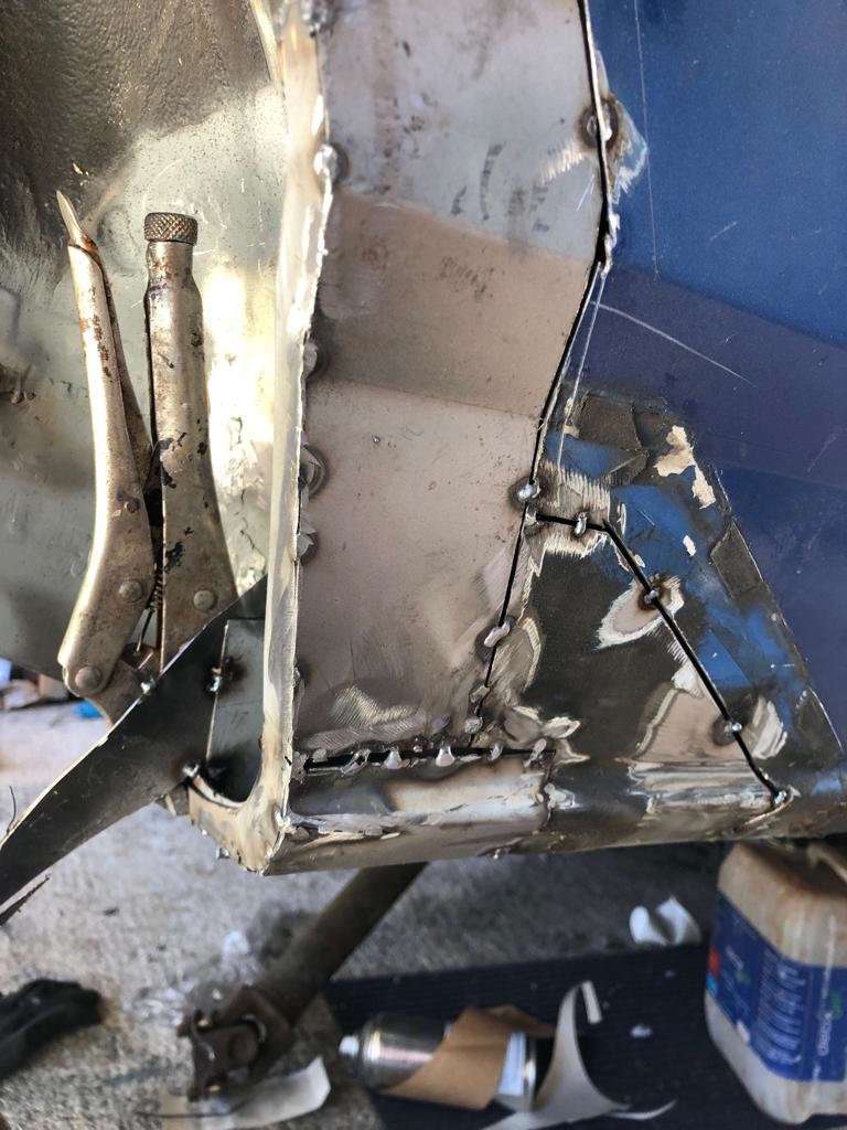

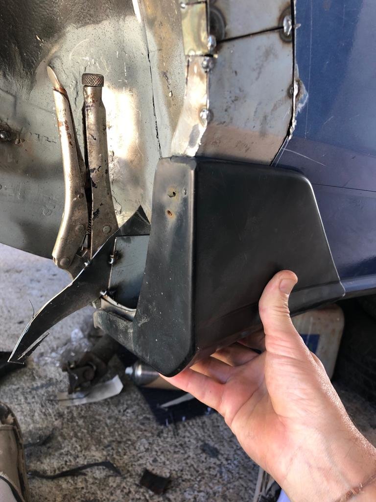

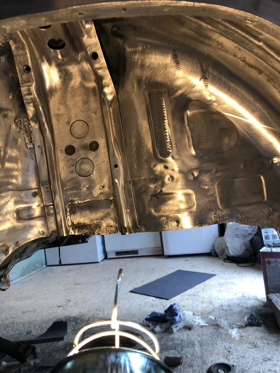

D Giles Baeton Posted September 9, 2019 Share Posted September 9, 2019 Evening guys here’s the latest in my XT restoration. All welding and repairs on rear are complete. New wheel arches made from scratch. All rust cut out and fresh thicker metal welded in. Epoxy primer, base and clear on underside Epoxy primer and Upol raptor on wheel arches. Entire subframe and suspension acid cleaned and either epoxy painted or galvanised or zinc coated ( where applicable) All nuts and bolts zinc plated or renewed in stainless steel. Suspension all rebuild and rebushed ( only 2 original square bushes I had to reuse) Fuel pipe acid dipped Fuel flap and inside repainted. fuel filler bracket plated in correct yellow plating. Tomorrow I hope to attach the Achilles Heal.. The rear air struts. I’ve only painted them as my global search for new ones continues.... Can anyone help with new ( or excellent used) rear struts.... I can arrange shipping worldwide! Soon I’ll start the front end, but it much less work involved than the rear. Thanks for looking guys! Comments welcome please.... i can’t upload any more recent pics atm. Link to comment Share on other sites More sharing options...
idosubaru Posted September 9, 2019 Share Posted September 9, 2019 What else is there to say except that you're absolutely killing it. Well done. How did remaking the rear arches go? Do you cut and use the originals as templates? Does it take hours or days per arch? I guess you cut out a sizable chunk to get all of the rust that you can't visibly see that gets down into all the folds and inaccessible areas where two or more sheets come together? 1 Link to comment Share on other sites More sharing options...

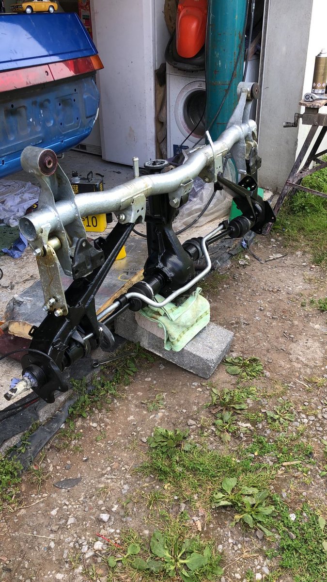

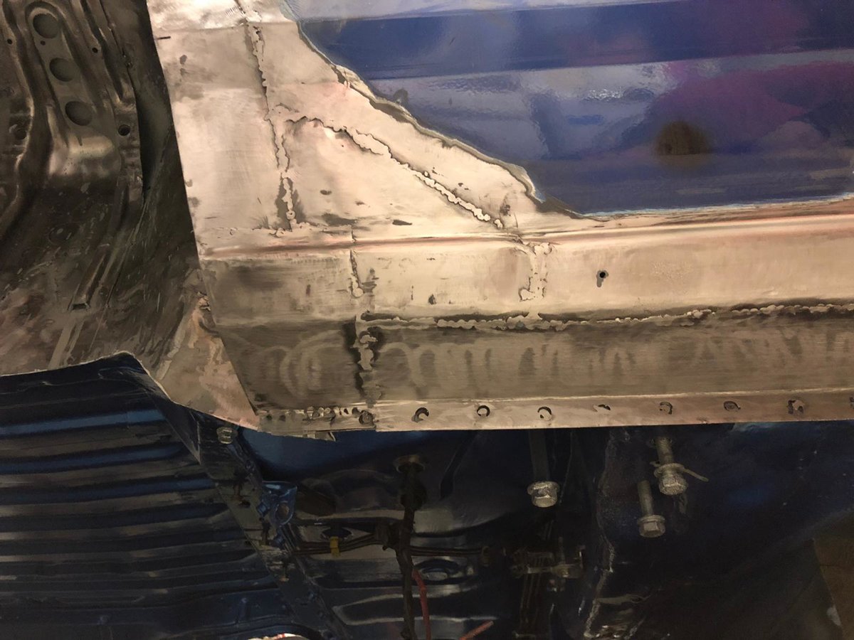

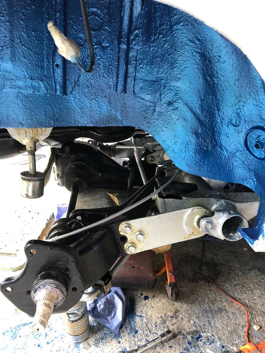

Giles Posted April 22, 2020 Author Share Posted April 22, 2020 Hi guys. I’m back. Sorry lve not been giving updates. But I’m having problems with this website.. And none of the admin answer my login problems.. and I’m still paying $5 per month.. Anyway.. My XT is coming along well. The front end is now all done. I had extensive rust on the rockers (sills) And the box section under the floor. Lots of upside welding and plate fabrication Now it’s rock solid. It’s all been sprayed, underneath, inner fenders and engine bay. Epoxy primer ( raptor Seal where appropriate to) basecoat and clearcote. Correct 572 metallic space blue. Part of the original 518 dual paint code. The engine as only 63k miles is going back in basically untouched. Apart from filters, belts etc. All the suspension is galvanised or plated. All bushes replaced.. NEW pair of air struts too!! So now I’m rebuilding the front end. I’m very happy with the work I’ve put in. Unfortunately I can’t upload any pics under this login, ( I’ll message admin again) Also, I’ve dumped the 3EAT auto ( I was never happy about 3 speed ) for a 5 speed push button 4wd Manual I’ve also got a proper new XT AC setup, which I’m installing too. And to top it all, I have a digital dash too. I’ll fit that another time. Hope you are all good. I’m part of the XT groups on Facebook. I know some of you guys are to, I find them very helpful and recommend them. G. 1 Link to comment Share on other sites More sharing options...
