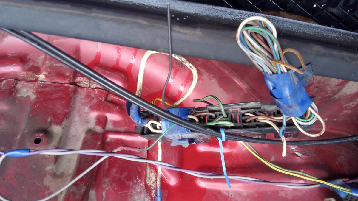

Zip Tie Posted March 5, 2019 Author Share Posted March 5, 2019 On 2/20/2019 at 2:33 PM, FerGloyale said: The relay block behind the battery is attached to the tower with a 6mm bolt. (through one of the relays that has a tab) Alternator connections are insulated, the main lug is missing it's rubber cover, but it's not touching anything. The relay block in the spare tire well was attached better int he past......Someone has cut/moved the Zipties that held it. It's pulled the Vac lines for the 4wd solenoids. Someone must have messed with that. Maybe tried to put the spare tire in there? The headlight bundle is very high quality, abrasion resistant, High temp rated, oil impervious wire. It's bundled to itself so it's fairly stiff. It isn't going to rub through. It isn't going to melt. It's the wiring we used to run our Vegtable oil/Diesel conversions at the old diesel shop. We never ran it in loom because it hinders troubleshooting later. Never had a rub through except once at sharp edge on a Cummins. That saw alot of vibration.......this GL isn't goin to vibrate like that. The fact that it's all there and looks to be intact after 5 years points to it being acceptable for more than a "test drive" But I get it. Some folks need their laundry to be folded and put in drawers. Me? I might do that sometimes but if I leave it in the basket it's easier to see what I've got to wear! What do the gray and purple wires coming out of the relay block in the spare tire well go to? I reconnected the gray one. I can't figure out where the purple one is supposed to go. There is a purple wire on the passenger side against the firewall that goes nowhere....Also, you said it looks like the vac lines for the 4wd are disconnected. Where are those? Link to comment Share on other sites More sharing options...

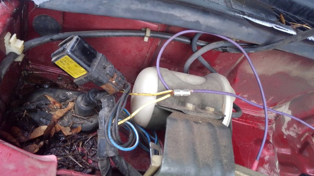

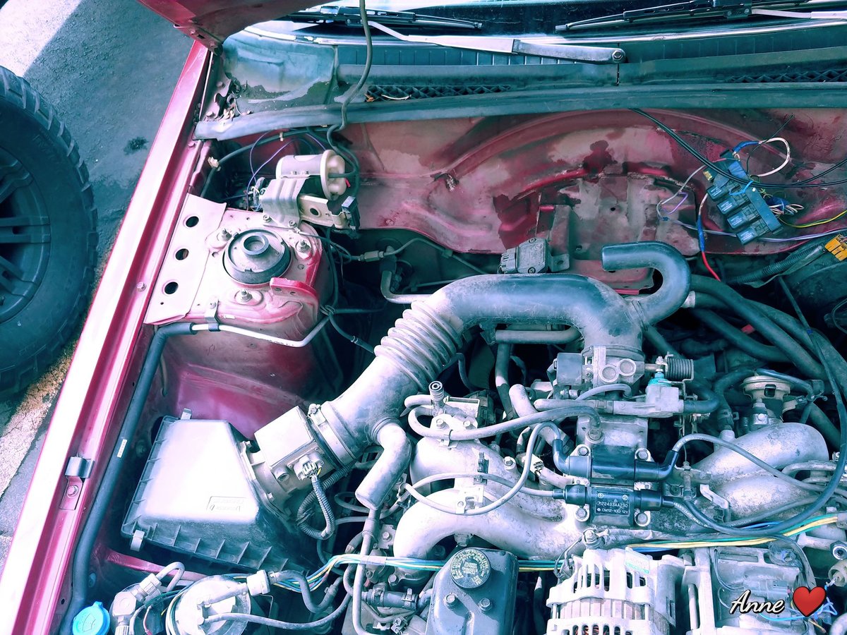

FerGloyale Posted March 5, 2019 Share Posted March 5, 2019 Sounds like fan wiring. I think I may have run a wire to add a switch for fan "on" inside the cab. Might be the purple to nowhere? The gray?.....Does it connect to the yellow wire at the A/C relay block? (passenger strut tower area) That would to trigger on the Factory elec fan (pass side fan) It's been a long time. Too bad the diagram I made got lost. Pics would help me figure some stuff out. Link to comment Share on other sites More sharing options...
Zip Tie Posted March 5, 2019 Author Share Posted March 5, 2019 30 minutes ago, FerGloyale said: Sounds like fan wiring. I think I may have run a wire to add a switch for fan "on" inside the cab. Might be the purple to nowhere? The gray?.....Does it connect to the yellow wire at the A/C relay block? (passenger strut tower area) That would to trigger on the Factory elec fan (pass side fan) It's been a long time. Too bad the diagram I made got lost. Pics would help me figure some stuff out. This might help. Where are the 4wd vacuum lines? Link to comment Share on other sites More sharing options...
Zip Tie Posted March 6, 2019 Author Share Posted March 6, 2019 So I traced the wires from the electric fans and they change color a couple times but end up being the yellow and green wires going into the floating relay block. I replaced the 20amp fuse and the drivers side fan started running without the key being in on. The purple wires do go to a relay with yellow wires. Maybe ac fan. Link to comment Share on other sites More sharing options...

FerGloyale Posted March 7, 2019 Share Posted March 7, 2019 This splice is the OE A/C fan relay signal now controls the new relay in the "floating" block As for fan runing with key off., I am guessing someone grounded the ECU's signal wire. You need to confirm that the "trigger" wire (which is the ground side) for the relays is A) not grounded out. B ) actually connected to the signal wire from the ECU. ECU is from 93 Impreza......I will see if I can find pinouts and wire colors Link to comment Share on other sites More sharing options...
