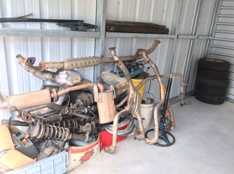

Unknownjeremiah Posted March 10, 2019 Author Share Posted March 10, 2019 (edited) Found one of my two extra carbs. Pretty sure it’s a hitachi. Also found a disty cap and hitachi rotor head. Couldn’t find a driver mirror and didn’t want to grab it off the brat. Cant believe how many extra parts I still have. Edited March 11, 2019 by Unknownjeremiah 1 Link to comment Share on other sites More sharing options...
