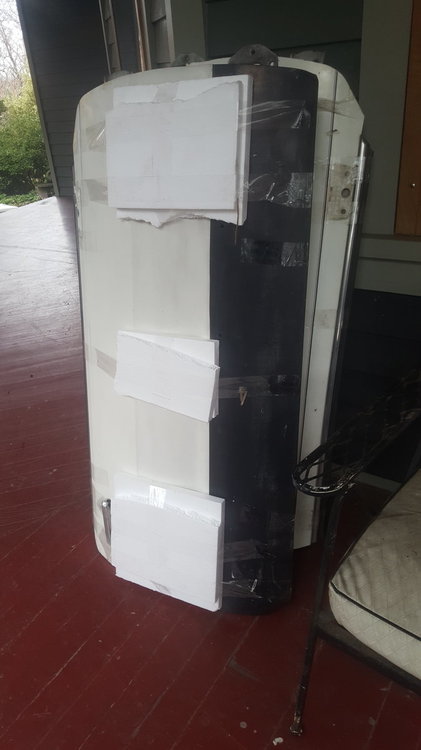

divinicus Posted March 31, 2019 Share Posted March 31, 2019 Hi everyone! Got a beautiful pair of 86 Brat Doors from California for my 83 Brat GL. It was wickedly expensive to ship them from LA to New York! The new doors are stripped of everything, so I need to change over the glass, interior panels, basically everything. Are there any special tools I need, and what is the order of removal and installation in the new doors? I've never done this operation before and could use some advice! Thanks again happy spring! Link to comment Share on other sites More sharing options...
moosens Posted April 1, 2019 Share Posted April 1, 2019 No special tools , you’ll do fine , just keep note of what you’ve removed and do one door at a time so you still have an original for reference. Many of us have done this and I’ve never had any big issue. Glass is tricky but put it on an angle when pulling it out of the tracks and pretty sure you’ll want to lift the rear end up lastly so you get that required angle to remove and then install. Door lock stuff requires a bit of patience most of the time and smaller fingers help. There you might find a spring hook helps but chances are a straight head screwdriver will get you through. Go at it , you’ll be fine. 1 Link to comment Share on other sites More sharing options...

el_freddo Posted April 1, 2019 Share Posted April 1, 2019 I’d say remove the door and fit the new one while it’s still light weight! Then pull everything from the donor door and fit in the reverse order of how it all came off - I bet the door handle/latch mechanism will be last to come off, meaning first to go on. Cheers Bennie 1 Link to comment Share on other sites More sharing options...

divinicus Posted April 2, 2019 Author Share Posted April 2, 2019 I just looked at the Brat and realized the bolts to mount the door hinges can't be accessed unless the front fenders are taken off, is this right? Thanks! Link to comment Share on other sites More sharing options...
BEECHBM69 Posted April 2, 2019 Share Posted April 2, 2019 1 hour ago, divinicus said: I just looked at the Brat and realized the bolts to mount the door hinges can't be accessed unless the front fenders are taken off, is this right? Thanks! You can take the hinges off your new doors and use the old hinges still bolted to the car. Not fun by yourself, but doable. I was able to do it with a floor jack and piece of 2x4 when swapping complete doors out. Dan 1 Link to comment Share on other sites More sharing options...
moosens Posted April 3, 2019 Share Posted April 3, 2019 Open the door all the way and use an extension. If need be just take the lower bolts out of the fender tail and the one bolt between the hinges. But really with patience and as mentioned the jack and some wood and you’ll be fine. I recall using a deep socket 10mm with extension for what you’re doing with the fender on. Link to comment Share on other sites More sharing options...
el_freddo Posted April 3, 2019 Share Posted April 3, 2019 Removing the front guards makes it so much easier. And a good time to address any other issues under there while you’ve got full access. Cheers Bennie Link to comment Share on other sites More sharing options...
