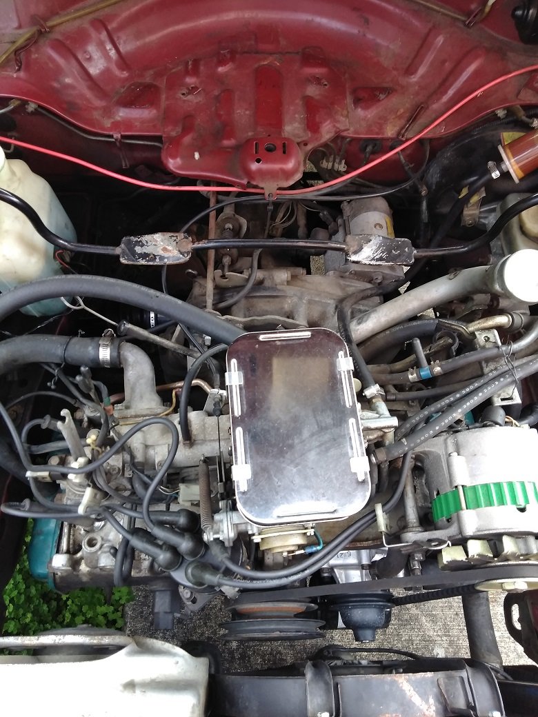

On my 84 EA81 brat I need to replace my throttle cable. The wrong one was installed in the car.  It was way too long and just looped around and zip tied under the spare tire. I now have the correct throttle cable I just cannot find a diagram anywhere on the internet to see how to run the cable the proper way in the engine bay. Does anybody have a picture or a diagram to show me how to run the cable?

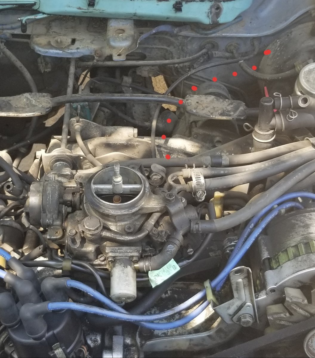

if your stock carb looks much the same as the first pic with pull side the same follow that pattern.

Here you go. If you are using stock carburetor cable should be on right if you are looking at it.
You;ve got a carter carb.  Must be an 82.
the hitachi carbs cable goes to the other side.  his 84 will have a hitachi as the stock carb.
