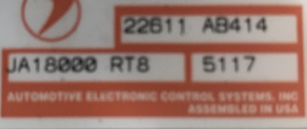

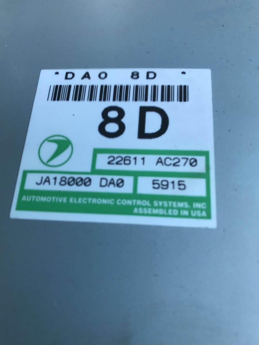

Ravenwoods Posted May 17, 2019 Author Share Posted May 17, 2019 On 5/10/2019 at 7:00 PM, idosubaru said: you don't, not sure what they have in his country, but that is not an appropriate course of action for any 1990's US market Subaru. swap sensors and carry on just like you did. the ECU has no idea what sensor is in there, there's no identifying data for a specific sensor. you can swap ECU's (which thereby changes *all* the sensors) - plug in another ECU and drive immediately. which, since you have additional vehicles and an untraceable issue you could try. plug in another ECU and see what happens. model and EJ22 or EJ25 doesn't matter as long as they're all 1995-1998 legacy/outbacks/foresters - all the ECU's are plug and play interchangeable. Expand I finally had a chance to swap the ECU from a 95 Legacy into the 96 Legacy. Our problem car, the 96 now doesn’t start at all. The 96 had the 8D ECU. The 95 has the 2D ECU. Link to comment Share on other sites More sharing options...
Ravenwoods Posted May 17, 2019 Author Share Posted May 17, 2019 On 5/17/2019 at 1:11 AM, Ravenwoods said: I finally had a chance to swap the ECU from a 95 Legacy into the 96 Legacy. Our problem car, the 96 now doesn’t start at all. The 96 had the 8D ECU. The 95 has the 2D ECU. Expand Here is the 2D ECU Link to comment Share on other sites More sharing options...
Ravenwoods Posted May 17, 2019 Author Share Posted May 17, 2019 Swapping the ECUs only causes neither car to run. It seems the ECUs are different. Link to comment Share on other sites More sharing options...
GeneralDisorder Posted May 17, 2019 Share Posted May 17, 2019 95 is a completely different pinout than 96. They are entirely incompatible though they do share the same connector. GD Link to comment Share on other sites More sharing options...
