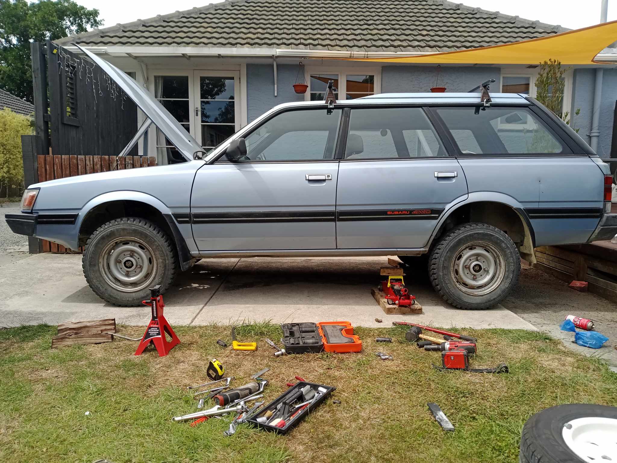

KiwiGL Posted May 18, 2023 Author Share Posted May 18, 2023 Finally acquired a set of Peugeot 14" steelies to fit my Maxxis mud tyres to. Looks good if I may say so myself. Before anyone asks, Torqlocker is in the mail... Just waiting on Subarino to finally release their lift kit, then I can crack on with putting that in, along with an injected EJ22 and a rare part time 4wd dual range EJ box from an early Legacy. And then get it engineer certed haha 😂 2 Link to comment Share on other sites More sharing options...

KiwiGL Posted July 11, 2023 Author Share Posted July 11, 2023 (edited) Removing the rear diff proved beyond me at home (CV locked in diff even with roll pin out), so it's going in for a WOF and locker fitment next week. On the shortlist for a Subarino lift, number 7! Then I'll throw the EJ and legacy box in it and get it all certed! Getting there slowly. Also loving having a heater in it again - replaced the core a wee while ago. Might think about fitting AC when I do the swap as the EJ has a compressor on it... Edited July 11, 2023 by KiwiGL 1 Link to comment Share on other sites More sharing options...

KiwiGL Posted July 20, 2023 Author Share Posted July 20, 2023 Locker is nearly in! Up on the hoist at Crowesport today... 2 Link to comment Share on other sites More sharing options...

KiwiGL Posted July 22, 2023 Author Share Posted July 22, 2023 Took her for a spin today down the Waimakariri river, locker in and muddies on. Traction is incredible! Clearance and power are now the main issues... Which will be fixed with a lift and EJ22. Can't wait to get it fully built. 2 Link to comment Share on other sites More sharing options...

KiwiGL Posted February 27, 2024 Author Share Posted February 27, 2024 On 11/23/2023 at 1:15 PM, 573417h said: This looks mean, get the SI subies together for a wee roady, was there any real boggy or difficult bits etc, or all just mainly gravel roads? There was one really steep, off camber, rutted hill climb! A Ford Ranger PX3 struggled to get up that, but was a breeze in the Subie. Since that trip I've also thrown in the lift kit... 1 Link to comment Share on other sites More sharing options...
