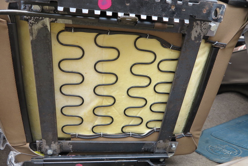

I tried swapping the passenger seat over on my 82 wagon to the driver, but it gets stuck on the tilt mechanism and I couldn't find an easy way to swap that over without having to press out the bit at the base where the seat tilts. I tried knocking it out, but just ended up banging in the metal a bit in the process. A press may have worked, but I would have still needed 1 seat anyways and now I can move the passenger seat back to it's spot. My original driver seat was very, very broken down and had parts of the springs broken off that I found under the seat.

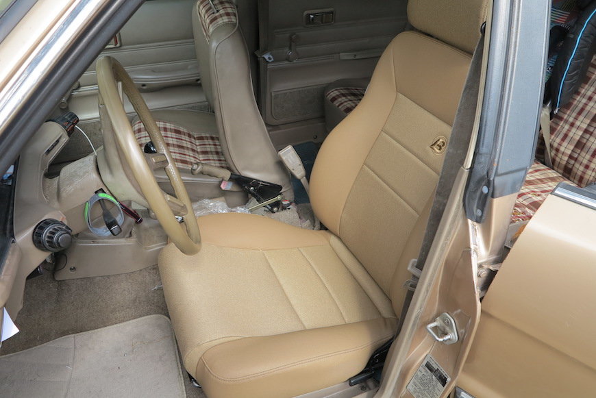

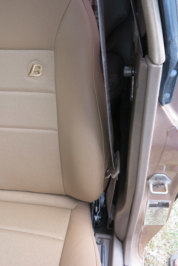

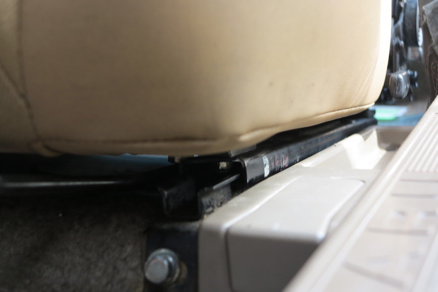

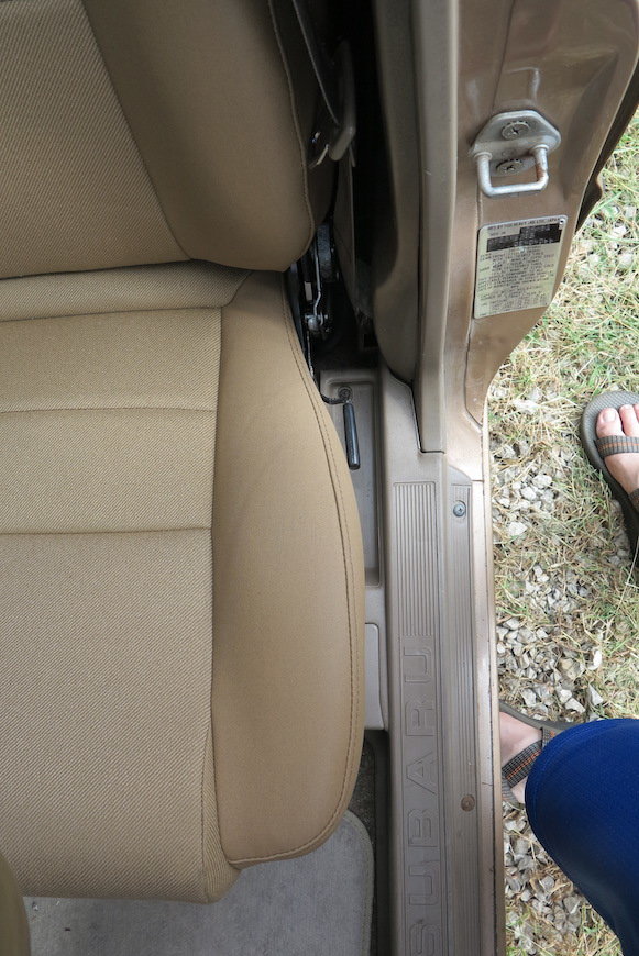

I'll post some pictures tomorrow, but I have the new seat mounted and I love it. Stiffer for sure and actually a little shorter than the OEM though that's strictly due to the bracket mechanism a friend made for me. If I was very more concerned about fit adjustability I'd have the bracket mechanism modified to allow it to shift left or right to accommodate for the drive shaft well and the width of the seat. I could shift another 3/4 inch and raise the seat height a bit and it would nearly be a perfect fit. I went for too long using the passenger seat in the driver side so I feel like I'm riding in the lap of luxury now with both front seats installed. I could see myself down the line replacing the passenger side for match and durability. I think these new seats are going to wear very well over the long term.
