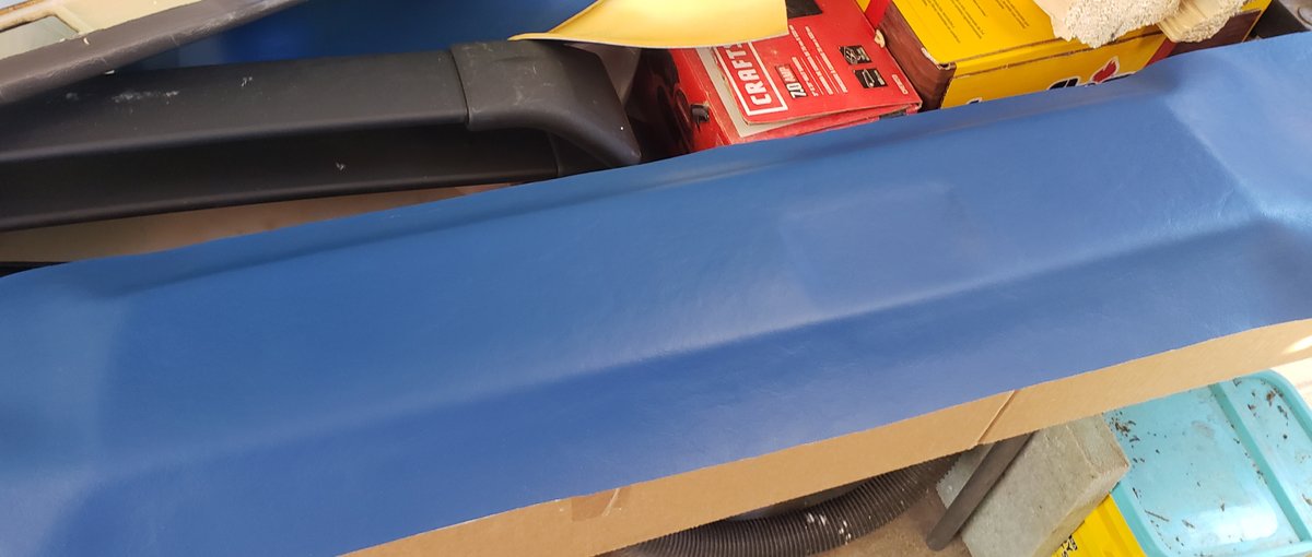

Checkerboard Comet Posted June 17, 2020 Share Posted June 17, 2020 I just picked this up from Ebay, should do the trick! Link to comment Share on other sites More sharing options...

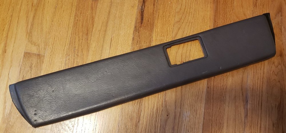

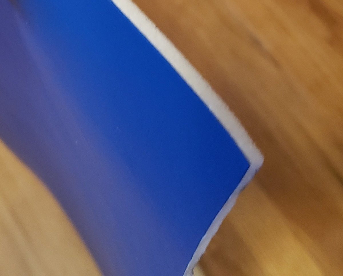

Checkerboard Comet Posted June 20, 2020 Share Posted June 20, 2020 (edited) OK, the vinyl arrived yesterday. Yes, 1/8" thick foam marine grade vinyl is the exact duplicate material you want to get that OEM look. I am on the process of removing the old vinyl off the plastic pieces and cleaning off all the contaminants (glue, foam, oils, etc.). I will post more pics as the progress moves along. Pic is of plastic all cleaned up. Edited June 20, 2020 by Checkerboard Comet Link to comment Share on other sites More sharing options...

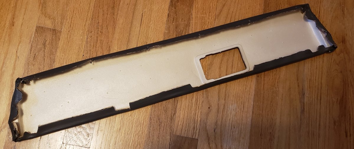

Checkerboard Comet Posted June 20, 2020 Share Posted June 20, 2020 (edited) Original foam/vinyl Edited June 20, 2020 by Checkerboard Comet Link to comment Share on other sites More sharing options...

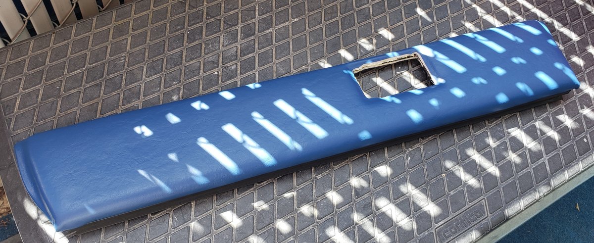

Checkerboard Comet Posted June 21, 2020 Share Posted June 21, 2020 Gluing process, using contact cement. Link to comment Share on other sites More sharing options...
Checkerboard Comet Posted June 21, 2020 Share Posted June 21, 2020 (edited) 1 down, 3 to go... Edited June 21, 2020 by Checkerboard Comet Link to comment Share on other sites More sharing options...
