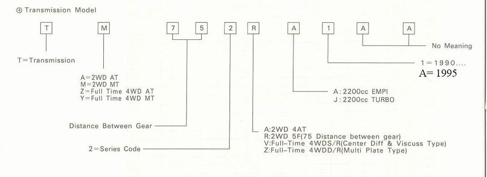

Rampage Posted June 10, 2020 Share Posted June 10, 2020 About those stickers on the tranny. The first 6 digits must match your original transmission. The 7th letter A means 2.2 non-turbo. 1 Link to comment Share on other sites More sharing options...

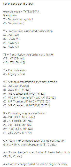

grimaceNMike Posted June 10, 2020 Author Share Posted June 10, 2020 11 hours ago, Rampage said: About those stickers on the tranny. The first 6 digits must match your original transmission. The 7th letter A means 2.2 non-turbo. - Thanks!! I found a similar explanation for the 2nd gen. Good to see this info. So, do people all agree that I should avoid getting that transmission with the nasty fluid in it?? Link to comment Share on other sites More sharing options...

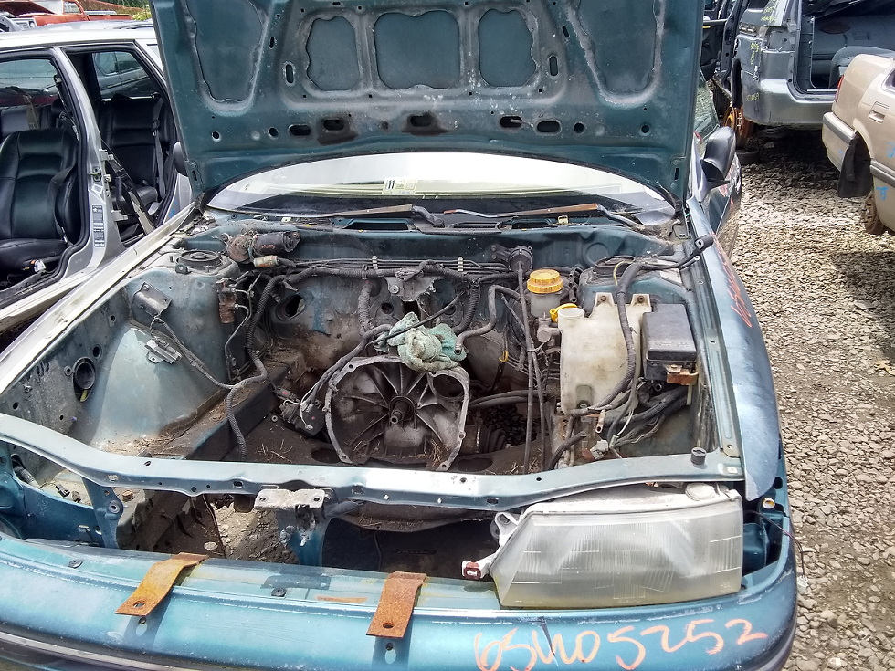

grimaceNMike Posted June 11, 2020 Author Share Posted June 11, 2020 15 hours ago, lmdew said: Seat of the pants. Just drive it. Try tight slow circles in both directions, checking for torque bind. Make sure it shifts through the gears as it should. No AT Temp light flashing. Just to be clear, this is what the donor car looks like. It doesn't have an engine, or wheels. How do I test THAT transmission before I put it in? Link to comment Share on other sites More sharing options...
idosubaru Posted June 11, 2020 Share Posted June 11, 2020 (edited) 40 minutes ago, grimaceNMike said: Just to be clear, this is what the donor car looks like. It doesn't have an engine, or wheels. How do I test THAT transmission before I put it in? Back to what he said in his first post - If it's not wrecked, not rusted to pieces, and the engine seemed good enough for someone to take it, and add to that the fluid looked like garbage....I wouldn't want that transmission. But if it's your only option to replace an already bad transmission and you've got all the time in the world, then I guess you go for it. Edited June 11, 2020 by idosubaru 1 Link to comment Share on other sites More sharing options...
grimaceNMike Posted June 11, 2020 Author Share Posted June 11, 2020 22 minutes ago, idosubaru said: Back to what he said in his first post - If it's not wrecked, not rusted to pieces, and the engine seemed good enough for someone to take it, and add to that the fluid looked like garbage....I wouldn't want that transmission. But if it's your only option to replace an already bad transmission and you've got all the time in the world, then I guess you go for it. Idosubaru, thank you for the advice. There is a large dent in the rear quarter panel where it looks like it was lightly t-boned. But the damage doesn't look extensive enough to total the car. There is also a rusted-out hole about 6 inches in diameter near the rear door frame. I am torn if the car was hit, parked, and then donated years later, or if the trans went and the owner pulled the engine and then donated the car?? Dang it I wish people wrote car history in magic marker under the hood before donating it! Link to comment Share on other sites More sharing options...
idosubaru Posted June 11, 2020 Share Posted June 11, 2020 3 hours ago, grimaceNMike said: Idosubaru, thank you for the advice. There is a large dent in the rear quarter panel where it looks like it was lightly t-boned. But the damage doesn't look extensive enough to total the car. There is also a rusted-out hole about 6 inches in diameter near the rear door frame. I am torn if the car was hit, parked, and then donated years later, or if the trans went and the owner pulled the engine and then donated the car?? Dang it I wish people wrote car history in magic marker under the hood before donating it! a rear quarter panel hit easily totals subaru's, even ones a decade or more younger than this one. they're welded in place and take significant body work to cut, align, weld, paint compared to bolt on body parts. $500 part, $500 welding/prepping, $500 painting. $1,500 puts it in total range for a car valued at $2,000 which is probably more than this car would be worth. And that's assuming no additional work, lights, pin stripes, available parts for repair....etc. it's probably ambiguous but maybe - If the rear quarter dent has exposed metal that doesn't look very rusty (mostly surface rust) then you could potentially guess that it was a "recent" hit and not driven around or sitting around exposed for years on end like that. I have two wrecked Subarus I just bought within the last few months and some exposed/damage metal is starting to rust but it's obviously surface rust and not cratered rust from sitting for years. 1 Link to comment Share on other sites More sharing options...
