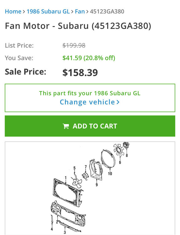

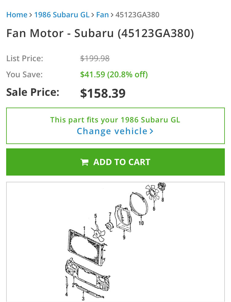

Unknownjeremiah Posted May 31, 2019 Share Posted May 31, 2019 I’m debating about buying this fan motor and hoping it’s the right one from the Subaru parts store in Tacoma. Link to comment Share on other sites More sharing options...

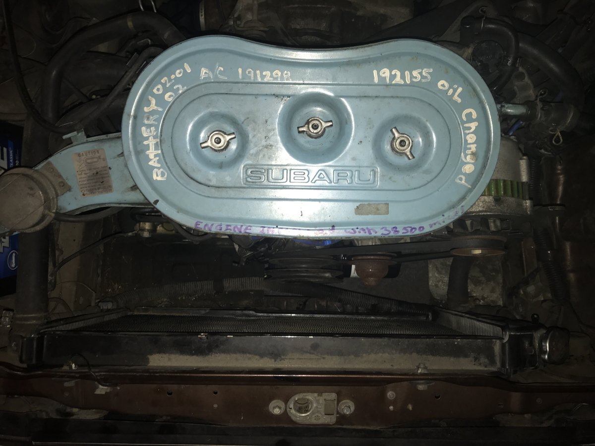

Unknownjeremiah Posted May 31, 2019 Share Posted May 31, 2019 This is what I’m working with Link to comment Share on other sites More sharing options...

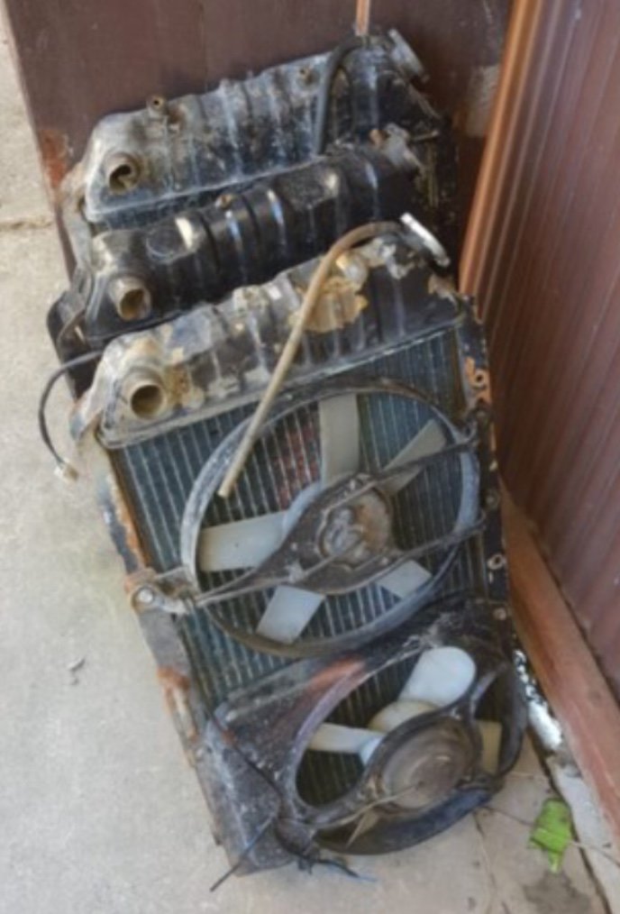

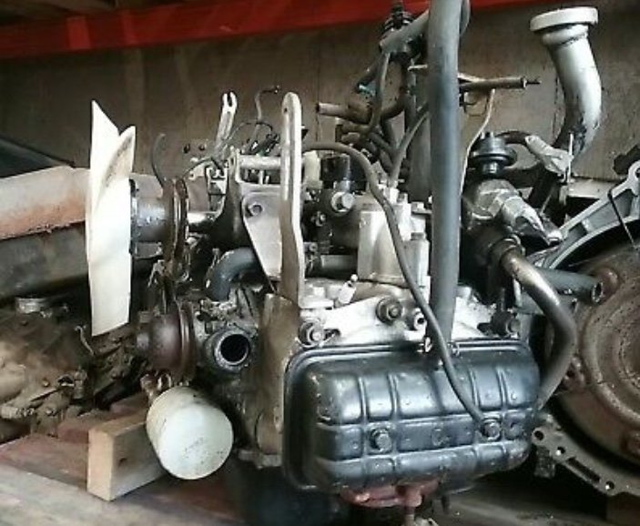

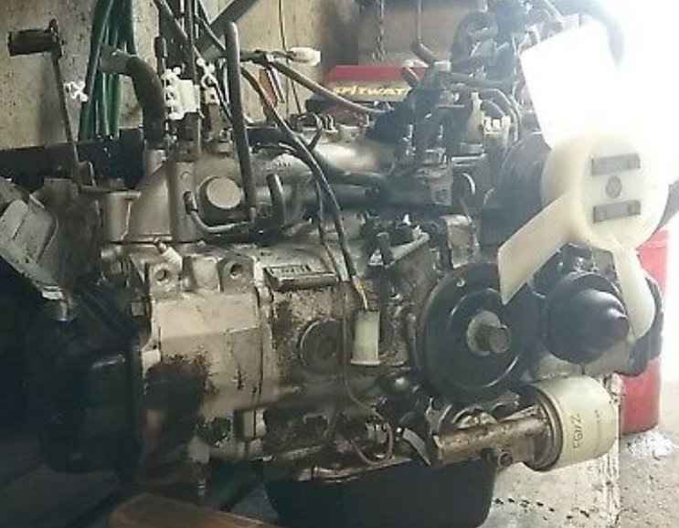

el_freddo Posted May 31, 2019 Share Posted May 31, 2019 (edited) 6 hours ago, naru2 said: Not quite. My 84 turbo has no AC and no direct drive fan. Maybe you meant WITH AC? No, definitely without AC. @carfreak85 - The turbo one won’t fit as that is based on the EA82 setup. The EA81 doesn’t have the ability to bolt anything to the water pump pulley. I’m starting to think this fan was an Australian only thing - but I find that hard to believe. ^ This is what I’m talking about. Mover here, if you’ve got AC fitted this fan is removed for a second electric fan that’s run by the AC wiring loom. Here’s a pic of the stock electric fan with the AC (top unit): If you can’t find a mechanical fan, I’d be using all of that available space for a larger thermo fan or two smaller units. I’ve got 2x 12 inch on my L series from memory - these cool the EJ just fine, so cooling the little EA81 would be a breeze. Cheers Bennie Edited May 31, 2019 by el_freddo Link to comment Share on other sites More sharing options...

naru2 Posted June 1, 2019 Share Posted June 1, 2019 22 hours ago, Unknownjeremiah said: I’m debating about buying this fan motor and hoping it’s the right one from the Subaru parts store in Tacoma. Why decide based on hope?Fitment info is readily available.This fan motor is not for a brat. Make Body & Trim Engine & Transmission 1987 Subaru DL Base 1.8L H4 - Gas 1986 Subaru DL Base 1.8L H4 - Gas 1985 Subaru DL Base 1.8L H4 - Gas 1987 Subaru GL Base, Turbo 1.8L H4 - Gas 1986 Subaru GL Base, Turbo 1.8L H4 - Gas 1985 Subaru GL Base, Turbo 1.8L H4 - Gas 1987 Subaru GL-10 Base, Turbo 1.8L H4 - Gas 1986 Subaru GL-10 Base, Turbo 1.8L H4 - Gas 1985 Subaru GL-10 Base, Turbo 1.8L H4 - Gas 1987 Subaru RX Turbo 1.8L H4 - Gas 1986 Subaru RX Turbo 1.8L H4 - Gas 1985 Subaru RX Turbo 1.8L H4 - Gas 1986 Subaru XT DL, GL, GL-10 Turbo 1.8L H4 - Gas Get one that fits https://www.ebay.com/itm/Subaru-Brat-Brumby-284-MV-1978-1994-EA81-Engine-Cooling-Fan-Housing/233234834318?hash=item364de1238e:g:ueoAAOSwSeVaKo7- I`m sure there are more closer to home. Link to comment Share on other sites More sharing options...
Unknownjeremiah Posted June 1, 2019 Share Posted June 1, 2019 10 minutes ago, naru2 said: Why decide based on hope?Fitment info is readily available.This fan motor is not for a brat. Make Body & Trim Engine & Transmission 1987 Subaru DL Base 1.8L H4 - Gas 1986 Subaru DL Base 1.8L H4 - Gas 1985 Subaru DL Base 1.8L H4 - Gas 1987 Subaru GL Base, Turbo 1.8L H4 - Gas 1986 Subaru GL Base, Turbo 1.8L H4 - Gas 1985 Subaru GL Base, Turbo 1.8L H4 - Gas 1987 Subaru GL-10 Base, Turbo 1.8L H4 - Gas 1986 Subaru GL-10 Base, Turbo 1.8L H4 - Gas 1985 Subaru GL-10 Base, Turbo 1.8L H4 - Gas 1987 Subaru RX Turbo 1.8L H4 - Gas 1986 Subaru RX Turbo 1.8L H4 - Gas 1985 Subaru RX Turbo 1.8L H4 - Gas 1986 Subaru XT DL, GL, GL-10 Turbo 1.8L H4 - Gas Get one that fits https://www.ebay.com/itm/Subaru-Brat-Brumby-284-MV-1978-1994-EA81-Engine-Cooling-Fan-Housing/233234834318?hash=item364de1238e:g:ueoAAOSwSeVaKo7- I`m sure there are more closer to home. I am not working on a brat, working on a hatchback. But also thanks. Link to comment Share on other sites More sharing options...
naru2 Posted June 1, 2019 Share Posted June 1, 2019 Same thing if it is ea81. Link to comment Share on other sites More sharing options...
