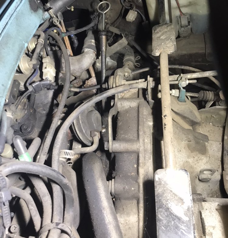

Unknownjeremiah Posted May 20, 2019 Author Share Posted May 20, 2019 4 minutes ago, DaveT said: The timing marks are viewed through an opening in the bell housing behind the carb or throttle body. There should be a black rubber plug covering it. Any pointers Link to comment Share on other sites More sharing options...
Unknownjeremiah Posted May 20, 2019 Author Share Posted May 20, 2019 Wrong side of the engine. Ok I see that. Now do I just match the timing light up with that little tab? Link to comment Share on other sites More sharing options...
DaveT Posted May 20, 2019 Share Posted May 20, 2019 I can't tell from that angle.... The marks are on the face of the flywheel that faces toward the front of the car. There should be a V [but with one edge vertical] in the opening revealed by removing the rubber plug. That vertical edge is the mark. The degrees and zero are embossed on the flywheel. Depending on the type of engine and fuel delivery, there may be wires or hoses to plug / unplug / connect. to set or check timing. Link to comment Share on other sites More sharing options...
