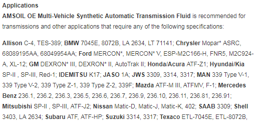

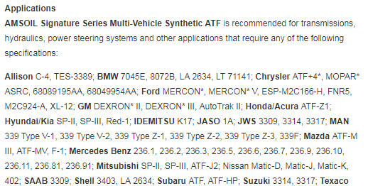

GeneralDisorder Posted June 1, 2019 Share Posted June 1, 2019 Amsoil is compatible to all Subaru specifications including ATF-HP. It's listed on the container. GD Link to comment Share on other sites More sharing options...

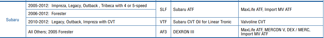

Mike104 Posted June 1, 2019 Share Posted June 1, 2019 From Valvoline 1 Link to comment Share on other sites More sharing options...
Mike104 Posted June 1, 2019 Share Posted June 1, 2019 AMSOIL Options Link to comment Share on other sites More sharing options...

somick Posted June 4, 2019 Share Posted June 4, 2019 On 5/31/2019 at 4:33 PM, somick said: I am planning to drain/refill my 2010 Forester this weekend with the Valvoline Max Life. I will report back if I get any problems. Sam Expand I drained my ATF over this weekend and refilled it with the 3.7quarts of Valvoline MaxLife. Yesterday (Monday) I took it to work. Forty miles let me warm up the car pretty well and let me make sure the fluid level is correct. I did not experience any problems whatsoever. I do realize that I still have ruffly two thirds of the old fluid in it. I am very happy! This is another nail in the coffin of the SPECIAL Subaru fluid. This is the second car with automatic transmission I experiment with using Valvoline MaxLife. One drain/refill saves me about ten dollars, which is not a big deal, but the main thin is there is no such thing as "pay extra" for the special Subaru stuff. Sam Link to comment Share on other sites More sharing options...
