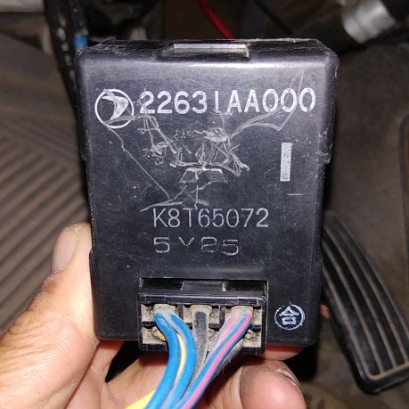

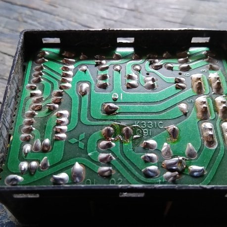

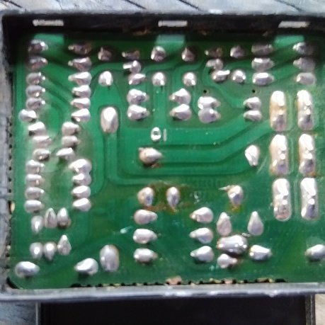

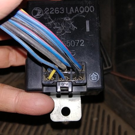

Now how does this relay work when on? Is the single blue wire the hot wire going IN? Isn't there another wire that's suppose to be hot as well going to the fuel pump? I did a test on the power connector going to the fuel pump and zero volts. So I got curious and popped open the FPCU switch. I think the circuit board took a hit when I dropped in a 20a fuse at the side of the road. Here's some pics of the board...
Can you see the melted circuit around the resistors soldering points? I'm thinking this is the stopping point to my gremlin. So I decided to go to the junkyard and pull a couple switches that were identical to mine. Upon replacing the switch I see my voltmeter still shows only the one hot wire. The clicking noise stopped on my fuel pump. What else can I do? I had the disty, plugs and wires checked I'm at a lost here. Any advice is appreciated.

First, there is no coil "GROUNDING" wire.  The coil grounds through it's bracket.  No ground wire, ever.
The - side of the coil should have 2 wires on it.  One from the disty, and one Yellow one that is TACH signal wire.  That same TACH signal wire also goes to the FPCU.  THE FPCU, will only pass power on to the Fuel pump, and to the Auto choke and anti-diesel solenoid on the carb IIRC.
At any rate.  There should not be any wire from the coil to ground.  If you did that, that could explain blown fuses, and no TACH signal to the FPCU, hence no fuel.
A side note, fuses are rated in AMPS, not volts.  All wireing int eh car is 12v.  The size of the load determines the AMPS needed for any fuse.  Now, if you put a larger fuse in (20A instead of 15) the circuit won't blow when it should, and the FPCU may have been hurt by the grounded coil wire.  Although honestly, that doens't really look burned.....trouble is likely somewhere else.
make sure the yellow wire is on the - side of the coil, and no wires from either post to ground and try one of the new FPCU units.

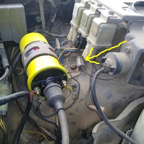

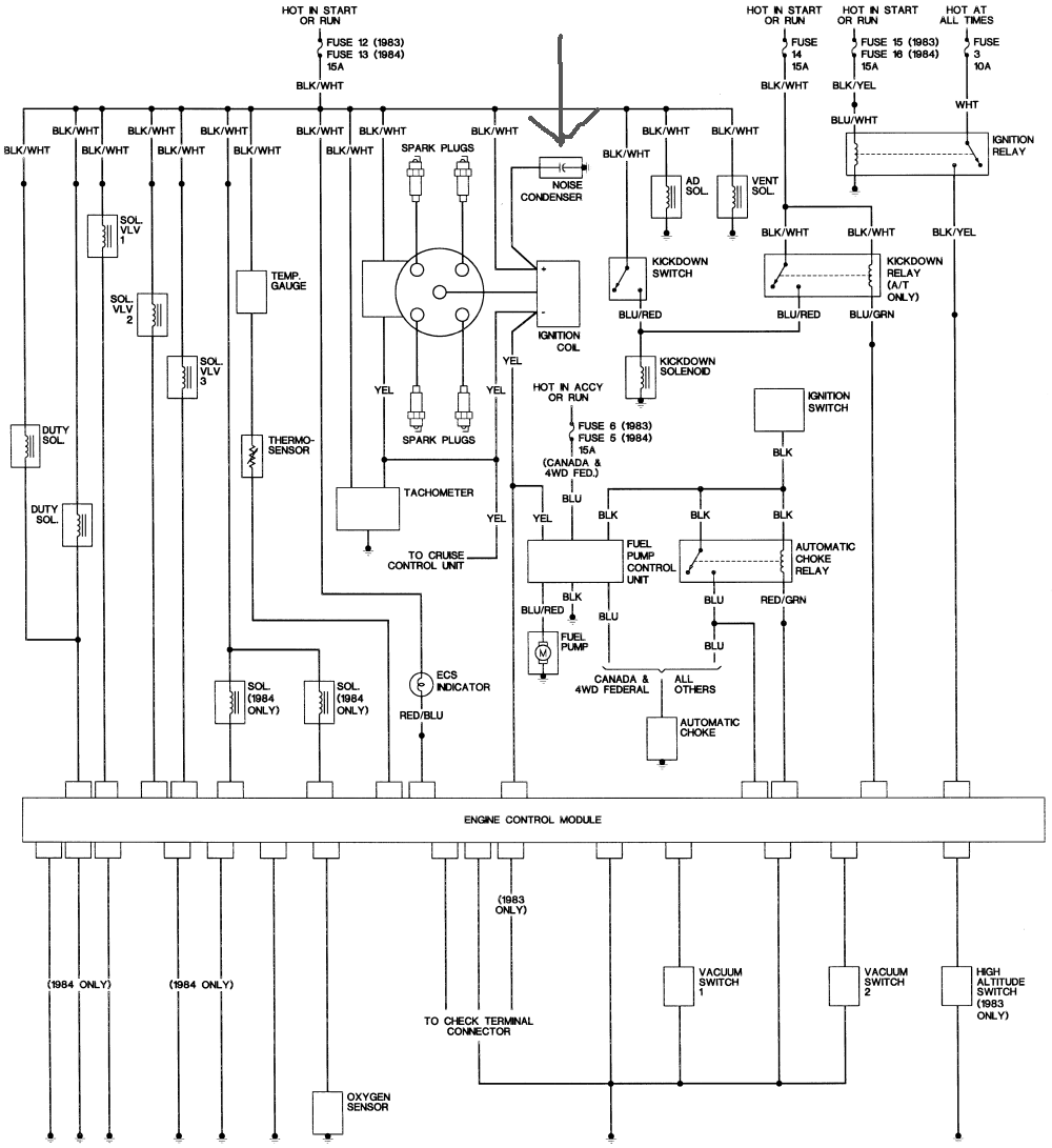

I have what's called a "noise reducer" coming off the Ignition coil. It is grounded. A mechanic in a Denver soobie shop put it on and explained to me why it was missing. has something to do with hearing the engine rev thru the radio. Here's a schematic showing it belongs there
Is this incorrect? I'll take a pic of the condenser L8r today.

FerG     I'm not sure 'bout only having 2 wires again. I have a yellow wire coming off my NEG post and two black wires coming off my ignition coil. One leading to the condenser which I marked in the photo. Here's the pic
The FPCU will not work w/o ignition pulses.
If a test light on coil negative does not pulse when cranking,you are not going to get fuel.
Fuse #5 supplies some FPCU power thru the ACC position of the ignition switch.
Run position supplies other power.You should have power on 2 wires w/the key on.
.Fuse #13 for the coil.
You are correct about that condenser.  It should be on the + side on your model. And it's not necessary to make the engine run. Old school points disty required them, but not this setup, it's just for noise suppression.
But I don't see the second yellow wire on the coil that would be the tach wire.  Without that , the FPCU won't power the fuel pump.

Took me a bit to locate another 6 pole FPCU (non turbo of course!) and like a country song played backwards - everything got fixed (wife comes back, kids love ya, truck starts run'n and you find your dog!)
I mean electrical issues 1 - 4 got fixed - dash lights work! Idle is back to normal. Hell even my door buzzer is back! Thanks guys for the knowledge and advices! I'll do my best to stay on top of issues but goddamn this is a cool place to get help on an "immediacy" tip.
