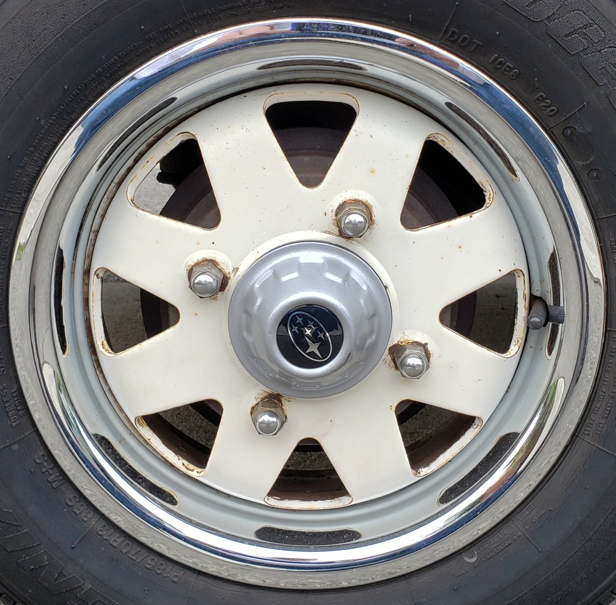

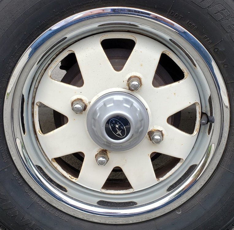

Subasaurus Posted June 20, 2019 Share Posted June 20, 2019 18 hours ago, sparkyboy said: where did you find the beauty rings at? or are those the originals? Link to comment Share on other sites More sharing options...

Checkerboard Comet Posted June 21, 2019 Share Posted June 21, 2019 22 hours ago, Subasaurus said: where did you find the beauty rings at? or are those the originals? EBAY, those are what I use... https://rover.ebay.com/rover/0/0/0?mpre=https%3A%2F%2Fwww.ebay.com%2Fulk%2Fitm%2F360913631524 Work great for me 1 Link to comment Share on other sites More sharing options...
sparkyboy Posted June 23, 2019 Share Posted June 23, 2019 Mine are oem from the junkyard, I believe from a sube cause I was all happy, me and then gf just got the 86 and when I showed her she flipped. The aftermarket ones have those rounded edges, I have one on my camaro. But look, these Mustang II covers will fit if the inside part is cut out for the lug nuts! Link to comment Share on other sites More sharing options...
