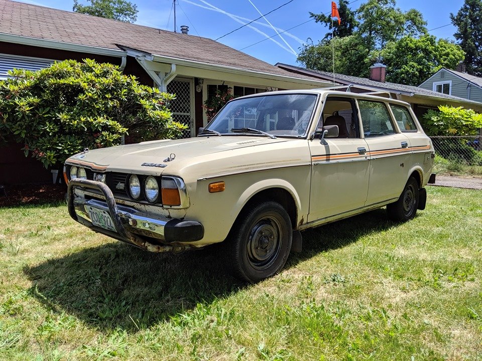

curtkline Posted June 24, 2019 Share Posted June 24, 2019 I just bought a 1978 DL Wagon 4wd and it has 13 inch wheels. I found some 14-inch Peugeot wheels (4x140) and thought I would mount some slightly taller tires on those - and switch to all terrain tires. Will this cause any issues? How big can I go without problems? Thanks in advance. Link to comment Share on other sites More sharing options...
travelvw Posted June 27, 2019 Share Posted June 27, 2019 Nice looking wagon. I don't think you will be able to find a 14" tire at stock height that isn't a passenger snow tire. What size depends on offset and availability, but either way there is not much room in those wheel wells. K Link to comment Share on other sites More sharing options...
carfreak85 Posted June 28, 2019 Share Posted June 28, 2019 4Wheeler magazine (or similar) did a mini-series on their project Subaru. I think they did swap in 14-in. wheels, but could only fit a marginally taller tire (no lift kit). You may not even be able to find a larger-than-stock tire in those wheel sizes anymore... 1 Link to comment Share on other sites More sharing options...
