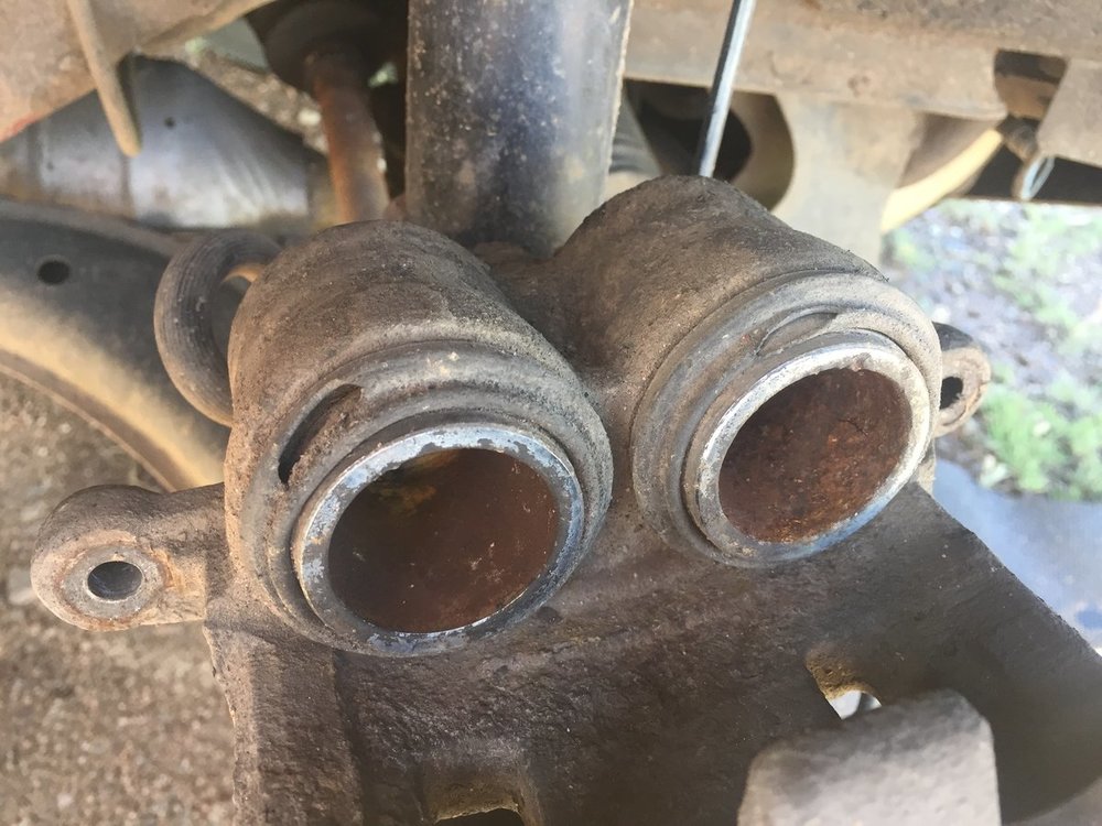

ztrain727 Posted July 8, 2019 Author Share Posted July 8, 2019 (edited) When I jacked the car up, it was immediately apparent that the rotor was rubbing from spinning the wheel a bit. I had my gf wobble the wheel while I watched underneath. The outer tie rod looked good, and I couldn’t see the inner because of the boot (can I just slide it over?), but the ball joint had a lot of play. Is it possible a ball joint could cause these symptoms? I took the caliper apart. Definitely looking a little rough. Is there any way to service the pistons other than buying a reman caliper? Edited July 8, 2019 by ztrain727 Link to comment Share on other sites More sharing options...

el_freddo Posted July 9, 2019 Share Posted July 9, 2019 You should be able to get a seal kit and install that on your current calipers. From memory there’s an O ring with a square cross-sectional shape (as in, if you cut the O ring it’s a square-ish shape rather than a round shape - clear as mud?), this may need to be fitted with a particular orientation. Do your reading/research! I’ve done my L series front calipers in a campground car park before we went bush once. It helps to have all the parts and tools on hand Cheers Bennie Link to comment Share on other sites More sharing options...

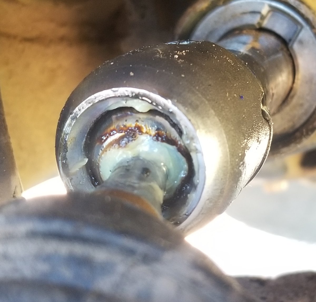

ztrain727 Posted July 9, 2019 Author Share Posted July 9, 2019 (edited) Sorry, here are new links: Was trying to film the steering linkage rotating here. That's what is clunking. Inner tie rod look worn? Seems to have fresh grease... A wheel bearing does seem logical for the rotor rubbing, shimmy, etc. No sound when hand spinning the hub, but there a slight bump bump bump I can feel through the rotor as it rotates. That feeling could be the cv axle or something else though, can't say. No real play in the hub as far as I can tell. When you say check the hub bolt, do you mean the 32MM nut? An 04 bearing needs to be pressed, correct? I don't have the tools Edited July 9, 2019 by ztrain727 Link to comment Share on other sites More sharing options...
uniberp1 Posted July 9, 2019 Share Posted July 9, 2019 Sounds like you should start pulling it apart. The vertical wobble might mean something. The side to side does not. Take off the wheel. First, pry the pads away from the disk to give a little wiggle room. Then you can see if there's bearing wobble at the hub. If not, it might be the axle, in any case the next steps are the same. Mark the cam bolt on the strut mount. Saves you an alignment maybe. I hit it with a chisel to mark it. Ink/paint always seems to rub off. Yes, the bearing will need to be pressed. Be sure to use an NTN bearing. In my experience they are better. Replace inner and outer seals. I used to have a shop do it, $90 total, but I bought a $100 press.It could be the halfshaft. You will be able to feel the bearing with it out of the hub anyhow. The shaft should not have rotational play, end to end, by itself. I use the lever clamp type ball joint remover, but check the balljoint for looseness and probably replace it anyhow. Try to AVOID BREAKING the pinchbolt. Patience, lube and possibly rilling in from the threaded end to reduce thread pressure can help. I also replace any caliper where the pads are thinner than the opposite side, which indicates dragging, to me. And new pads both side then too. Link to comment Share on other sites More sharing options...
Jadu108 Posted July 9, 2019 Share Posted July 9, 2019 So far on my car i havnt been able to accurately diagnose a bearing until the knuckle was free from the car. They can be decievingly solid until you have it free from the axle and the hub is all floppin around :\ I agree and say change the ball joints any way... in can be a PITA if you have a rustbelt car, but get it done and rule it out...... A somewhat simpler method to avoiding pressing bearings, go to the junk yard and look for a donor with new axle nuts, more times than not a new axle nut means new bearing and/or axle. Link to comment Share on other sites More sharing options...

ztrain727 Posted July 10, 2019 Author Share Posted July 10, 2019 And same hubs/bearing assembly on the 2.5 and 3.0? Just checked the tie rods again and with the boot pulled back they actually seem totally solid. I can't budge the hub either, or hear any sort of grinding/roughness coming from it when my gf spins the opposite wheel. Point taken it could be hard to tell with everything else locked in. New small tear in the front right cv axle boot (the axle was replaced a couple years ago). Seems the missing tire weight would be a very good candidate for at least part of the steering wobble. The sudden screeching sound, distinctly once per rotation, I cannot say. Even though the sound was distinctly from the front right, would it be worth jacking the back up and checking the rears for play? Link to comment Share on other sites More sharing options...

ztrain727 Posted July 11, 2019 Author Share Posted July 11, 2019 I put the wheel back on temporarily after a little caliper/rotor/rim clean up. It's as if nothing ever happened. Smooth and quite, no shimmy. Bizarre. Next I went in for a tire balance and asked them to check all the front end stuff, and they said lower ball joints need to be done, bearing were fine (for what it's worth). I checked the hub not and inner rotor with a Fluke thermal imaging camera I'm borrowing. The hub nuts/inner rotor fronts both read about 170 *F, and the rears are around 140* F after 30 mins driving, 85* ambient, no hard breaking. I can get lower ball joints OEM for just under $50. Is that the way to go? Aftermarket same difference? Link to comment Share on other sites More sharing options...
heartless Posted July 12, 2019 Share Posted July 12, 2019 those temps sound pretty normal to me. Fronts do the majority of braking under "normal" driving. Aftermarket would be fine for ball joints, just dont go the cheapest. get a good quality part from a known name. 1 Link to comment Share on other sites More sharing options...
el_freddo Posted July 12, 2019 Share Posted July 12, 2019 28 minutes ago, heartless said: those temps sound pretty normal to me. Fronts do the majority of braking under "normal" driving. Aftermarket would be fine for ball joints, just dont go the cheapest. get a good quality part from a known name. I agree with heartless. A reputable aftermarket brand works just as good as a genuine item for ball joints, tie rod ends and rack ends. Cheers Bennie 1 Link to comment Share on other sites More sharing options...
ztrain727 Posted July 12, 2019 Author Share Posted July 12, 2019 (edited) Thank you, autozone had a duralast ball joint for $28. I don’t have time to wait for something to ship at this point. Update: I went for a longer drive today and as I was coming up a hill, going about 55 she was really struggling (more than usual) and upon cresting and descending the whole car was shaking. Not super violent but a serious wobble and pulling hard to the right. No steering wheel wobble and no screeching or any obvious noise which was different from last time. I think we can rule out brakes since it happened going uphill. Cv axle? Bearing but with no excess heat? Front differential? Steering rack? Also had the drive shaft u-joint blow out a few years ago which has created a whirring sound at high speeds since. This wouldn’t explain the pulling though right? Edited July 12, 2019 by ztrain727 Link to comment Share on other sites More sharing options...
