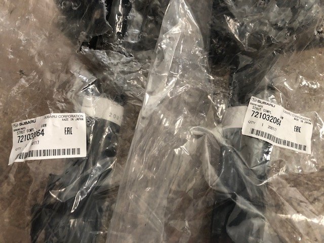

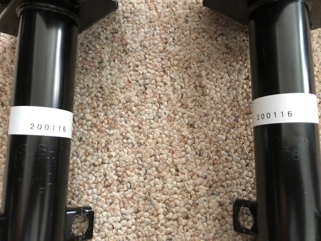

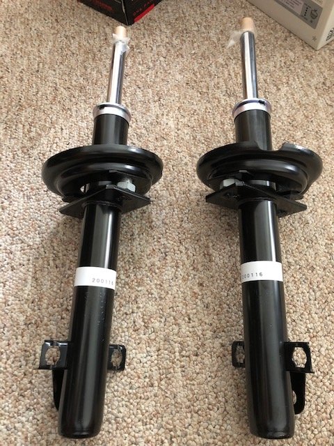

Scoby4wd Posted May 18, 2020 Share Posted May 18, 2020 Here are some pics for reference.... Link to comment Share on other sites More sharing options...
aba4430 Posted May 18, 2020 Share Posted May 18, 2020 Thanks for posting the details. I just went and ordered this part from SPFY. Hopefully it is exactly what you have. It is interesting that these are height adjustable struts with included lower spring perch. Link to comment Share on other sites More sharing options...
aba4430 Posted May 23, 2020 Share Posted May 23, 2020 (edited) OK, just received the parts from SPFY. I have ordered parts/accessories from them before for my 2017 Outback and 08 OBS (RIP) before, and my experience has been fantastic with them. They even upgraded shipping on this order for me and waived the shipping charges. I highly recommend SPFY for Subaru parts etc. However, here are the pictures of the fresh date coded matching Subaru struts (SHOWA is the manufacturer). You will note that the mounting bracket on one strut is a bit pulled out, but I can straighten that out, no issues. I am wondering whether these are rebuildable - future consideration. Edited May 23, 2020 by aba4430 1 Link to comment Share on other sites More sharing options...
