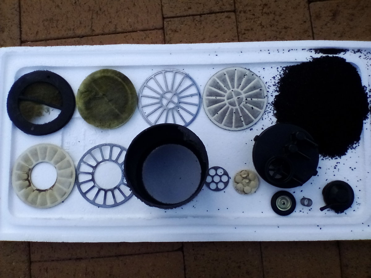

Then we have the 4 hose charcoal cannister up front - a service replace item I bet no one ever replaced, betno one ever gets it on their dealer service either
I have one that looks the same, think it came from a 99 Impreza of mine. It has one fatter pipe blanked off from factory I guess. Going to just fit it up and see.
This blanked off ( on the random spare) section is the one that goes to intake ducting on the XT after the MAF

uVQ7iZ.jpgpnPyYnYzjpoZzhAmTj
