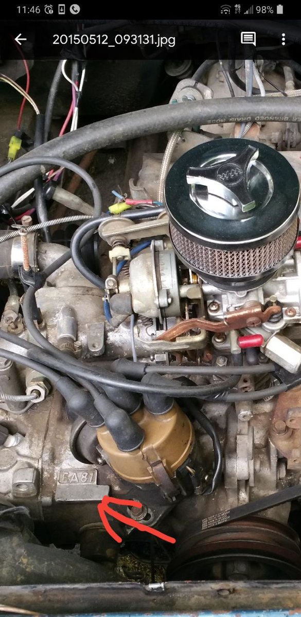

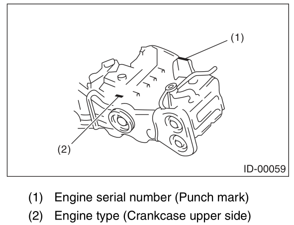

I say usually, because they can be swapped. Can be visually ID through inspection, but the easiest way to be sure when you are newer with the Subaru engines is a stamp plate on top of the engine. It will literally say "EA81" enclosed by a machined box.
Standing In front of the engine bay, on top, just to the left of center.  Seen in this picture as number "2"
and in the picture of one of my Brat's engine bat, with arrow.
All subaru engine, including current ones carry these same stamp locations.
