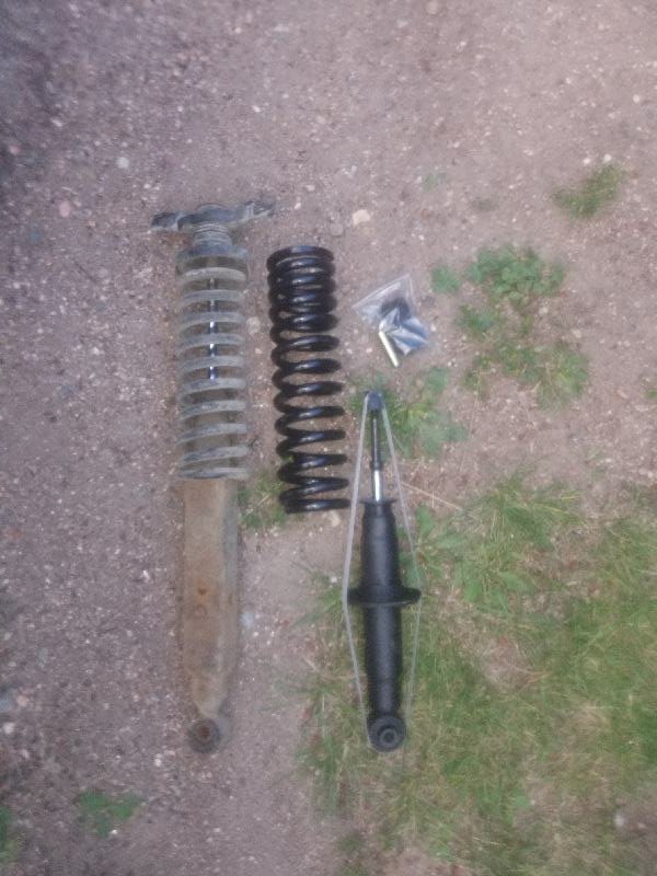

armedequation Posted August 13, 2019 Author Share Posted August 13, 2019 Started on the rears. Got rears off. Gotta put them together on my friends compression tool. Took pics but they were more than 2mb. Will redo the pics and post Link to comment Share on other sites More sharing options...
charles_thomas Posted August 13, 2019 Share Posted August 13, 2019 38 minutes ago, armedequation said: Took pics but they were more than 2mb. Will redo the pics and post I use an app for that literally just called "reduce photo size" It functions, nothing more nothing less. 1 Link to comment Share on other sites More sharing options...

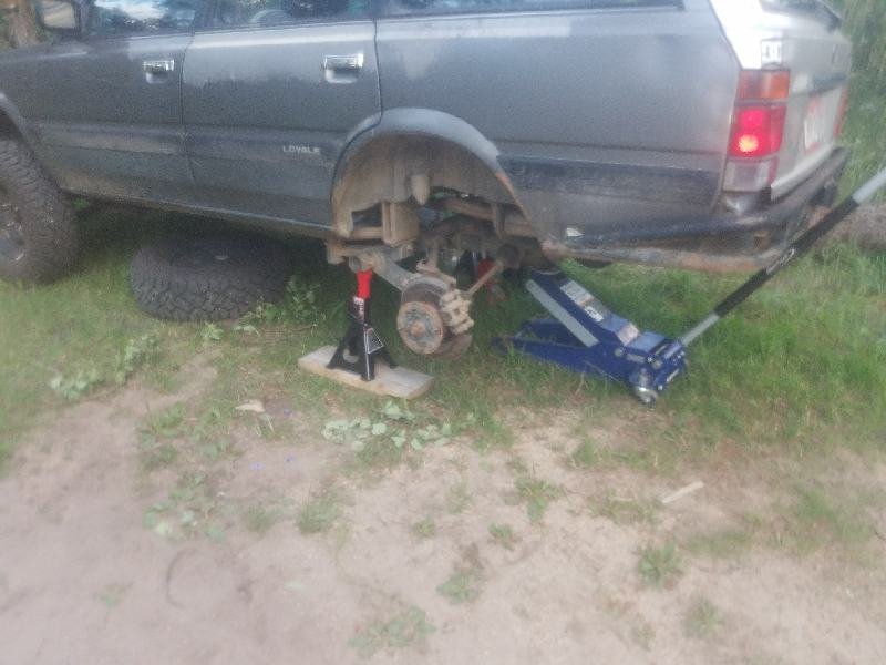

armedequation Posted August 20, 2019 Author Share Posted August 20, 2019 So update time. I got the rears installed and there was a noticeable difference in ride height. Took it for a little spin and it felt great. Came home and promptly took front off to do. We will see when i can finish them. Had a 60 hour week last week and worked over the weekend. I will say this though, im very happy with how the rears felt on my tiny drive. Link to comment Share on other sites More sharing options...
ferp420 Posted August 20, 2019 Share Posted August 20, 2019 just be aware the extra ride hight might play havok on your cv joints you might need more sub frame drop depending on your setup Link to comment Share on other sites More sharing options...

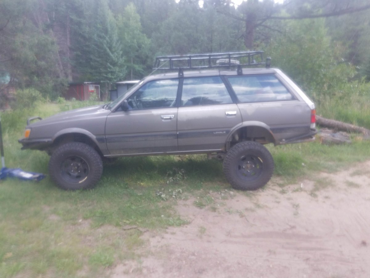

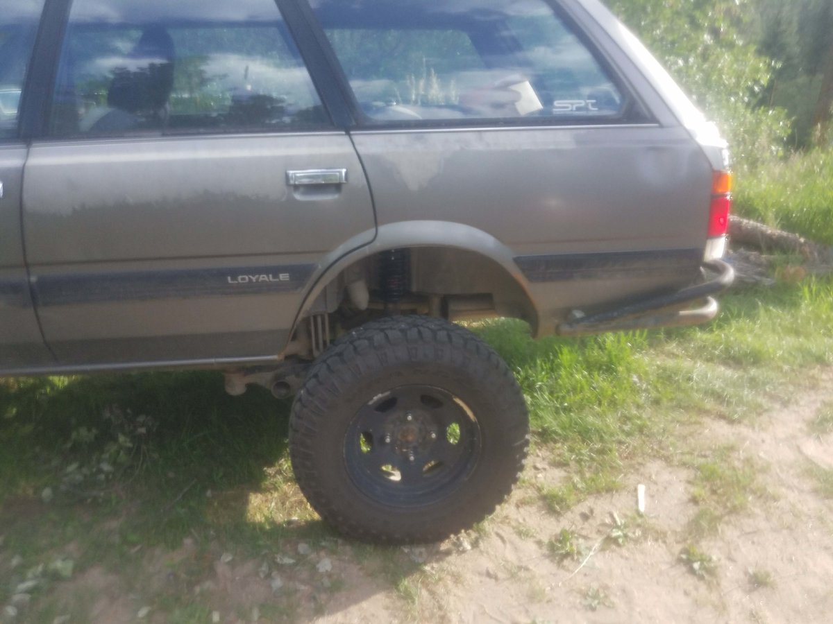

armedequation Posted August 20, 2019 Author Share Posted August 20, 2019 (edited) It kinda wierd how dramatic that last pic makes it look. It definitely an increase but not as much as the pic makes it out to be. Wont know until i get the front done and on and some real driving done I also carry 2 spare axles eith at all times Edited August 20, 2019 by armedequation Link to comment Share on other sites More sharing options...
ferp420 Posted August 21, 2019 Share Posted August 21, 2019 your rig will settle alot but still the springs should add 1.5-2"of lift so depending on your lift you might need to do some more work from the looks of it it would be easy enuff to modify your struts just by looking at the pics you posted but i dont realy know dosent matter the big lifts look great on these cars there is alway cutting a coil or 2 but only do that if a your lazy or broken Link to comment Share on other sites More sharing options...
armedequation Posted August 21, 2019 Author Share Posted August 21, 2019 It will look a lot better once i get the fronts on...a lot less rake. Looking at It from the rear, It didnt change the axle angle all that much. Hope to have fronts on in next couple of days. Already getting orders for firewood which is delaying things a bit 1 Link to comment Share on other sites More sharing options...

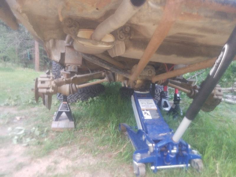

ferp420 Posted August 22, 2019 Share Posted August 22, 2019 the cvs will pull out of the cups if you have too much lift usaly with a lift like that you drop the sub frame if you add more lift you need to drop the sub frame the same amount so if yo have a 2" lift no sub frame drop 3" lift you need a 1" sub frame drop 4" lift 2" drop 5" lift 3" drop Link to comment Share on other sites More sharing options...
armedequation Posted August 22, 2019 Author Share Posted August 22, 2019 The rear diff is incorporated into the subframe and both were dropped when the lift was done. If need be i will make drop brackets but im gonna roll with it first and see what happens. With tires on the angle isnt as bad as the pic above with the tires off and the back end jacked up Link to comment Share on other sites More sharing options...
