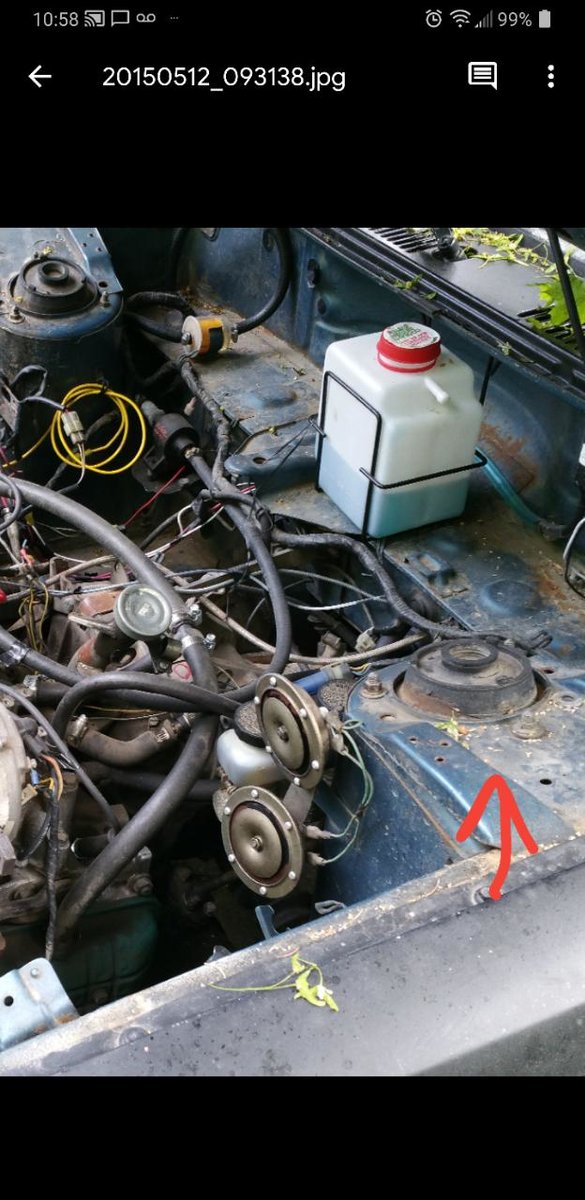

    One options, although it does require some small mods, (redrill tophat screw holes, mount brake cable at bottom differently) is to use ea82 front struts, they are much easier to find, and are *fairly* close in size, etc.
     I know you said without any mods, but it is a cheap option to consider, and a few small holes is not bad for the payout, IMO. Here is a pic, I ran them in my '78 brat that I had for quite a while. Went from ea71 style straight to ea82 struts.
