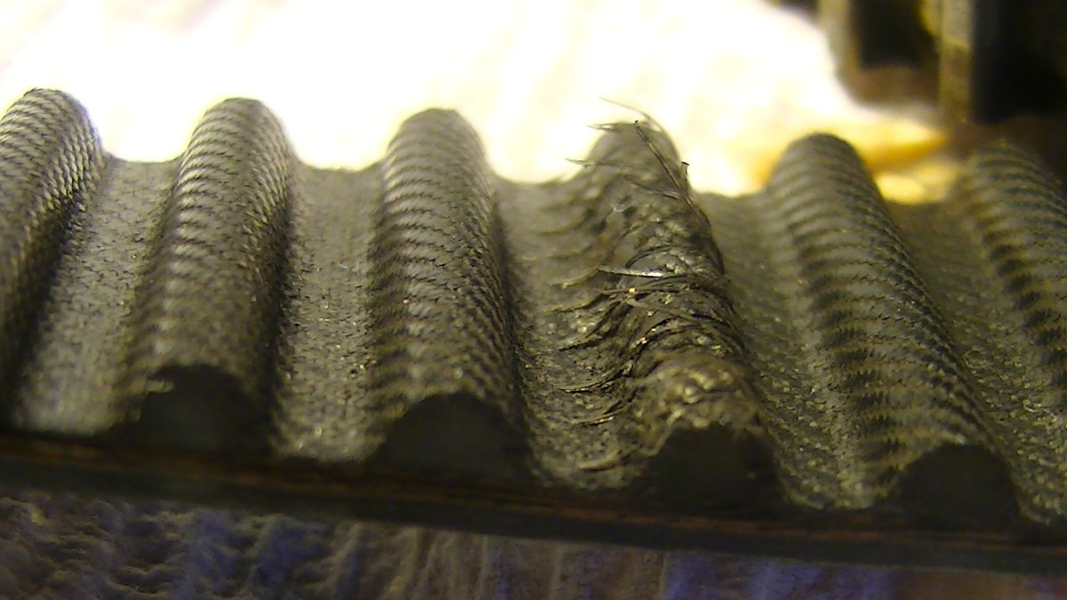

somick Posted December 8, 2019 Author Share Posted December 8, 2019 I finally bought a Mitsuboshi belt. All tensioners are rumbling a little and I going to replace them. But look what I found. Did I catch it on time? Link to comment Share on other sites More sharing options...

Rampage Posted December 9, 2019 Share Posted December 9, 2019 6 hours ago, somick said: Did I catch it on time? I think so. Lucky man. I would check all the notches in the sprockets for leftovers. Makes me wonder what the inside of the belt looks like. Link to comment Share on other sites More sharing options...
somick Posted December 9, 2019 Author Share Posted December 9, 2019 16 hours ago, Rampage said: I think so. Lucky man. I would check all the notches in the sprockets for leftovers. Makes me wonder what the inside of the belt looks like. Makes sense! I will check the sprockets tonight. However the rest of the belt looks fine. Sam Link to comment Share on other sites More sharing options...
Rampage Posted December 9, 2019 Share Posted December 9, 2019 The gates belt that I tried split from the front edge into the center of the belt, then split lengthwise about 3 inches then the rear half broke. I could see wear marks on the front edge of the first split. Like yours the rest looked fine. Never had a Dayco belt break, but the bearings in their kits only last a couple years. 1 Link to comment Share on other sites More sharing options...
