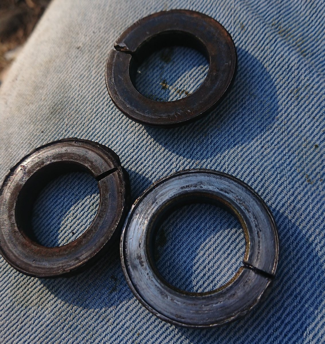

subieroo Posted August 19, 2019 Share Posted August 19, 2019 Ok, this noise has started up about 3 weeks ago. At first I thought throwout bearing but now think this is most likely wheel bearing related. As I start to go over 60kmh, especially under load a whining/howling noise builds up somewhere near the front of the car. If I engage the clutch the sound gets significantly quieter but does not go away. Turning the wheel seems to affect the noise slightly but not sure. Wheel bearings were done last year when I got the car, used sealed bearings and repacked centre of knuckle, remember cone/spring/hub looking ok. Had a CV failure not long ago and fitted a used axle in the hub, axle threads were chewed up as well... But I couldn't seem to get any north south wobble out of the wheels on all occasions, however camber was definitely being compromised. Now with this noise I pulled the hub, cone washer looked dodgy as, and hub looked like it had been worn out on the cone washer seat, probably from bad axle shaft threads not holding torque. Replaced hub with good looking cone and hub from parts car, tightened castle nut to 190Nm. Seems to have made the noise somewhat quieter but I'm still not sure. Only had one good spare cone washer and hub so could only replace one side, is getting a hub and new cone a good idea? Any other things that could cause a howl like this? Pinion wear? Would like to gather some ideas before I go about replacing wheel bearings and diffs Attached pic is cone washers, top is good one from my spare car, bottom right is the one it replaced. Bottom left is from parts car on a finger tight (!) castle nut. Link to comment Share on other sites More sharing options...

subieroo Posted August 19, 2019 Author Share Posted August 19, 2019 (edited) On 8/19/2019 at 3:16 AM, DaveT said: Also, Check the gear lube in the front diff / transmission.. Expand Oops. Checked last full service (when I got it), acceptable level. Checked again last oil change but mustn't have read it properly.. only just kissing the end of the dipstick. Added about 500ml.... Can't be sure how long exactly it's been run this low, anything I should check as well as a result of this? Won't be able to take it out until later to hear a difference. Oh, and the loose nut was just on my parts car on a hub I didn't pull for this job... Just sharing. Both of mine appeared to be tight Edited August 19, 2019 by subieroo Link to comment Share on other sites More sharing options...
