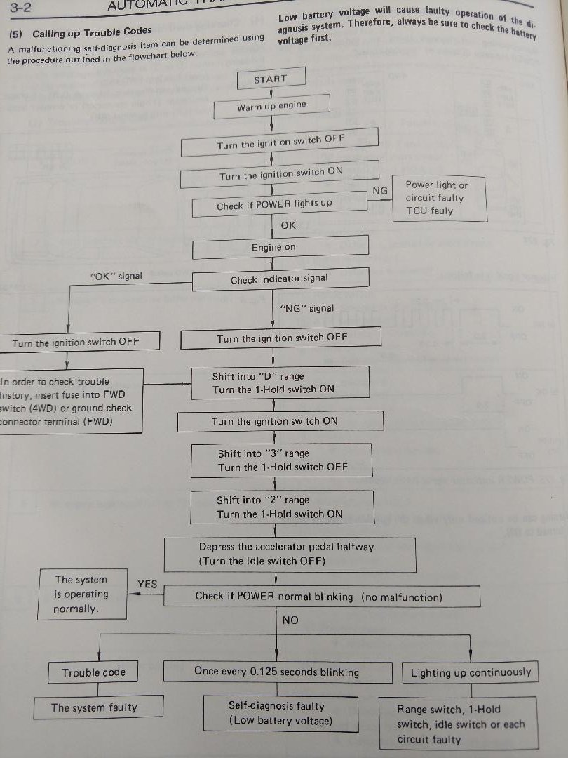

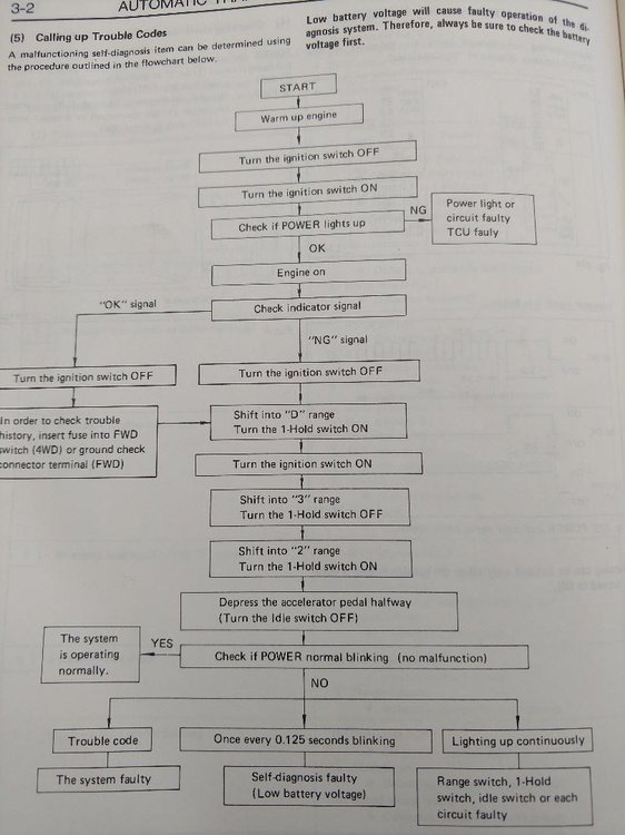

89XT6 Posted August 31, 2019 Author Share Posted August 31, 2019 Lol, I say the same thing to myself, every time I start it, "Maybe it's fine and won't do it again". It seems to be playing hide and seek with me, fix one thing, something else happens. This tells me that the issues are all related, whether electrical. mechanical or a combination of both. Yes, transmission code reading is the most bass ackwards process for this car. I found something in the FSM, but your open the door, shut the door, kill a butterfly path seems like it will work just as well. I may take the car to a transmission mechanic and have it flushed completely, and re filled. They can poke around at the solenoids and the torque converter while doing the fluid and filter change. This will be the last coin that I throw at it. I've never bottomed out, this car appears to sit low in the rear, it's FWD with the wheel wells full of 17" wheel. The suspension is tight. Busy day today, I'll try this weekend , looking at the code process and hopefully get something. Link to comment Share on other sites More sharing options...
89XT6 Posted September 1, 2019 Author Share Posted September 1, 2019 I performed the transmission code reading handshake, according to the chart above, found in the FSM. No codes, that's a good thing. So I did the obvious, checked the fluid level and noticed it was out of range when cold. I added the one quart of fluid that I had in the garage. Just to bring everything I've done back to a fresh start, I cleared the memory of the ECU, again, per the FSM... connect the read memory and test mode connectors and start the engine. Something good happened after a little warm up, RPMs climbed to close to normal. I'll let it sit for the day, pick up a few more quarts of transmission fluid and add until the cold mark is closer to the middle of the marks. A crazy shot on the dark? You tell me, but being a first generation ECU car, I would not be surprised, Happy Labor Day! Link to comment Share on other sites More sharing options...
