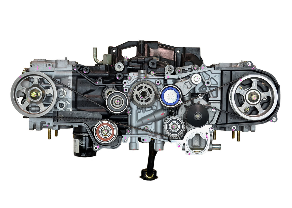

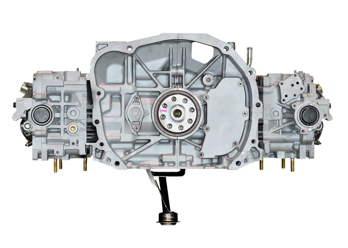

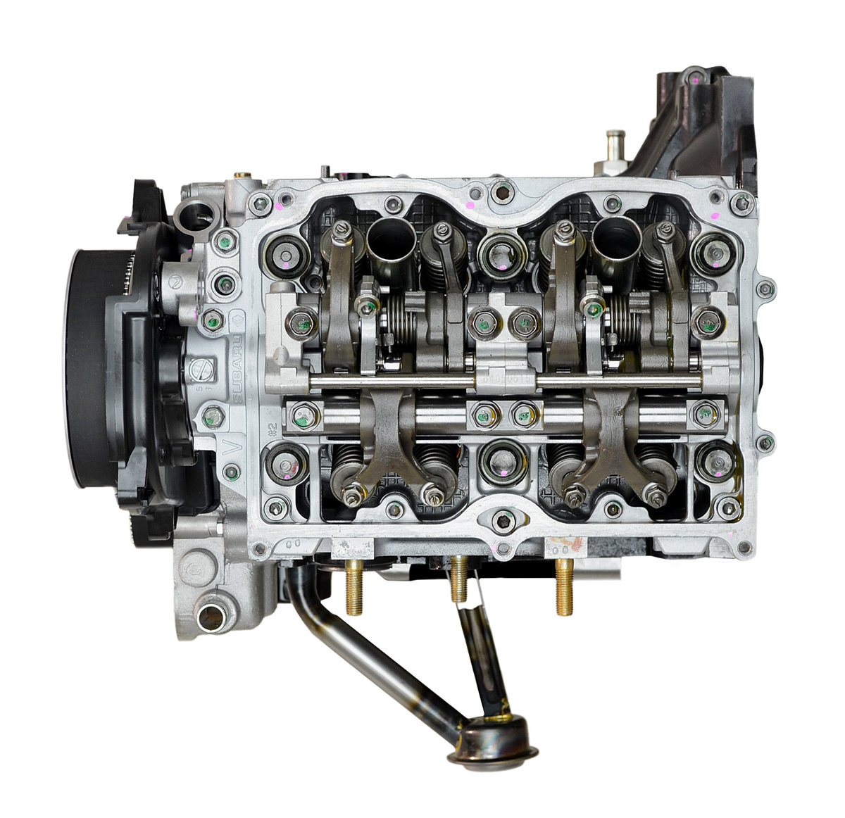

trimmike Posted September 16, 2019 Author Share Posted September 16, 2019 Since the shop I am using is paying to pull the engine and put in a new one they wont rebuild anything inclusive, not that I would really trust them to do a good job so, i am thinking about a re-manufactured engine from gearhead engines (www.gearheadengines.com). They are quoting a 2.5L remanufactured engine for $2700 after core is returned that includes the 2 way shipping. Has anyone used these guys before? based on research they sell a lot of engines and since its completely reman I dont have to do anything but buy it, supply new plugs, wires, cap, as it has new alternator, full gasket set come with (re-use valve covers and oil pan) Images of the rebuild attached Link to comment Share on other sites More sharing options...
GeneralDisorder Posted September 17, 2019 Share Posted September 17, 2019 Too much paint. Nope. GD Link to comment Share on other sites More sharing options...
