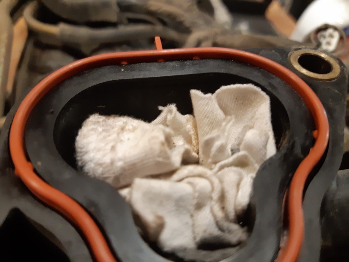

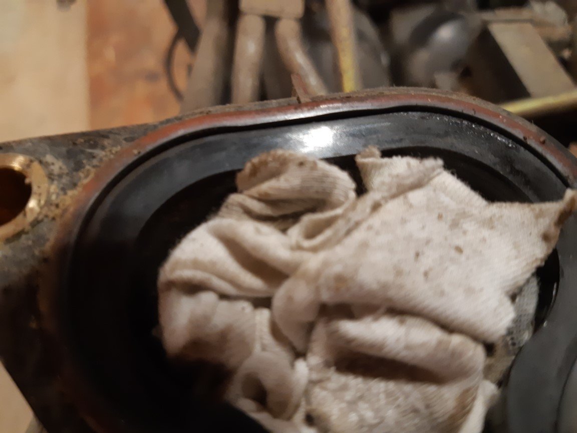

Zoltan Posted September 4, 2019 Share Posted September 4, 2019 On my 2004 Impreza EJ25, I took off the plastic intake manifold, and it has some rubber intake gaskets that go right into the intake manifold. (also needs the standard intake manifold gasket that goes on the block. These rubber gaskets that seat in the intake seems to be for 2004 only, according to Rock Auto parts list. Has anyone had any experience with this? I bought some Fel Pro gaskets but they seem to stick out from the manifold. Worries me a bit. On a side note, I called the dealer and they said it only comes with the intake. They do not sell it seperately. Weird. I wonder if I should just leave the old ones in. They seem ok. Not sure what to do. Any advise would be appreciated. Thank you. Quote Link to comment Share on other sites More sharing options...

Zoltan Posted September 4, 2019 Author Share Posted September 4, 2019 Thanks for the link. So there it is normal for the new fel pro gasket to not be flush as my picture shows? This worries me a bit. Quote Link to comment Share on other sites More sharing options...
Mike104 Posted September 6, 2019 Share Posted September 6, 2019 (edited) I just put Fel Pro intake manifold gaskets on my 04 Ford Exploder (plastic intake) and they stuck up similar. They get compressed when you tighten the manifold. The old ones were compressed after being installed for so long. Edited September 6, 2019 by Mike104 Quote Link to comment Share on other sites More sharing options...
Zoltan Posted September 6, 2019 Author Share Posted September 6, 2019 Thanks, Mike 104, Thats what I thought I just wanted a conformation. Much apprecitated !!! Quote Link to comment Share on other sites More sharing options...
