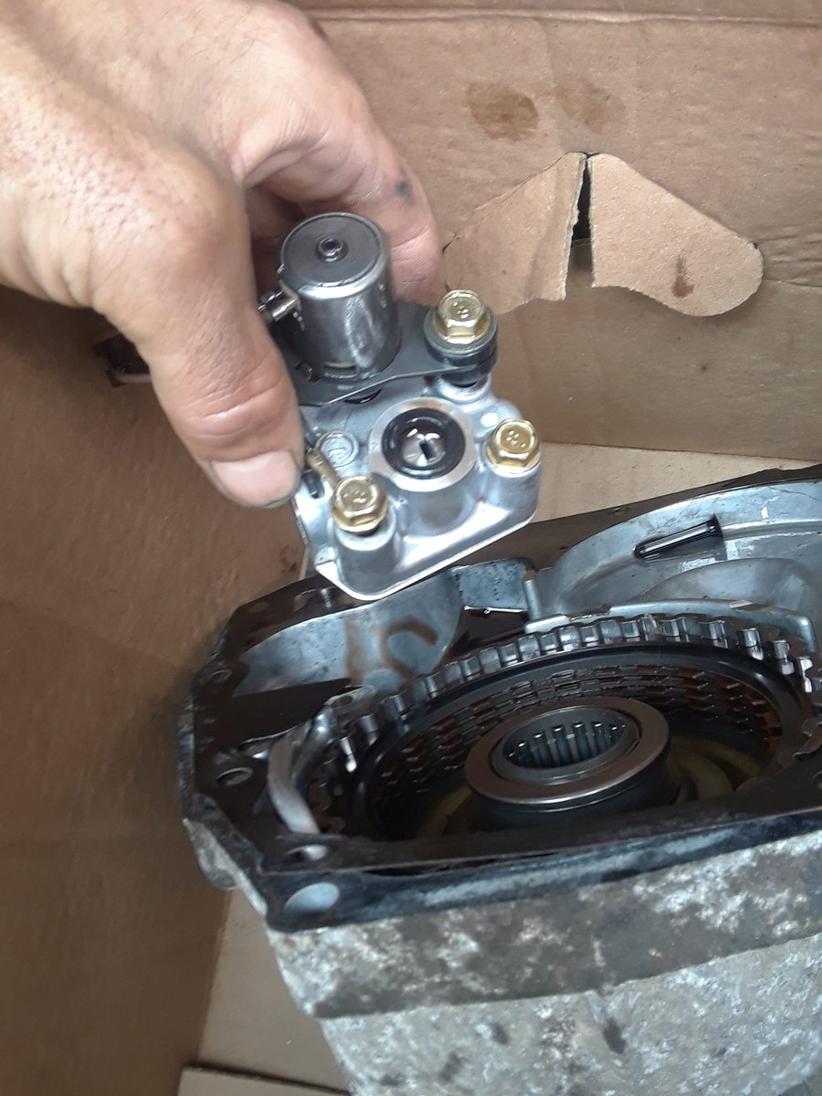

sirtokesalot Posted October 16, 2019 Author Share Posted October 16, 2019 so do i have to actually swap the valve or could i just swap the whole rear half of the case with the valve in it? im still not really sure if i need to but im guessing i should anyways while i have the transmission. ive been noticing some front wheel spin sometimes and been questioning if awd is working pr not. i think it is kind of because it wont keep spinning for long on wet grass but will spin sometimes on wet pavement and in gravel very easy. yet there is also a very noticeable difference between fwd fuse in and fwd fuse out so maby its just that im not used to the extra power and taller gears? i came from driving a 2.2 outback on 3.90 gear set to the 2.5 outback on 4.44. Link to comment Share on other sites More sharing options...
sirtokesalot Posted October 16, 2019 Author Share Posted October 16, 2019 This is the part I need to change yes? Link to comment Share on other sites More sharing options...
sirtokesalot Posted October 17, 2019 Author Share Posted October 17, 2019 and to update on this situation i decided to jack the front end up from the cross member under the engine and try to drive the car. it will push forward on just the rear wheels alone so i do think the awd is working and i did not change the rear solenoid valve. im not going to unless someone can give me a good reason too. Link to comment Share on other sites More sharing options...

CNY_Dave Posted October 23, 2019 Share Posted October 23, 2019 The way to tell is put in the FWD fuse- if that results in full lockup then it's backwards. Test for lockup by putting fronts on wet grass and rears on pavement and poke the gas. If fronts don;t just spin it's locked up. Test for FWD fuse deactivating is same but fronts should spin and you don;t move. Also on mine when itr was backwards car would lurch after turning it off as the wound-up drivetrain relaxed. Also when reversed mine when slick the fronts would spin then the rears would kick in harshly. I think a 1/2003 trans is a 2003 so no swap would be required. Link to comment Share on other sites More sharing options...
