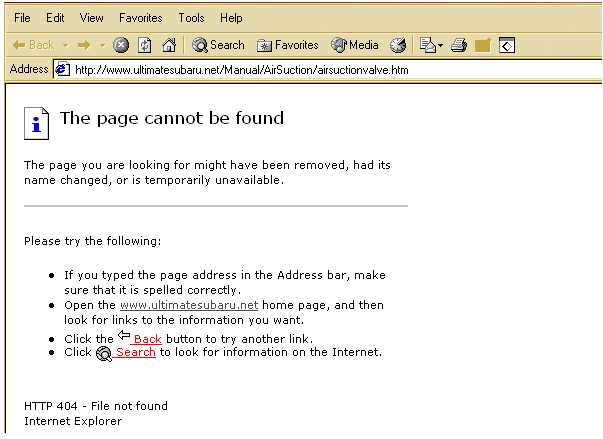

seattlelegacy Posted March 16, 2006 Share Posted March 16, 2006 I tried the search function too (I feel so grown up!) You must mean this picture: Link to comment Share on other sites More sharing options...
Skip Posted March 16, 2006 Share Posted March 16, 2006 sorry you missed it this is what I refered to Link to comment Share on other sites More sharing options...
seattlelegacy Posted March 16, 2006 Share Posted March 16, 2006 sorry you missed itthis is what I refered to That's actually great news. I have been wondering what that stupid thing is and does... I learn something new every day. Jordan Link to comment Share on other sites More sharing options...
