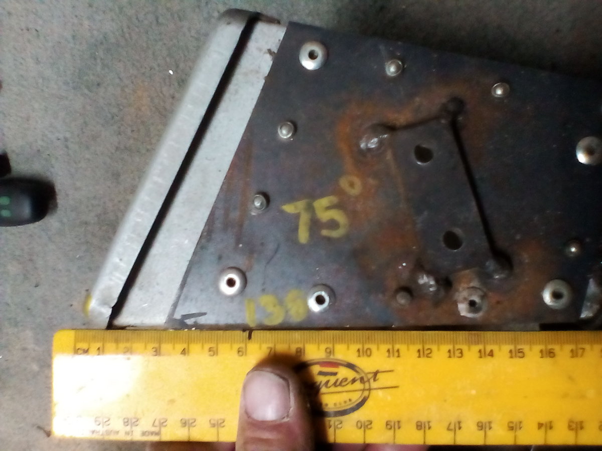

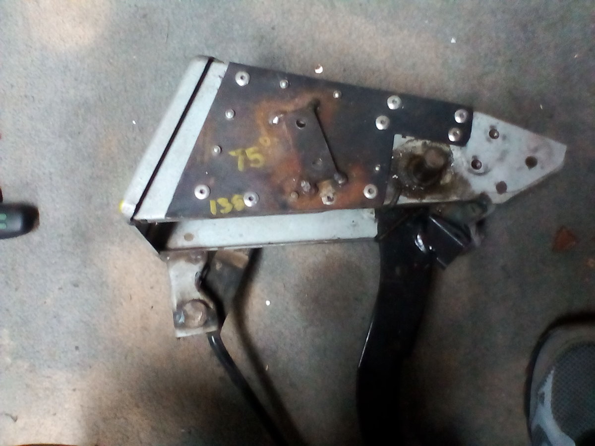

Steptoe Posted September 24, 2019 Share Posted September 24, 2019 Let me see....here is a few shots of my pedal box I adapted to take EA82 cable in my Brumby, but you get the idea of extra bracing required Link to comment Share on other sites More sharing options...
