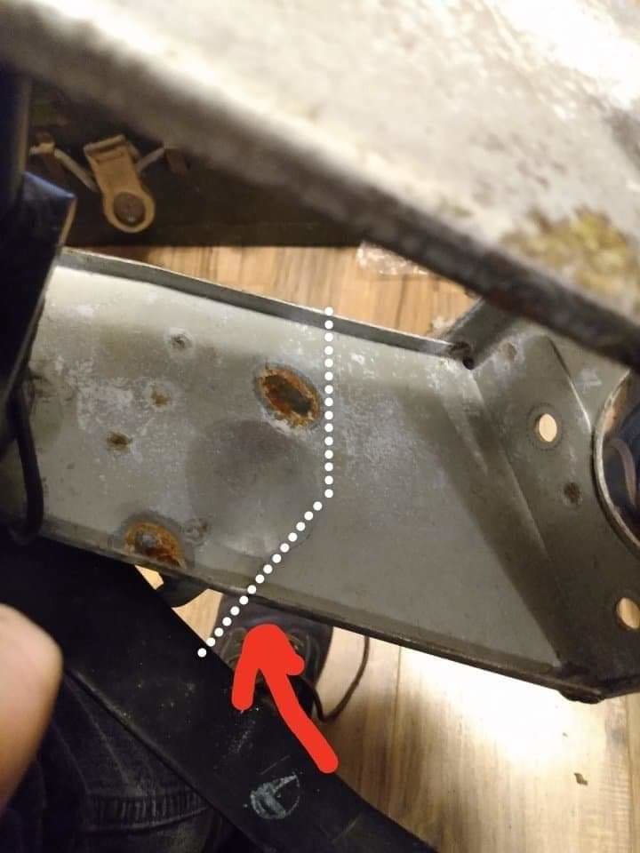

fuji4x4 Posted October 18, 2019 Author Share Posted October 18, 2019 (edited) On 10/17/2019 at 2:31 AM, rae houghton said: When you suggest it is the PP...is that because you think the PP is worn beyond recommended limits. (excuse my ignorance)? Expand I was saying PB, short for pedal box. So I apologise for confusing anyone. But yes if you push in your clutch pedal with your hand and you see it flexing or cracking the pedal box at all. That is your problem. I've found out that any play what so ever makes it nearly impossible to actuate the clutch. And as for getting down there yeah it's super tight and you have to take that "kick panel" (I just call it the under dash) and then if you end up taking the pedal box out I had to remove my gas pedal bc it wouldn't come over the steering with it on. Edited October 18, 2019 by fuji4x4 Link to comment Share on other sites More sharing options...

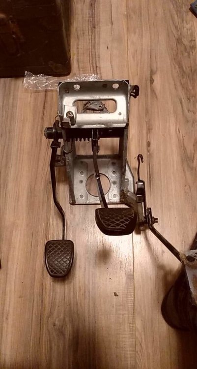

fuji4x4 Posted October 18, 2019 Author Share Posted October 18, 2019 Whole pedal box assy out: 1 Link to comment Share on other sites More sharing options...
fuji4x4 Posted October 18, 2019 Author Share Posted October 18, 2019 When pushing in clutch the left wall of the box would bend here under the pressure Link to comment Share on other sites More sharing options...
fuji4x4 Posted October 18, 2019 Author Share Posted October 18, 2019 Also would like to update anyone interested. She has been running perfectly smooth since the PB fix and the OEM cable 3 Link to comment Share on other sites More sharing options...

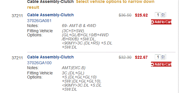

rae houghton Posted October 20, 2019 Share Posted October 20, 2019 I wonder if this is the product I need? 37211 Cable Assembly-Clutch 37026GA081 Notes: 69- AMT-B & 4WD Fitting Vehicle Options: (3C+S+SW).(GL+GL/B+GL10/B+4WD/B+RX/B) +SW.DL, <90MY>3C.(DL+RS) +S.DL +SW.DL Link to comment Share on other sites More sharing options...
