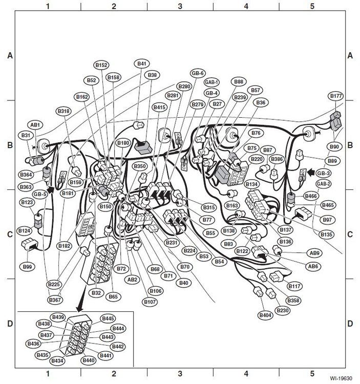

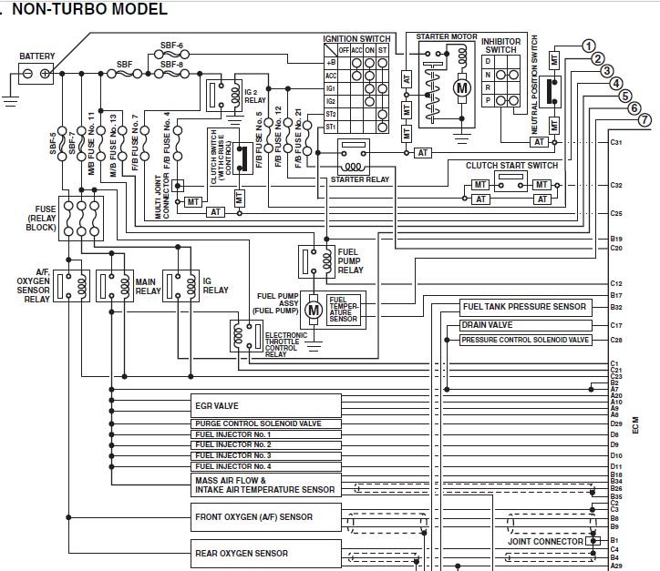

Rampage Posted October 26, 2019 Share Posted October 26, 2019 3 hours ago, milty60 said: volume air flow circuit intermittent This is one thing to check. The Main Relay contacts might be starting to burn and fail. Usually they last a very long time. See image below. The Mass Air Flow sensor, EGR valve and Injectors get their supply voltage from the Main Relay. Check the voltage and see how in compares to battery voltage. On the MAF and Injectors the wire color is Yellow with a green stripe. You might have to hook up a wire and bring it inside so you can watch the voltage as you drive. Battery is 12 volt, but with the engine running the alternator increases the voltage. Replacing the Main Relay might be easier. Link to comment Share on other sites More sharing options...

milty60 Posted October 28, 2019 Author Share Posted October 28, 2019 I looked under the hood at big fuse box - I see relays but not the main relay - also checked fuse box under dash driver side - only see fuses - where do I find the main relay? I will probably just swap it out. Assume its a Subaru dealer part. Thanks, Milty Link to comment Share on other sites More sharing options...
Rampage Posted October 28, 2019 Share Posted October 28, 2019 In the diagram below, connector B220 located at Row B Coulomb 4. Looks like a block to hold relays. Link to comment Share on other sites More sharing options...

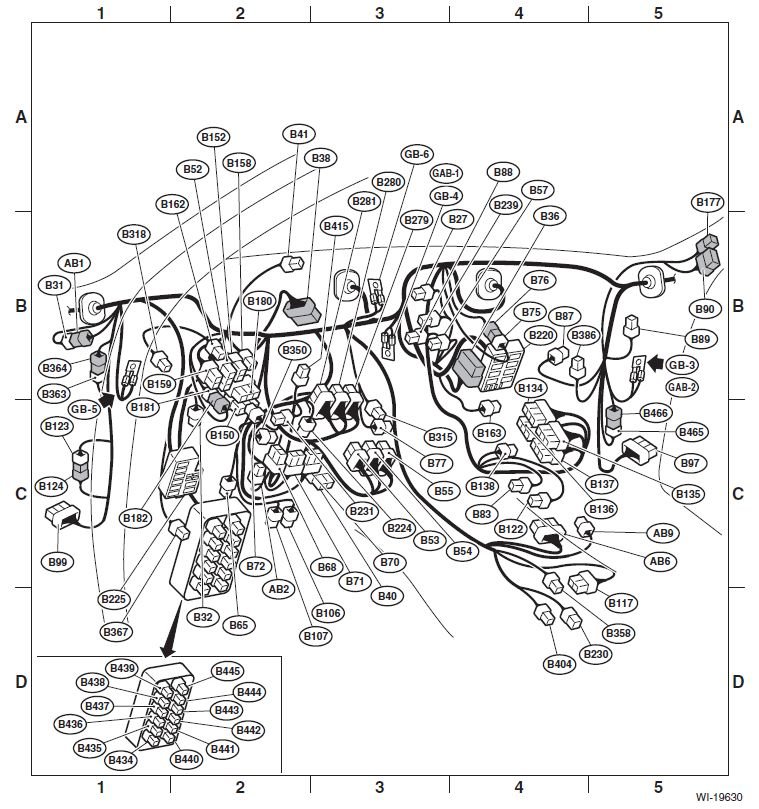

milty60 Posted October 30, 2019 Author Share Posted October 30, 2019 Still trying to determine the location of the "Main Relay" to see what condition it is in and/or replace it. I spoke to a Subaru dealer parts guy - he said Subaru is a pain in the butt when it comes to identifying any relays. Parts do not list a "Main relay" I told him what is hooked to it - maf, egr, fuel inj - he said he cannot locate it but look for the biggest relay with the biggest prongs closest to the passenger side under hood in the fuse box - the biggest one in that location has written on the lid diagram - main fan relay. So, I hate to take it to Subaru and have them charge me labor to point it out to me - unless they would do it as a courtesy to help out the parts guy. Thoughts? Thanks, Milty Link to comment Share on other sites More sharing options...
Rampage Posted October 31, 2019 Share Posted October 31, 2019 All that wiring harness in the photo is behind the dash. The holder for the relay looks like it would be behind the glovebox right below a wire that goes through the firewall. I don't know if it is mounted to the firewall or on a bracket. These two pics say the Main Relay is located in the upper righthand corner of the relay block. In the wiring harness above it shows the 4 fuses on the bottom of the block. Link to comment Share on other sites More sharing options...
