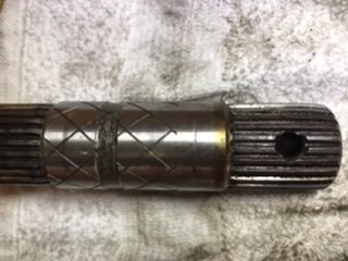

el_freddo Posted November 3, 2019 Share Posted November 3, 2019 You’d have some difficulty damaging that shaft - it’s a solid lump of hardened steel. Your money, buy away, but I think you’re wasting your money. Cheers Bennie Link to comment Share on other sites More sharing options...

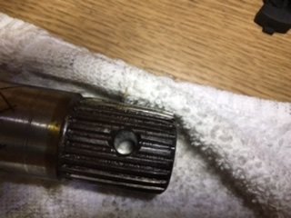

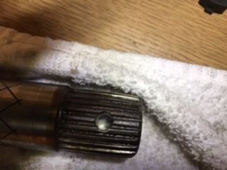

palfer Posted November 3, 2019 Author Share Posted November 3, 2019 Remove both lower control arm bushings. They are ok, no play or movement Snapped a few pics of the stub shaft. The only part that looks like a possibility is the roll pin opening. The one side is pretty beat up. When the pin is installed the play in/out seems normal. There is also play side to side. Don’t know if that’s normal or if there should be no play at all side to side. Link to comment Share on other sites More sharing options...

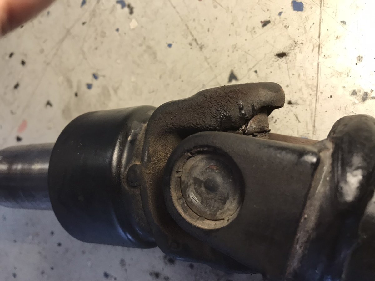

palfer Posted November 8, 2019 Author Share Posted November 8, 2019 Well as it turns There was a crack in the universal joint end cap. installed a used driveshaft from a junked car and noise is gone. Thanks to everyone for providing input along the way. 2 Link to comment Share on other sites More sharing options...
el_freddo Posted November 8, 2019 Share Posted November 8, 2019 On 11/8/2019 at 1:49 AM, palfer said: Well as it turns There was a crack in the universal joint end cap. installed a used driveshaft from a junked car and noise is gone. Thanks to everyone for providing input along the way. Expand I’ve had that happen on my L series too. I replaced the tailshaft/prop shaft with a unit from the wreckers (got lucky with that!) when interstate. Fitted it and drove 800km home from interstate Cheers Bennie Link to comment Share on other sites More sharing options...
