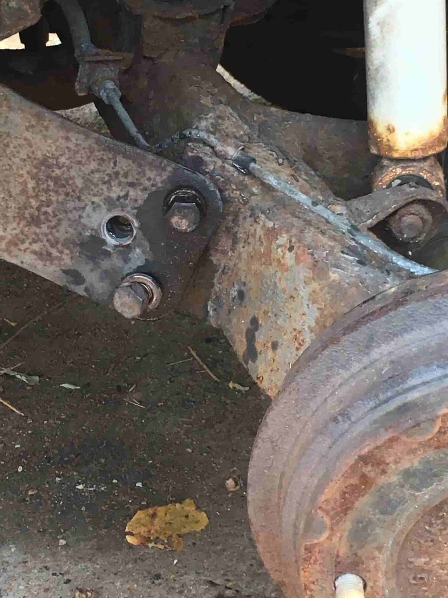

mkoch Posted November 10, 2019 Share Posted November 10, 2019 (edited) Can the rear alignment on a 2nd generation 4wd Subaru be adjusted by mere mortals? Edited November 10, 2019 by mkoch clarity Link to comment Share on other sites More sharing options...

DaveT Posted November 10, 2019 Share Posted November 10, 2019 Look at the trailing arm. Does it have 3 bolts on the side? If it does that's the adjustment point. If not then it's a version I am not familiar with. A FSM would have the information. Link to comment Share on other sites More sharing options...
mkoch Posted November 10, 2019 Author Share Posted November 10, 2019 3 hours ago, DaveT said: Look at the trailing arm. Does it have 3 bolts on the side? If it does that's the adjustment point. If not then it's a version I am not familiar with. A FSM would have the information. There are three bolts, it looks like I will have to grind the holes to change the position of the bolts. Link to comment Share on other sites More sharing options...
DaveT Posted November 10, 2019 Share Posted November 10, 2019 No, it is shocking, but if everything else is right, there is enough slop in the existing holes. I had to use a ratchet strap to pull the hub forward, the tighten the bolts. Link to comment Share on other sites More sharing options...
