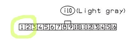

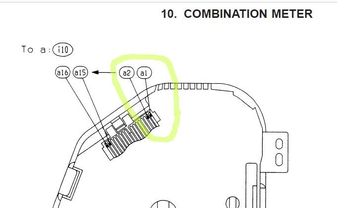

Rampage Posted November 14, 2019 Share Posted November 14, 2019 Yes, on the inside. Check this out. This would be the easiest way to stop the key chime and still keep the seatbelt warning. https://www.ultimatesubaru.org/forum/topic/26033-door-chime/ If you want to stop both then cut the wire on pin 2 of connector i10. 1 Link to comment Share on other sites More sharing options...
