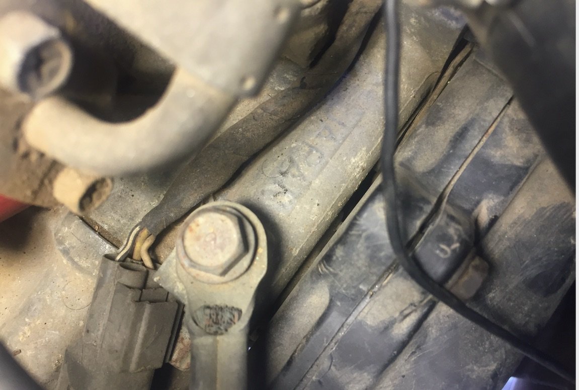

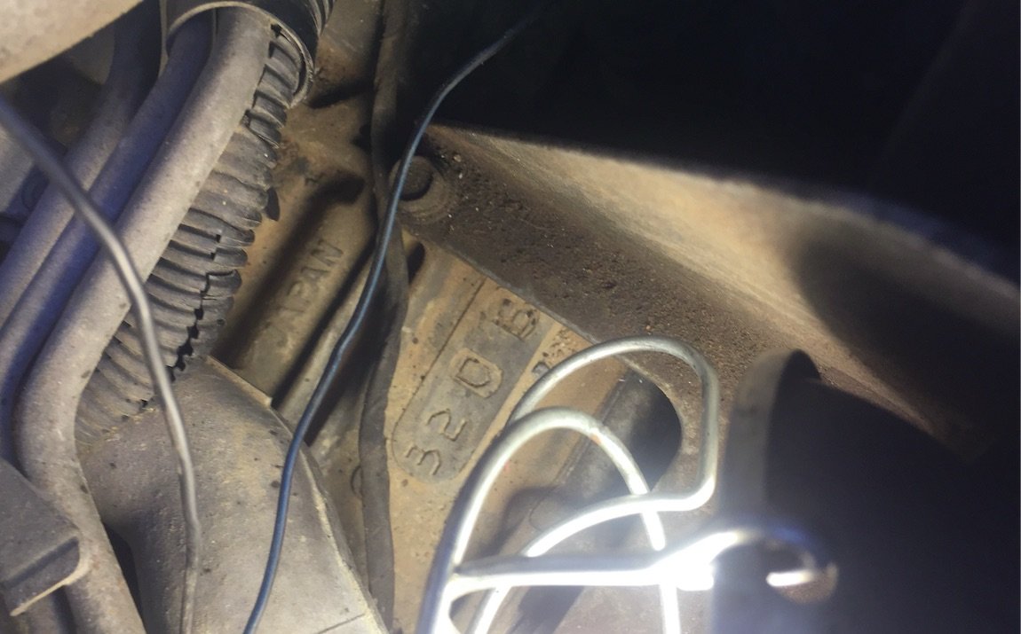

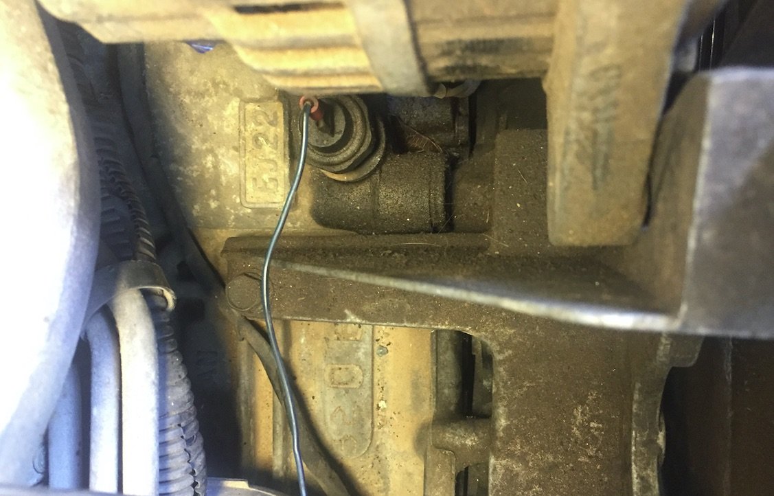

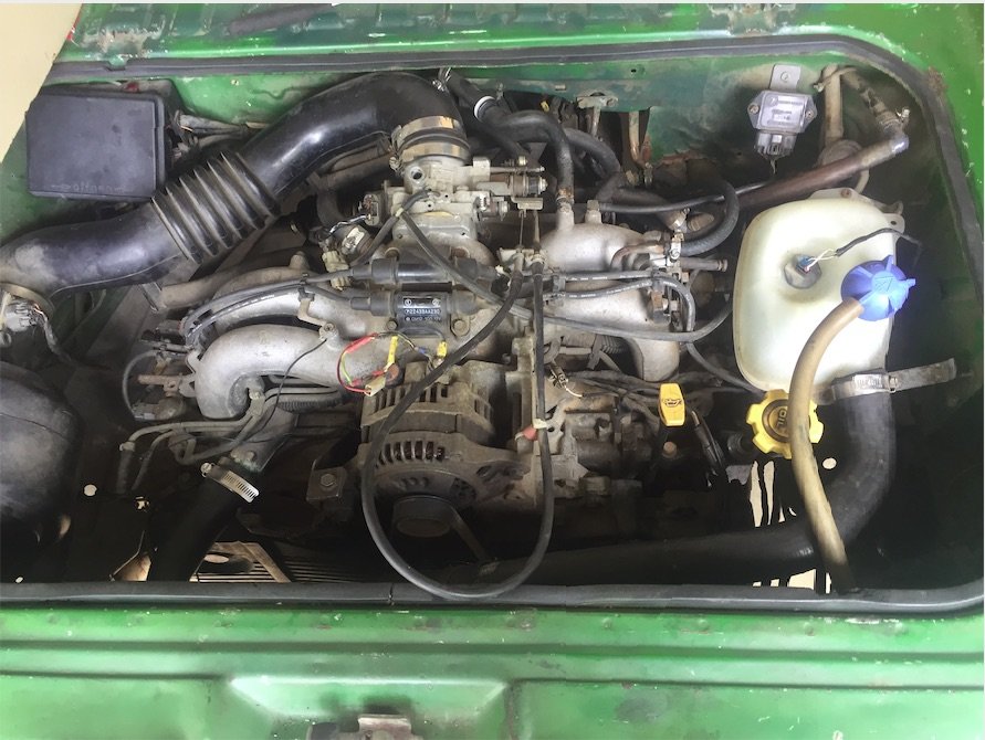

Indran Posted November 25, 2019 Share Posted November 25, 2019 (edited) Hi , hoping to get some help to identify which EJ22 engine we have. My son purchased the vanagon and as we're stumped trying to find out what goes where without knowing which engine we have. There is no VIN number on it, we just have these pics, hoping someone can please help. Thanks in advance Edited November 25, 2019 by Indran Quote Link to comment Share on other sites More sharing options...
dfoyl Posted December 5, 2019 Share Posted December 5, 2019 The VIN is engraved/stamped on the flat on the lower vertical corner of the bellhousing. Right side. Quote Link to comment Share on other sites More sharing options...
Indran Posted December 6, 2019 Author Share Posted December 6, 2019 We looked there and all over and cannot find the VIN. Based on some searching it appears that etching the VIN was not a requirement at the time, could this be one without a VIN? Any other thoughts to ID the engine? Quote Link to comment Share on other sites More sharing options...
sethjohns Posted February 15, 2020 Share Posted February 15, 2020 Looks like a 2.0 litre boxer (4 cyl. horozontily opposed) which were typically found in early vanagon conversions using the KEP or Kennedy Engineering Products conversion kits. Quote Link to comment Share on other sites More sharing options...
jf1sf5 Posted March 2, 2020 Share Posted March 2, 2020 On 2/15/2020 at 3:02 AM, sethjohns said: Looks like a 2.0 litre boxer (4 cyl. horozontily opposed) which were typically found in early vanagon conversions using the KEP or Kennedy Engineering Products conversion kits. No, it sure is a EJ22E (first pic) and probably a phase 1 Quote Link to comment Share on other sites More sharing options...
idosubaru Posted March 2, 2020 Share Posted March 2, 2020 1996-1998 EJ22 - basically all parts are the same and interchangeable. If it has dual port exhaust then it's a 1995 or earlier. There could be two different plug wires and two different timing tensioners but that doesn't matter since that's best identified by looking and matching anyway. basically everything else is the same or interchangeable. Quote Link to comment Share on other sites More sharing options...
